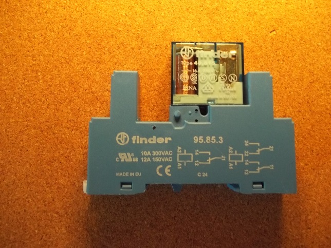

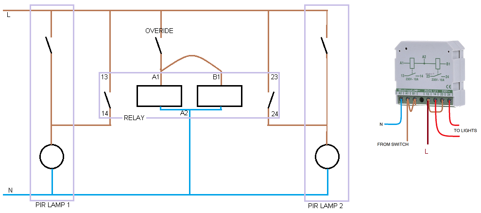

Thanks for diagram. Unfortunately that relay is a nightmare to get. Its only in Germany and shipping is twice or three times the price of the item.
It is a pair of pulse operated switches, one pulse to turn a switch on , then a second pulse will switch it off
Switching relay AC 253...207V 10A - Pulse switch RDS U1
Thanks for diagram, so A1 live A2 neutral… is B1 not used? Are you able to draw on this photo easy for me to understand? Thank you
My drawing was for the relay I suggested.
This would be better:
To prevent an active (or faulty) pir to hold the relay on when override switch is released.[/S]
EDIT: Written before i saw last few posts.

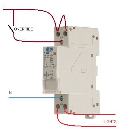

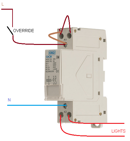

I suggest go back to Screwfix relay (contactor), Bernards enclosure and circuit in posts #20, #22 & #25.
Thanks, I looked at that Screwfix relay, it says the size of the suitable cable is a minimum of 6mm. I could do with one that works with 1.5mm - 2.5mm
Just to say I purchased the screwfix option suggested by Sunray, wired as EFLImpudence diagram. Happy to confirm working exactly as described. Thank you all that contributed to the thread, really appreciate the support.

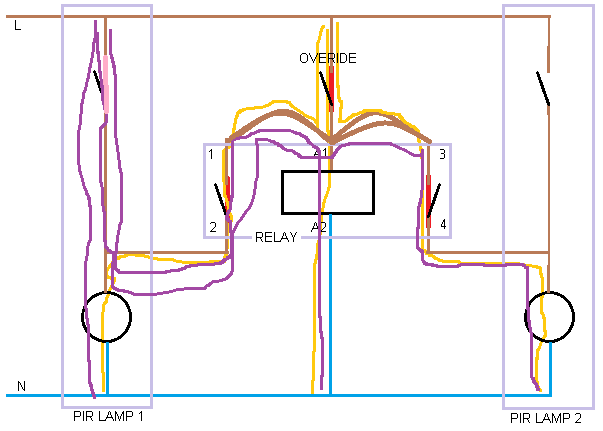

When you switch the override off, Sometimes you may find all the lights stay on if one of the PIR's is triggered. It's not a fault, just a quirk of the way it's wired.
How so ? That implies that with the relay on, a supply from one of the PIRs can hold it on - but the switch is in the supply to the relay coil so with the switch off, there's no route for that circuit.
There is when the relay is energised.

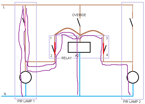

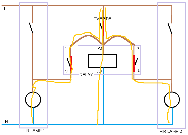

This is what has been installed
Override operated (red contact positions) provides 3 current paths in orange
Then PIR 1 triggers (Pink) providing potential additional current pathes in purple
Then override switch off leaves the 3 purple paths

So, no we're not talking about the same setup then. I'd have done it as you drew it.
I'd have preferred that but I don't know how the existing is cabled and wired, it may not be easy.
