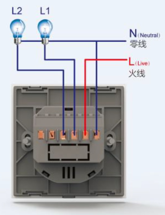

20171214_210041.jpg 20171214_210053.jpg 20171214_215544.jpg So, I'd like to swap my existing 2 gang light switch in the lounge (which operates wall lights and central light) to a wifi smart light switch that does the same.
Is there anyone on here that can advise as to whether how I think I show do this is right please?
I think if you look at the pictures that I have neutral wires that are capped at the back of the backbox. Therefore, I was thinking (but would welcome knowing if this is right), that I run a neutral cable from 'N' on the new switch back up into the collection of capped neutral wires at the back of the back box (or do all those neutral wires do different things?). I then take away the little cable that joins the 2 holes marked 'Common' on the old switch. The 2 wires which are left in the 'Common' holes on the old switch both go into 'L' on the new switch and the remaining 2 brown wires in holes marked '1 way' on the old switch go into L1 and L2 respectively.....
Thanks for any advice....
That new switch looks like a 1x2 way therefore it can't replace the existing 2x2way - being used as 2x1way. You need another switch or a different switch that can function as the existing. Also that switch will not fit into the back box

The PDF for that model number shows this...
...but it also says it is 32mm deep, so you'll need to chisel out some of the wall and set the box in deeper to fit it.

I was going by the diagram from rsgaz and the OP's picture in which it looks like there is provision for L3 and L4 as well.

Thanks guys. Old switch is 2 gang 1 way, as is new one. There is a diagram as well. I'm just struggling to understand which of the wires in the back box and old switch need to go where in the new one.
You've got 4 cables at the switch.
Two are the lighting circuit ones, in and out, so they have to remain connected or a bunch of your lights will stop working.
Two are the cables with switched lives going to the two lights.
The biggest problem you have (after the physical space needed) is that you only have 4 ports in the push-in connector for the neutrals, so you won't be able to just link it to the N terminal of the switch.
