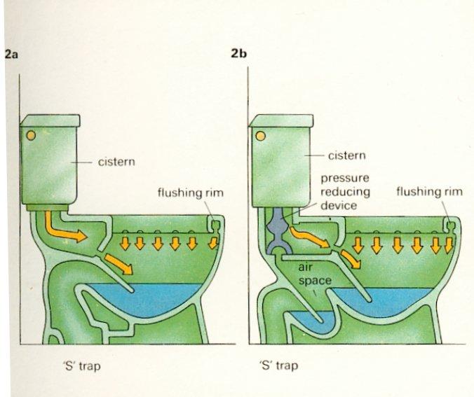

there are at least two designs of syphon. The ones I used have a part wide/part narrow trap, with an ordinary cistern:pan connection, some others have an extra pipe going into the trap to initiate the suck.

Is it a double trap syphonic, or a single trap, or a washdown? These are all well illustrated in the previous post.
If it's a double trap, check that the air extractor is fitted properly with its washer and do not modify it. If it's a single trap syphonic, I would think a flapper valve assembly would be OK. Syphonics are all out of fashion nowadays, so it may in fact be a washdown anyway.

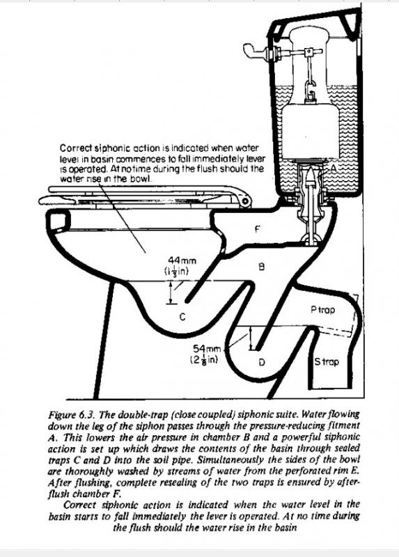

can not see the single trap on them 3 pics ?,,, A wash down,,,, B double,,,, large black double
only come across double syponic WC my self ??? there is an article by royal Dalton regarding single syponic WC but cant see how it could be called syponic with one trap,,,,, another point on doitalls pics it clearly states the water should not rise in the basin,, every single one i have seen the water rises then vacs out the contents,,,, when ive been to them if the water will not rise then thay fail to clear the basin even one sheet of paper,,, when there reassembled the water rises and will clear a full toilet roll ,,,,,,, which contradicts the article
