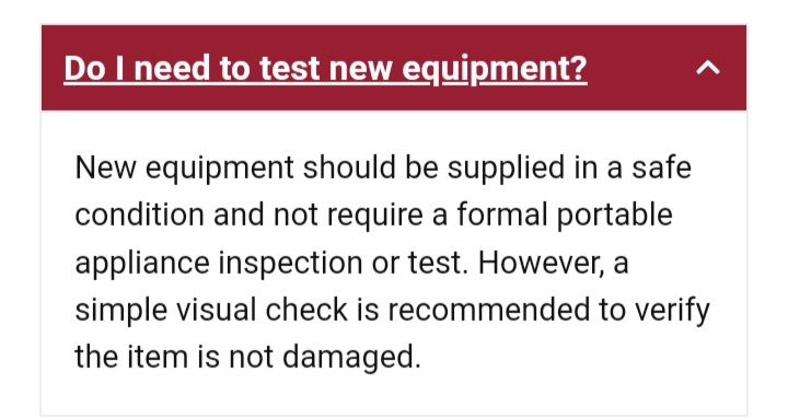

...and as no one has mentioned it so far:
