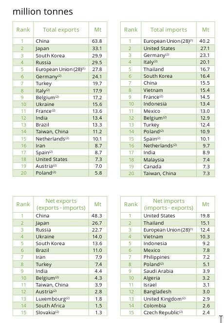

Steel isn't that simple. Pig iron isn't either. On one hand people seem to think Trump comments are straight forwards and on the other that Chinese steel is inferior. Steel is a commodity and countries have a demand and a capability for producing it. Not enough import. This is from 2019
This shows production figures for the same year
