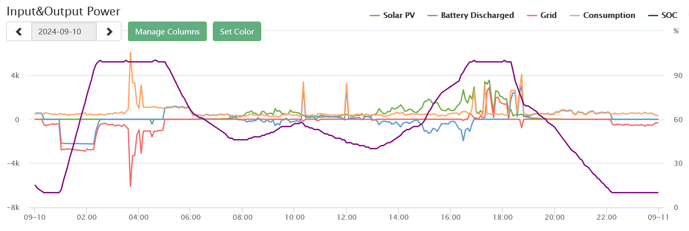

I have a small battery 3.2 kWh, solar panels, and a split tariff. In hind sight the battery and split tariff are it seems paying for themselves, but due to lack of export payment, the solar panels are not really doing that well.

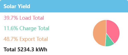

Been in around one year now, so solar has produced 5000 kWh, I have used about the same, but exported 2500 kWh and imported 3000 kWh in rounded figures, from software 1726308668428.png.

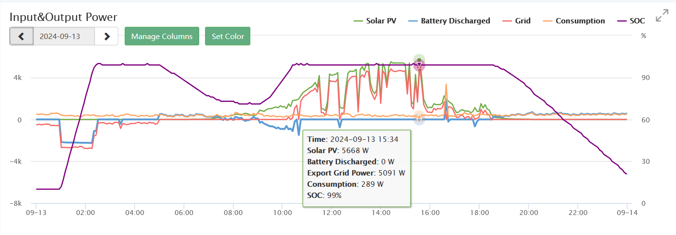

The smart meter was not fitted until January and did not get duel tariff until February, it was noted that solar in Winter would not recharge the battery some days, so all solar produced in winter is in the main used, but money wise it is the recharging of battery over night which saves the most money, this 1726309071975.pngfrom yesterday is typical, but this 1726309174085.png where battery runs out before the low rate returns is getting more frequent as Winter gets closer, the options on my system is 1 to 4 batteries each battery being 3.2 kWh and the batteries are not cheap, well over £1000 for the battery.

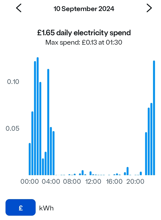

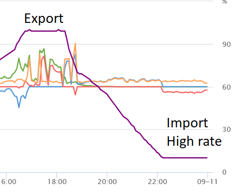

Our electric bill dropped when panels were fitted, and again when duel tariff was started, so cut the bill by half, but now a large chunk of the bill is the standing charge, and the smart meter and solar software is good at showing how much we use each day, but useless in showing how much at 8.95p per kWh and how much at 31.31p per kWh so it would seem second battery would help reduce export and import at high rate 1726310848841.png but not sure if it would save enough to pay for its self? So the 10th when that graph was produced looking on smart meter app, used 8.22 kWh most before 5 am, cost was £1.06 or £1.65 including standing charge. 1726311210972.png so looking at that day, a second battery 32½p i.e. cost if all imported was at 8.95p per kWh.

As it is we are watching electric use far too much, we can afford the electric, so we could just carry on as we are, I hope to get export sorted, as @DetlefSchmitz says, the solar panel installers are now helping us get it sorted. So we will have a three tier tariff, off peak, export, and peak, so using power when the sun shines is still costing us 15p in lost revenue.
So this means the battery being charged at 8.95p and so allowing export at 15p is also adding to the pot, good point missed that, so extra 19p per day, so around 50p per day, or £1,277 over 7 years. But the main point, is I would not need to watch when I use power, basic all power other than a shower, will be either off peak or solar so no watching of the smart meter display.
