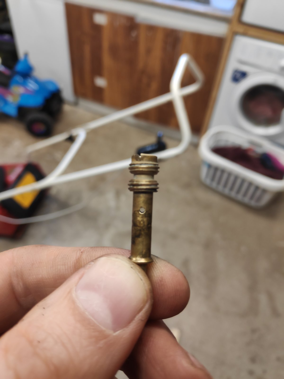

Yep, that's the emulsion tube, main jet below it.
John :)
Grand - main jet through the bore, 4 cross bore holes through the emulsion tube (learned something there!) and the main jet at are all visibly clear or were poked with fuse wire.
