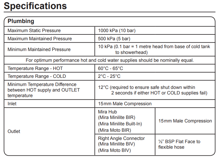

It's a safety feature. If the cold supply goes away, any hot is shut off completely to avoid scalding or worse.
Without that, hot water at whatever temperature it was supplied at would be provided from it, which could be a very high and dangerous temperature.
If you were expecting to just supply hot to the mixer then forget it - not going to work.
It's probably a total bust anyway, as an instant heater won't be able to provide water that's hot enough to mix with cold to give a suitable shower temperature.
See example specifications below - hot must be 12C more than the outlet temperature and suggested at 60C+, which isn't going to happen unless the flow from the hot heater is barely a trickle.
Other valves may vary, but these specs are pretty common.
Are you not perhaps being a bit pessimistic? Desirable shower temps are said to be 35°-40° (and definitely not much above 40°), so the hot supply temp would not necessarily have to be much more than about 47° or so - and, furthermore ....
... which isn't going to happen unless the flow from the hot heater is barely a trickle.
I wonder how small this 'bare trickle' would actually be with a 10 kW heater producing water at about 47°. A 3 kW over-sink heater certainly provides far more than 'a trickle' of water at a temp at least as high as that. Don't forget that I'm not looking for something that would be desirable as a long-term thing but, merely a shower which 'works well enough to be 'usable' as a definitely temporary measure.
You've done a lot better than I have - since I've more-or-less failed to find particularly useful technical specs for any mixer valves!
What I have noticed that Redring do a range of "Powerstream" water heaters (available as 9.5, 10.8 and 12 kW variants) which they suggest are suitable for use with a manual (not thermostatic) shower mixer - one of which they also supply. I suspecty you may well say that you don't regard a manual mixer as 'safe', but the manufacturer presumably must think they are 'safe enough' to be selling them?
