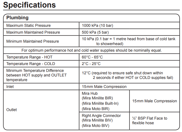

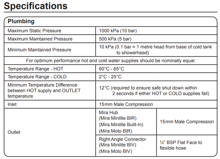

The only issues I can really see relate to the achievable flow and temp. With thermostatic mixers such as the one whose spec was posted by flameport, the requirement for outlet temp to be at least 12 below input tempo means that some mixing with cold water will be required - whereas, in contrast, with an electric shower, the heater water is not diluted by addition of any cold water. I would therefore expect that the temp achieved for a given flow rate would (or the flow rate for a given temp) would be a bit lower with the water heater and thermostatic mixer than with an electric shower of the same electrical power - but how much lower' remains to be seen!
With a water heater and a 'manual' shower mixer, I would expect the performance to be similar/same to that of an electric shower of the same electrical power (if the 'cold tap' of the mixer were turned completely off).
Kind Regards, John
It's a safety feature. If the cold supply goes away, any hot is shut off completely to avoid scalding or worse.
Without that, hot water at whatever temperature it was supplied at would be provided from it, which could be a very high and dangerous temperature.
If you were expecting to just supply hot to the mixer then forget it - not going to work.
It's probably a total bust anyway, as an instant heater won't be able to provide water that's hot enough to mix with cold to give a suitable shower temperature.
See example specifications below - hot must be 12C more than the outlet temperature and suggested at 60C+, which isn't going to happen unless the flow from the hot heater is barely a trickle.
Other valves may vary, but these specs are pretty common.
