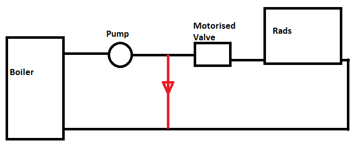

No I'm describing a bypass device shown here in red, the only purpose of which is to provide a route such that with the motorised valve closed the pump can continue to circulate water through the boiler until the latent heat is cooled sufficiently. It requires a pressure relieve type function, ideally a pressure differential function typically set to something in the order of 200 to500mbar otherwise the the bypass would be constantly open when the pump runs. A check valve is sometimes used.
As I understand it, that's very different from a 'check valve' installed to prevent backflow. An ideal check valve would fully open when there was any pressure differential (no matter how small) across it in the 'forward direction', and certainly would be required (in order to prevent backflow) to fully close if there were any pressure differential in the ';reverse direction'.
Indeed - that's what I was talking about, and common in heating systems.
It requires a pressure relieve type function, ideally a pressure differential function typically set to something in the order of 200 to500mbar otherwise the the bypass would be constantly open when the pump runs. ....
That's what I said - which is why they are commonly known as 'pressure relief valves - they open, and allow flow, if the pressure differential across them rises to a certain level.

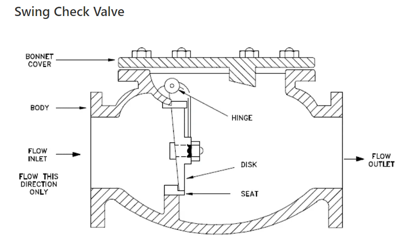

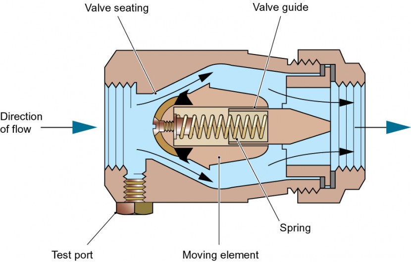

The style of check valve I've encountered are of this style:
which by pure coincidence is from the site you linked to previously.

I'm finding it more difficult to identify any difference between the names check and non return valves.
The style of check valve I've encountered are of this style: ,image. ... which by pure coincidence is from the site you linked to previously.
Yep, same here - and it is one of that type for which I found the spec which indicted an opening pressure of 0.013 bar.
