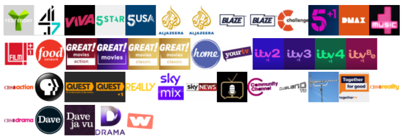

View attachment 350223 There is a massive difference in the price between Freesat and Free to Air. At one point you needed a card for the Freesat, glad that is no longer the case.
Seems I am out of date, also
Note the bit about EPG provider, also these View attachment 350227 it seems are not considered as freeview channels, so are not available from my local transmitter, so for me only option is satellite.

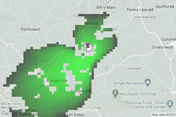

Your local Freeview transmitter is a small relay. It fills because there's a shadow from some geographical feature (hills, valleys etc) that blocks the signal from the main transmitter. Many of these fill-in transmitters carry a reduced service. The channels you get on Freeview Lite are the core of the Freeview service. When they say that Freeview covers something like 98.5% of the UK population, then it's with the Lite service. Some of these Lite relay transmitters cater for just a few hundred homes. That's a heck of a commitment when you think about it.
The channels you listed above are all Freeview channels, but you'd need to be in the signal zone from a main transmitter or a full-service relay to get those additional channels.
It says 1000 homes, Llanfair Caereinion where I live has a population of 1,810 (2011) so it likely would serve far more if it transmitted something worth receiving.
View attachment 350284 It says 1000 homes, Llanfair Caereinion where I live has a population of 1,810 (2011) so it likely would serve far more if it transmitted something worth receiving.
I think you might be misinterpreting the data. They're not counting people or people watching. They're counting homes (houses, flats, etc) within the signal reach of the transmitter.
The data is quite old, and it's likely more houses have been built since. That's the most practical way that the 'homes served' number would increase. In other words, 'what's on' isn't going to make more homes appear. The homes are either within the transmitter's range or they're not. 'What's on' won't change that.

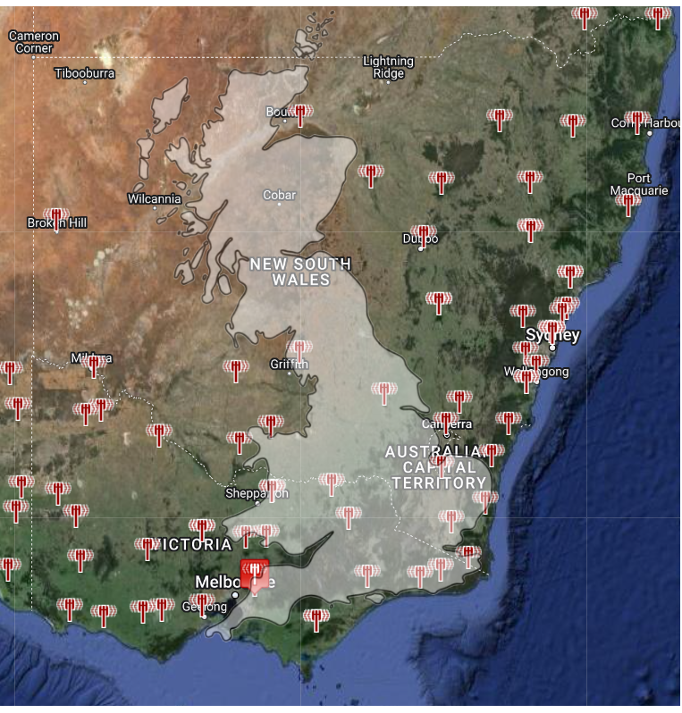

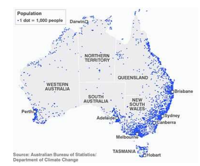

What you're perhaps overlooking is the difference in geography and in population distribution between Australia and the UK.
Australia has something like 27 million people mostly living in the coastal region of a continent.
The UK has almost 3 times as many people, and they all live in a parcel of land about a quarter of the size of NSW.
By the way, those red stick pin things, those are some of Australia's terrestrial TV masts.

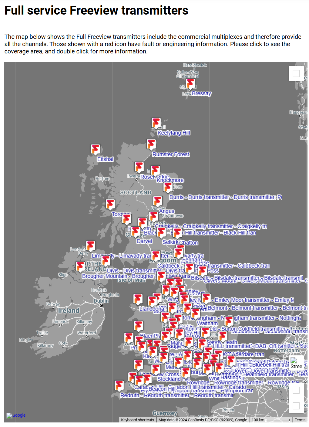

The UK map of just out main transmitters (not including the small 'fill-in' transmitters looks something like this.
In order to have them this close together, no two locally adjacent transmitters can share any transmission frequency with its neighbours. In addition, there's all the relay stations required to fill the gaps where the geography of the land creates dead spots.
In total, the UK has over 1,000 TV transmitters. Now, the relay stations use a different polarisation. It's vertical. This doesn't make their transmissions invisible to horizontally polarised aerials. It simply reduces the apparent strength that an oppositely polarised aerial 'sees'. Arranging the frequencies and polarisations so that there's no cancellation or other interference is a heck of a planning task.

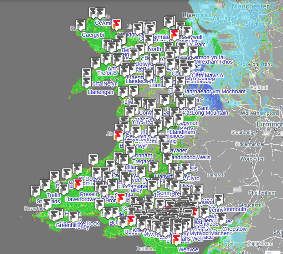

Here's an idea of the density of the Freeview Lite transmitters because of the mountainous Welsh geography.
Some of these are little more than a couple of miles apart (3km). They all need to have their frequencies arranged so that someone in a fringe area doesn't lose their signal. Can you imagine how much of a task that is to plan? Now think how much more complicated it would be to throw in a couple of extra muxes.
Australia and the UK are quite different, each with their own challenges and solutions. For example, in the UK we haven't used VHF for TV since the end of the 1960s. Australia has been populated for tens of thousands of years. Britain has been populated for over half a million years. In that time, people moved inland to the hilly areas and spread throughout the British Isles. Australia's main population surge came with colonialisation during the 18th and 19th centuries. Australia has alpine regions (and ski resorts) in NSW, but these regions don't support much in the way of agriculture, and so they're not populated in the same way as the hilly areas of the UK.
Initially, I was attempting to compare the area England (130,279 km²) with Victoria (227,444 km²) but the entire UK is 243,610 km²,
only slightly larger than Victoria.
Your comparative maps show this quite clearly.
The same technical problems exist in Australia, of course !

As both Lucid and I have tried to explain to you, it is not a matter of UHF frequency bandwidth, without clashing with other transmitters.

And after all that, Australia still doesn't have the sheer density of digital TV transmitters on the ground that the UK does, so the problem of juggling all the UHF frequencies isn't the same either.
Add to that, Oz uses a bigger UHF range. You have 42 individual channels between RF Ch28 and 69, plus has an additional 14 channels in the VHF band. That gives your country a total of 56 RF channels to juggle with versus the UK's 28. Do you get it now? You have double the number of channels to play with, so of course you can include more stations. If we had 56 RF channel slots to play with then no doubt we'd be able to include a bigger selection for those receiving from relays. But we don't, and so the UK does a sterling job with the resources on hand.
Ericmark isn't 'left out in the cold' as you put it. He has the core / the essential / the full PSB package on Freeview. What he's lacking is the additional range of channels that are not part of the PSB bouquet. That's just a fact of geography.
