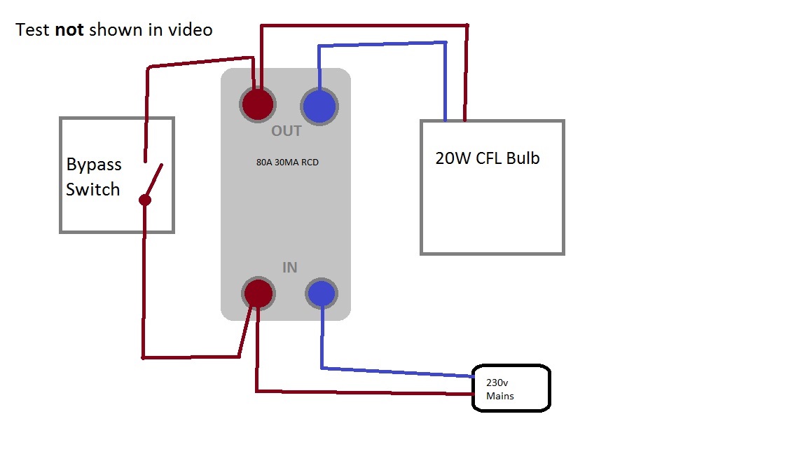

Originally (not shown in the video) I had the RCD wired like below:
But as has already been said the bypass switch did not divert enough current away from the RCD to trip it as the impedance through the RCD must have been a significantly lower than the "Bypass Switch".
The problem is that the light is staying on then ?
Maybe the pole of the RCD you are using is staying closed? The obvious answer. Can you check continuity.
As said above, the bypass switch did not let enough current bypass the line conductor in the RCD, and so it did not trip and the light stayed on of course.

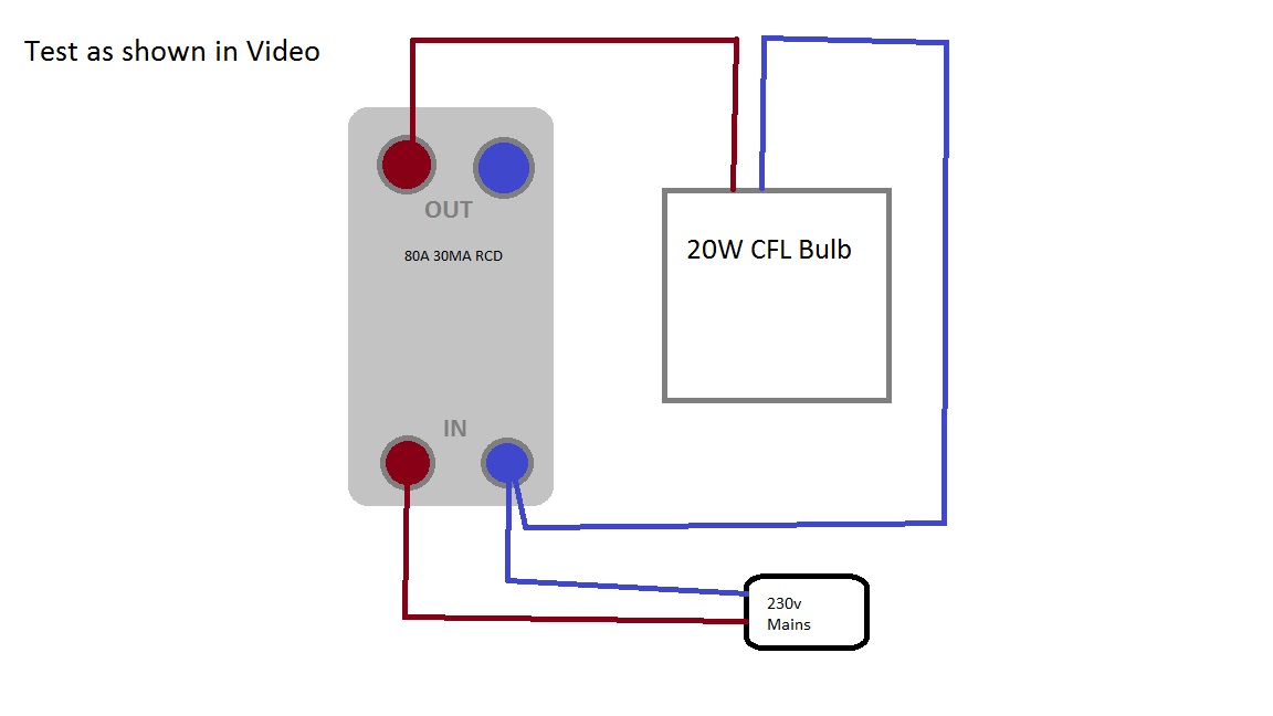

BTW; To trip the RCD for the video, I simply used the arrangement below:
... As said above, the bypass switch did not let enough current bypass the line conductor in the RCD, and so it did not trip and the light stayed on of course. .... BTW; To trip the RCD for the video, I simply used the arrangement below:
The only difference between your two arrangements is that in the first case (with 'bypass switch') the load current went through the N side of the RCD but not the L side, whereas in the second case the (same) load current went through the L side of the RCD but not through the N side. However, the current imbalance should be the same in the two cases, so I don't really understand why one arrangement tripped the RCD bit the other didn't.
Kind Regards, John
