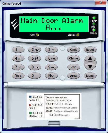

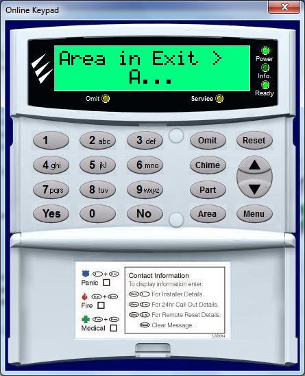

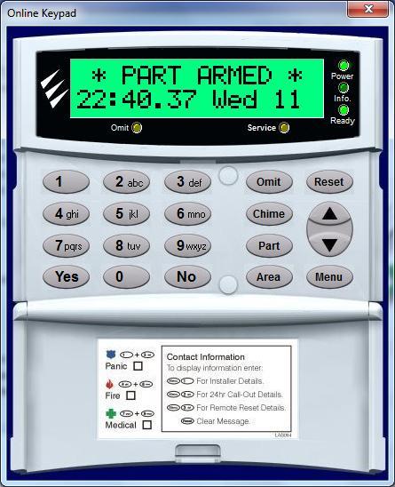

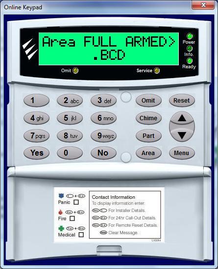

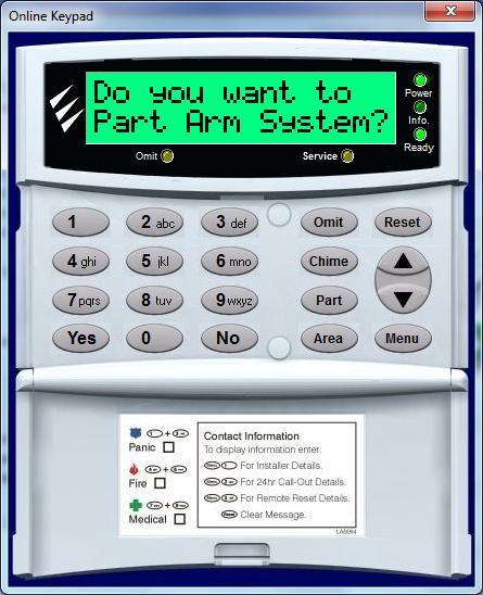

Tested the alarm again this evening and still got the same prob where Zone A has a continous beep and nothing happens till you manually switch off the alarm.
The alarm just gives me a continuos beep and doest secure zone A, just flashes between the two images.
When you try to full arm the system, everything secures itself except zone A

Not knowing this panel and its workings/programming and without reading all of this, it sounds to me that the door contact has stuck, (closed).
Just (ish) installed. Could be a stuck contact. I assumed all would be tested.

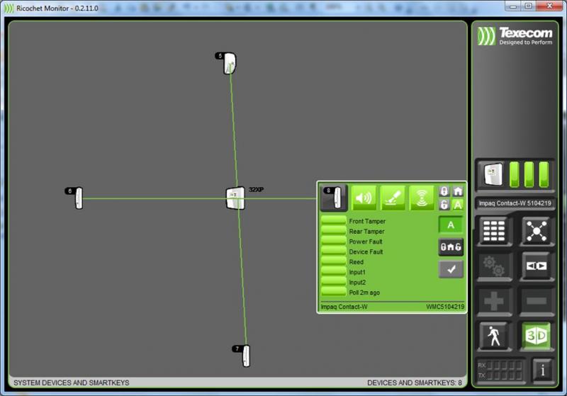

I can probably run the walk test software on Richochet to identify the culprit ...... if that allows me.
You should be able to walk test everything anyway.

In Wintex under diagnostics for the wireless items should this give me a signal quality reading? At the moment it doest say anything. Also in rchochect Im assuming as all items are GREEN they are talking to one another. Even in there I cannot seem to see any reading
If you see my image in the green box, I cannot see any reading bars

2: Pictures attached for the diagnostics for RF Devices
Picture for Expander 1
According to the first picture, you have three contacts and a PIR mapped to zone 1??
Is it only the wireless devices that you have assigned to Area A? (i.e. is it just the wireless devices causing trouble?)
