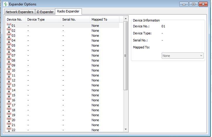

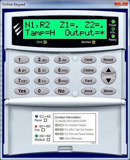

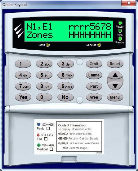

The Radio expander is not addressed, and as such the system knows it has something but is assuming a Wired expander. on the Address switch turn 1 on.

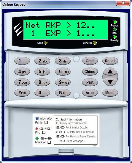

Go into engineers, Engineers Utilities Confirm Devices. Follow the instructions on screen, it should say you have 1 expander and 2 keypads. By the way the keypads also need to be addressed, you should have 1 on 1 and i on 2.
Do that and post a screenshot again of the Radio expander tab.

Ok Ive been playing around with the system since half 8 this morning and I still cant get anything populated under expander options.
Ive carried out the tasks you mentioned Adrian
1: Opened Wireless Expander and switched on Address 1.
2: Went to Enginers Utils and confirmed devices - yes to confirm and status show
3: Checked signal quality and everything seems to be fine from that aspect
4: Checked Status of Keypads and Expanders. Keypad 1 is on address 1000 and keypad 2 is on 0100

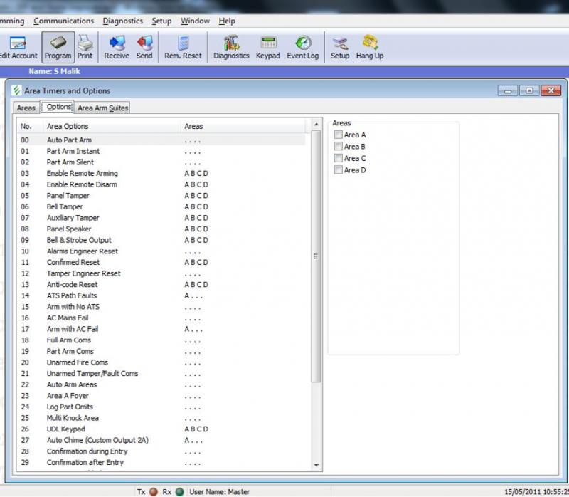

The other thing is I checked the Options menu under A. Is there anything I need to set in there as I dont feel confident that its right, seems to be things are missing
OK in the panel delete all of the radio devices and relearn them, lets see if they appear. When you have deleted them come out of engineers and then go back in.
On you options screen, unless you have a specific requirement uncheck all areas for Anti Code Reset.

Sorry dude, tried it again and still the same problem nothing being populated under Expander Options

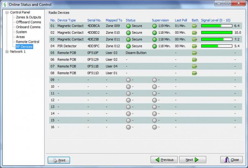

1: Deleted all wirless devices by going into the keypad, configure radio -> yes -> reset button which deletes the device. Removed all devices
2: Logged out of the system and logged off engineer
3: Opened 32-XP and put dip switch on 3 into commision mode
4: releart all devices and assigned a zone i.e. 9, 10, 11 and 12
5: connecect to wintex, made a connection to the panel and still nothing populated.
6: Set alarm back on for Zone A and nothing happens, alarm is on but you can open doors etc alarm will not go off.

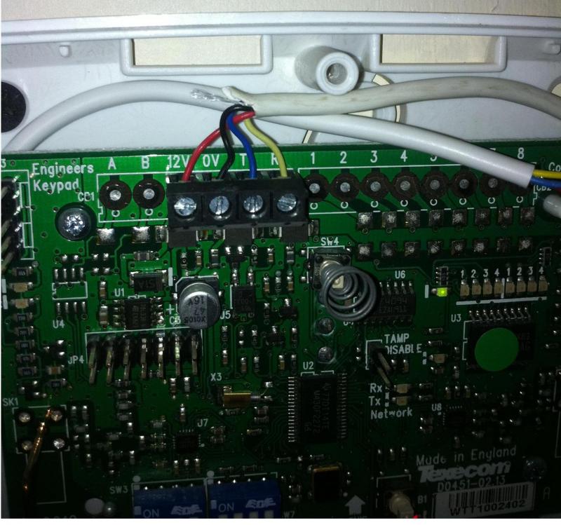

Going back to your pictures where you showed the wireless expander, what cable is that for the network connection, it looks like telephone cable?
Hi Adrian
That's a cat6 network cable which I've used through out the house. That's connect to the comIP for the wireless expander.

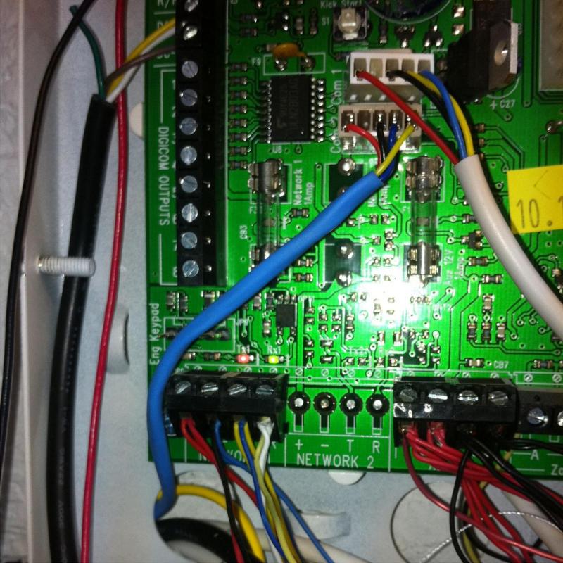

Ok so you have that connected to the network input on the panel the same as the two keypads yes? If so how have you wired, star, daisy chain or just chopped in somewhere? And have you checked you have the T+R connected the same in all cases?

Sorry, yes that was an old telephone cable that I had which I used as I had run out of alarm cable.
Ok I now went to the local shops and purchased some alarm cabling wire and re-ran that cable.
Wired it back into the panel under Network were both keypads are also wired in.

Both Keypads and Expander have dedicated cables running to it directly from the Panel. No chopping into or daisy chaining. Direct cables for all 3 items.
You seem to have colour cross overs on the panel.

Ran new cable, it looks like cables are crossed there not, colour of new cabling and I have made sure it's the same on the expander.
