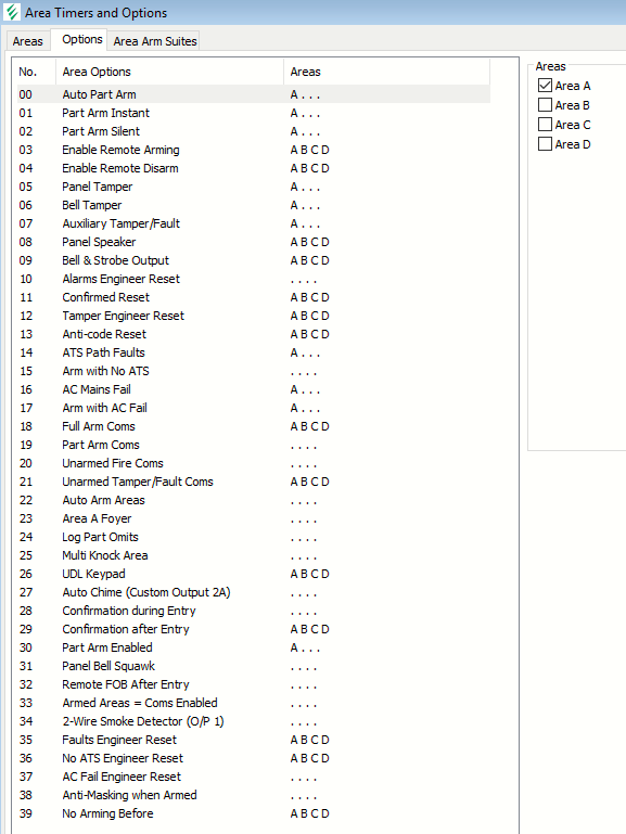

Another thing, whyme, i'm trying to part arm at night and have ticked all the boxes to silent arm but still get the control box making a sound as does the keypad - Can I set completely silent mode arm or does one still have to have these beeps?

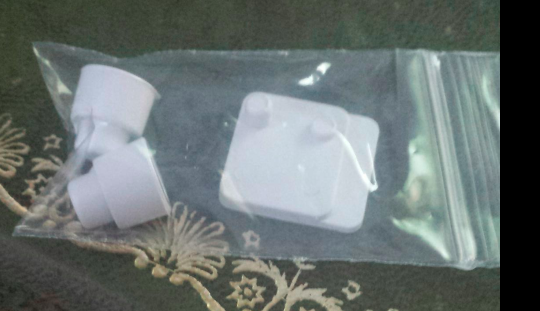

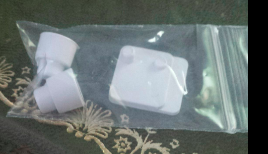

Got these bits with the Texecom Kit 0002! Does anyone know where the square bit goes - the round bits are to cover the controller box screws but the square bit???

is that done in areas- options- part arm silent-(enter areas)? and/or keypads-keypad sounds
This is my Area settings with silent par arm set for area A (02)
The square bit goes over the fuse ( 240 v) block ....or normally ....the bin!
Are you talking about the keypad bleep on silent set ?
I've fixed the keypad noise by un-ticking the Keypad Entry, exit and chime see below.
Still need to stop the control box beeping when I part arm at night - any ideas?
