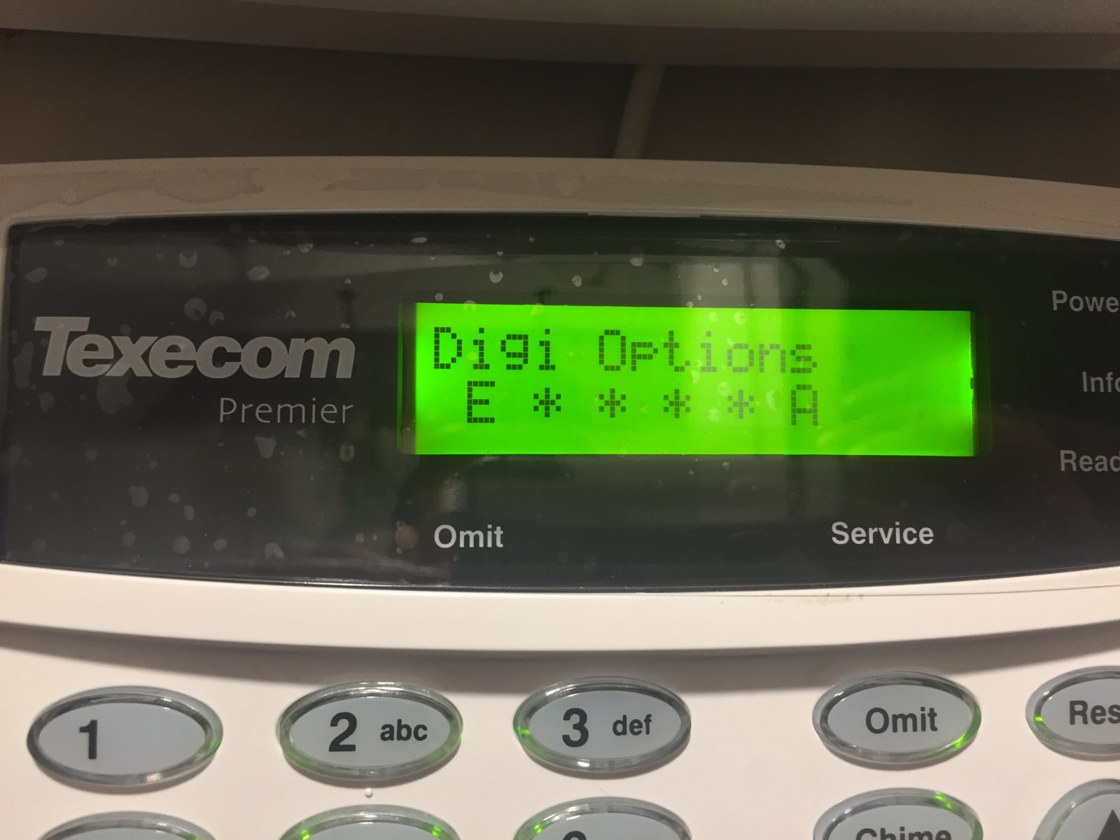

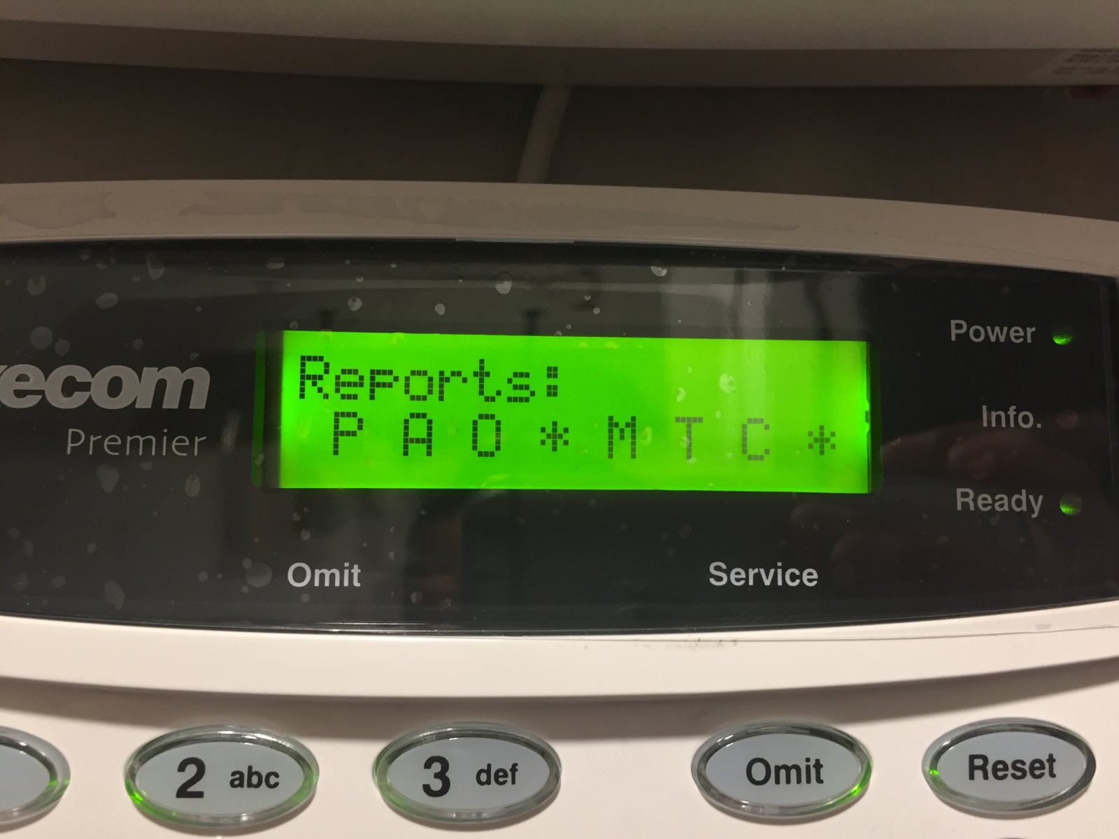

If you are getting notifications now, I suggest engineers code, 7 udl digi options, orogram digi, get to the reporting codes, make sue P is enabled.

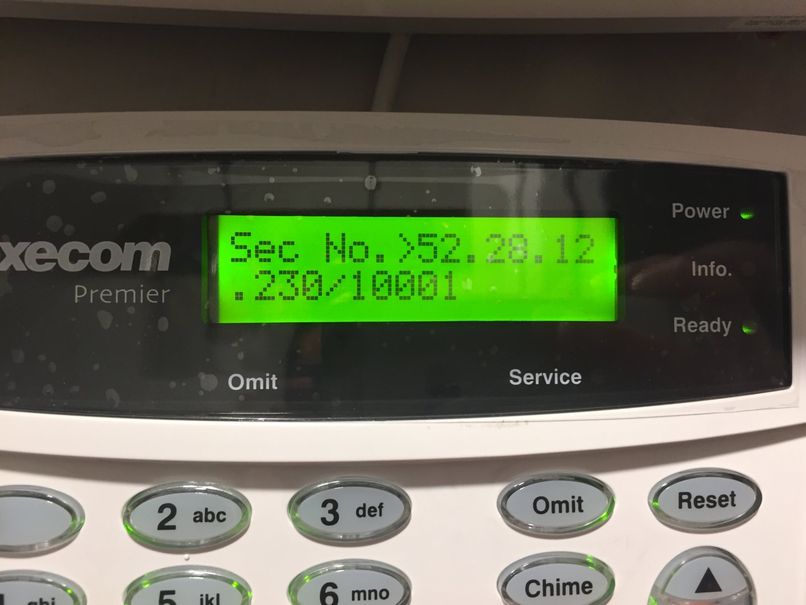

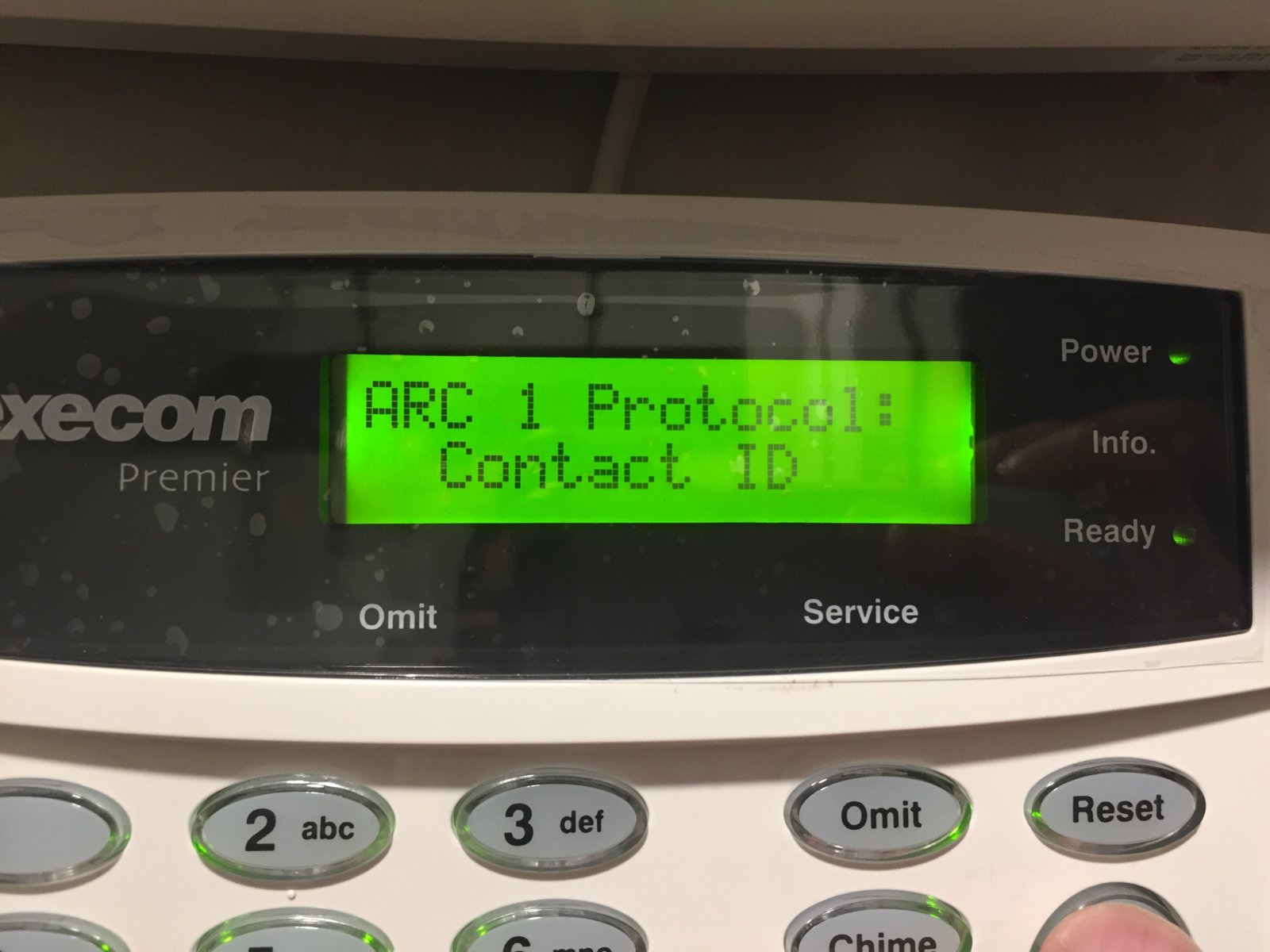

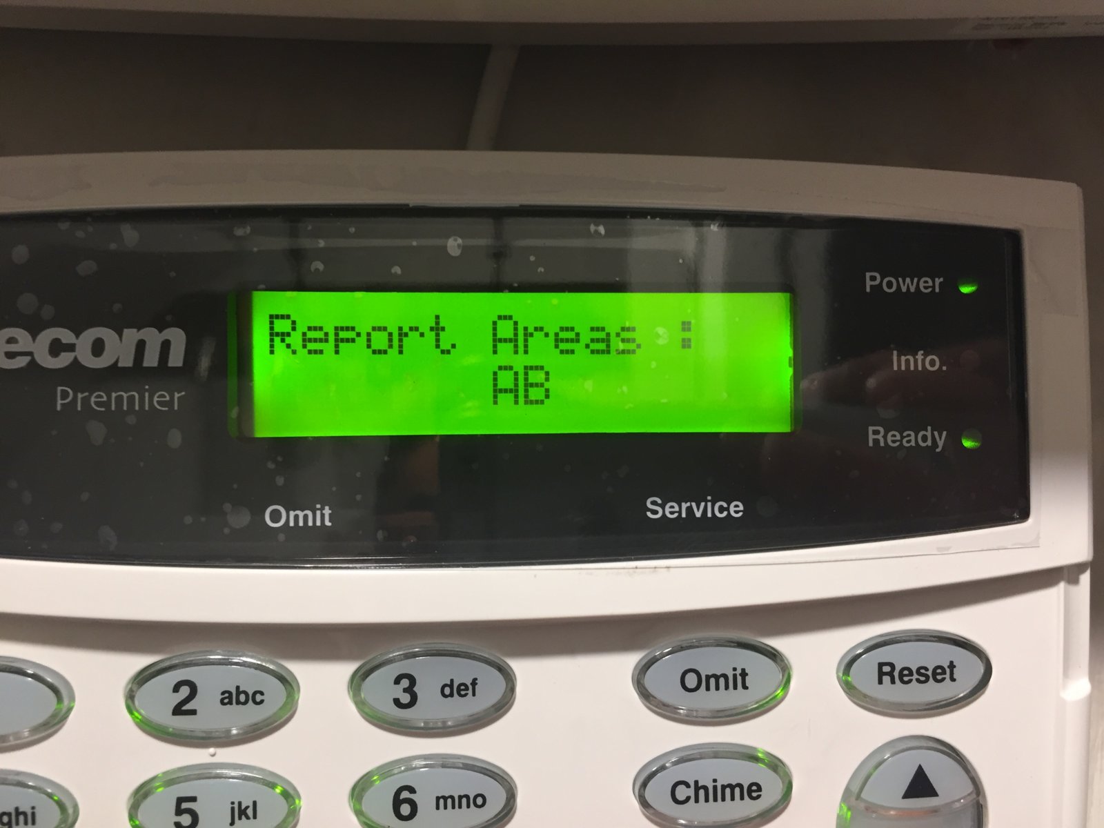

So no notifications at the moment as I haven’t input any of the attached. Hopefully that’s all it needs. Thanks for your advice.

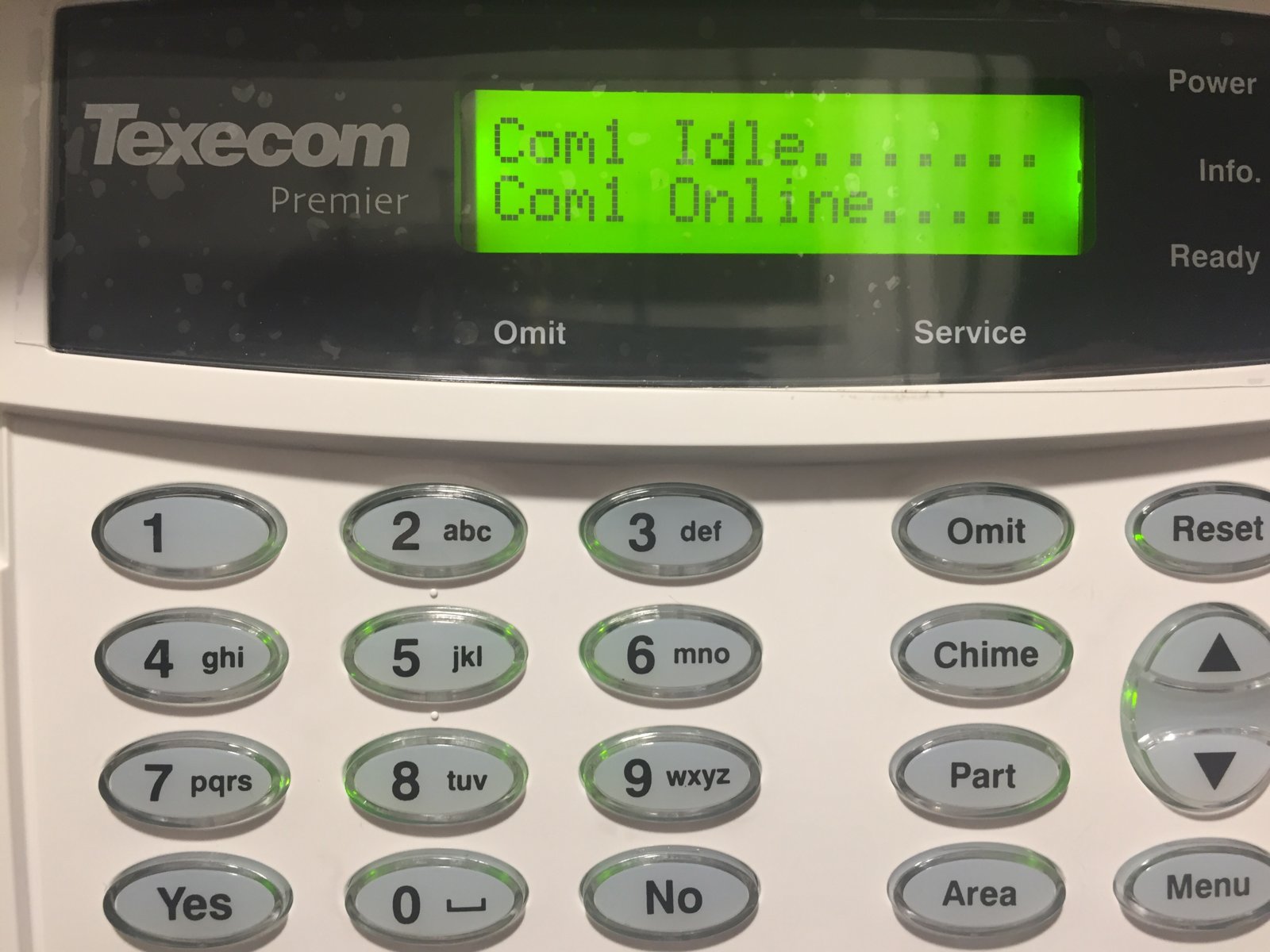

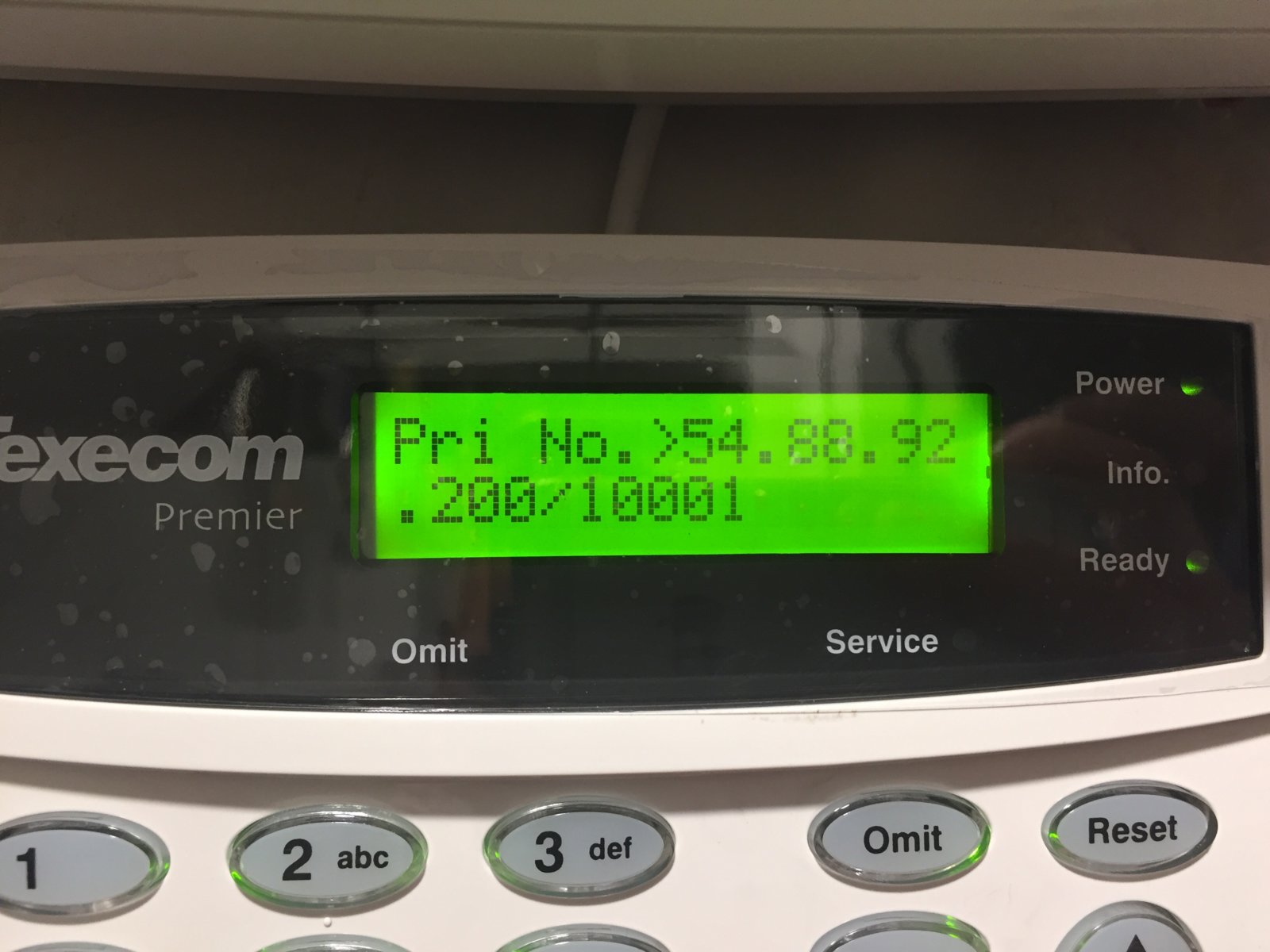

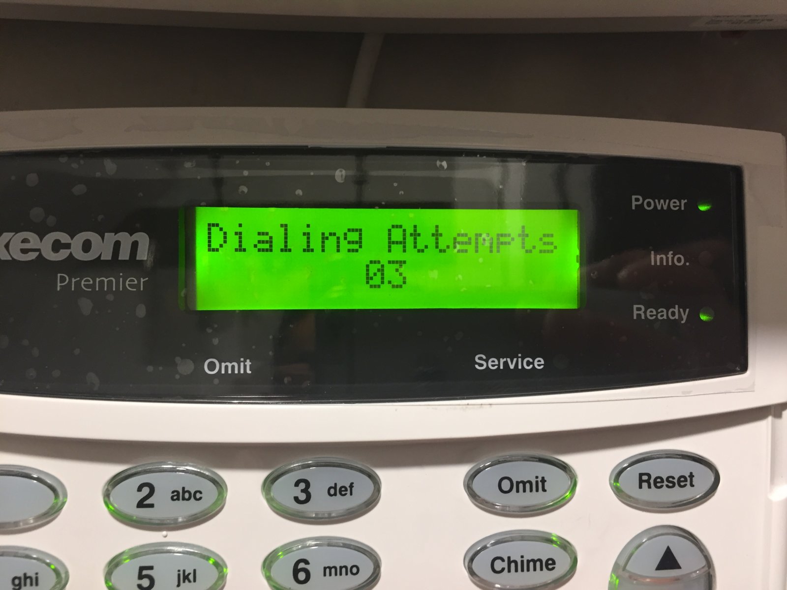

Hi so have entered as much information as I can but can’t see some of the listed options from the doc...

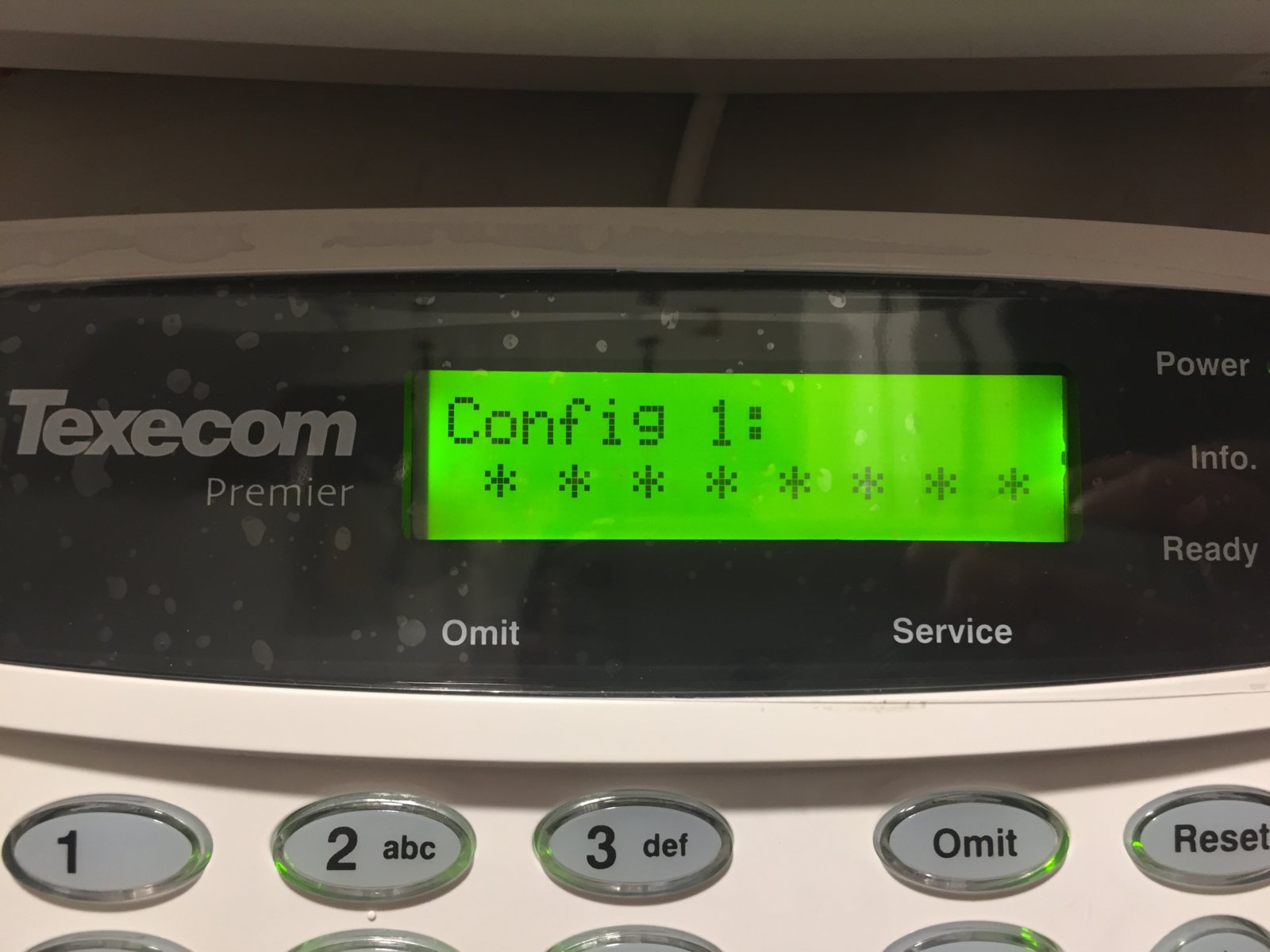

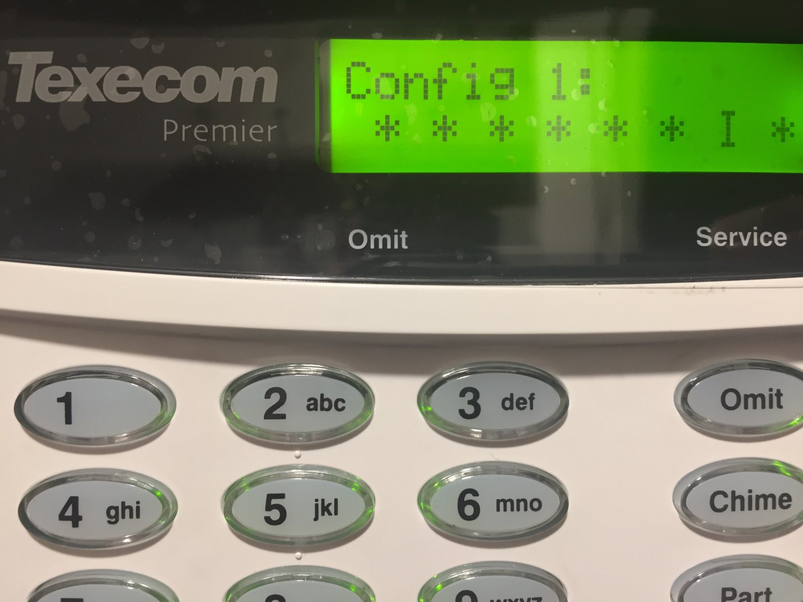

Can’t see the options to set Connect via IP and not sure What the toggle settings are. Thanks

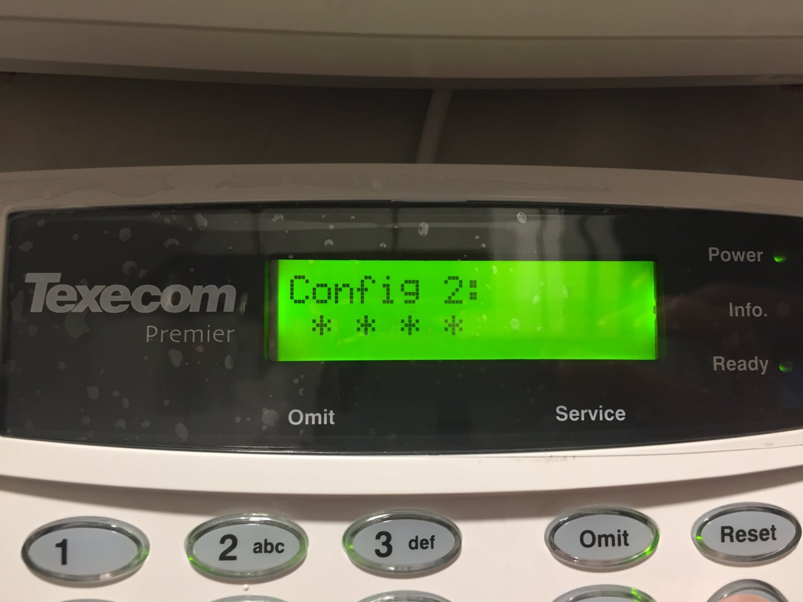

It's telling you in the setup guide, config 1 option 7 needs to be enabled (when you get to config 1, press no then 7 then yes)

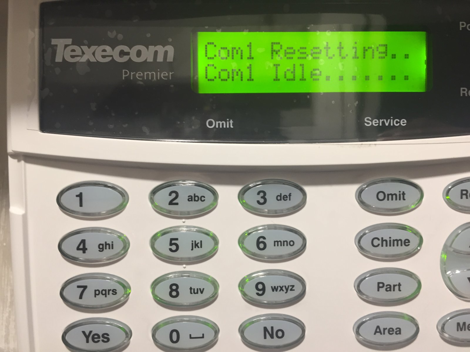

I’ve done the change and added connect via ip. I’m sure I only have 1 area so don’t think I need to change that.
Do I need to do anything with option 8 as I selected Contact Id as the arc protocol?
Do you have the Com IP connected to com port 1 on the panel? Might be worth enabling the "Use Com 1" option in Config 2.
