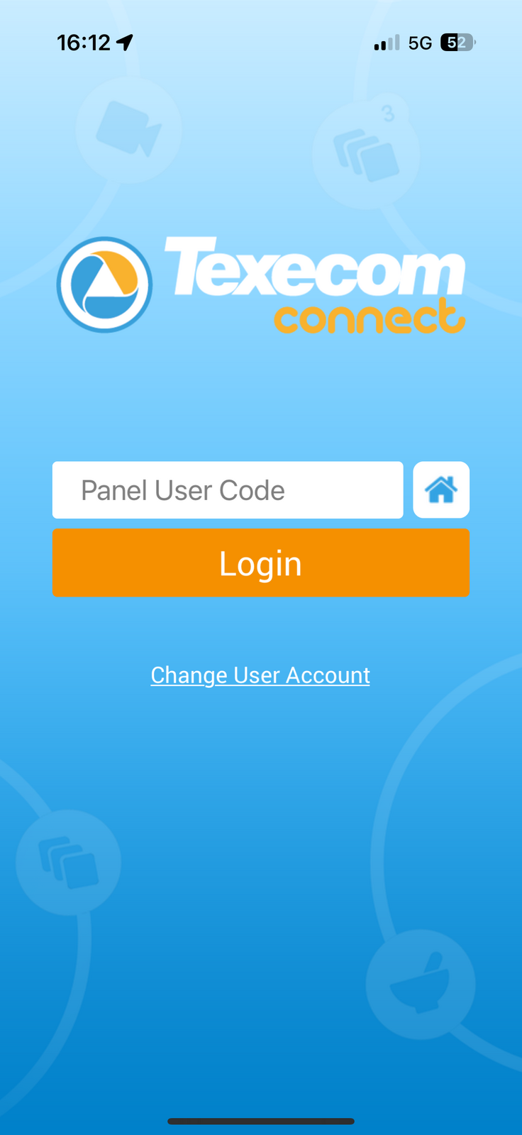

Seems I have two logins one in the dogs name one in mine…..
Any idea on how I fix the issue? Have i fried the com ports?
That’s the app I have.
