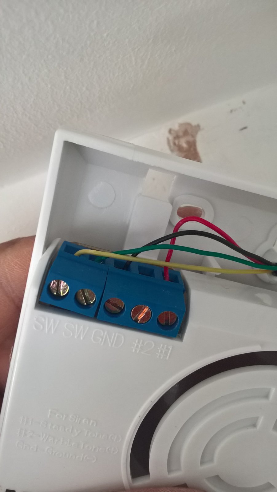

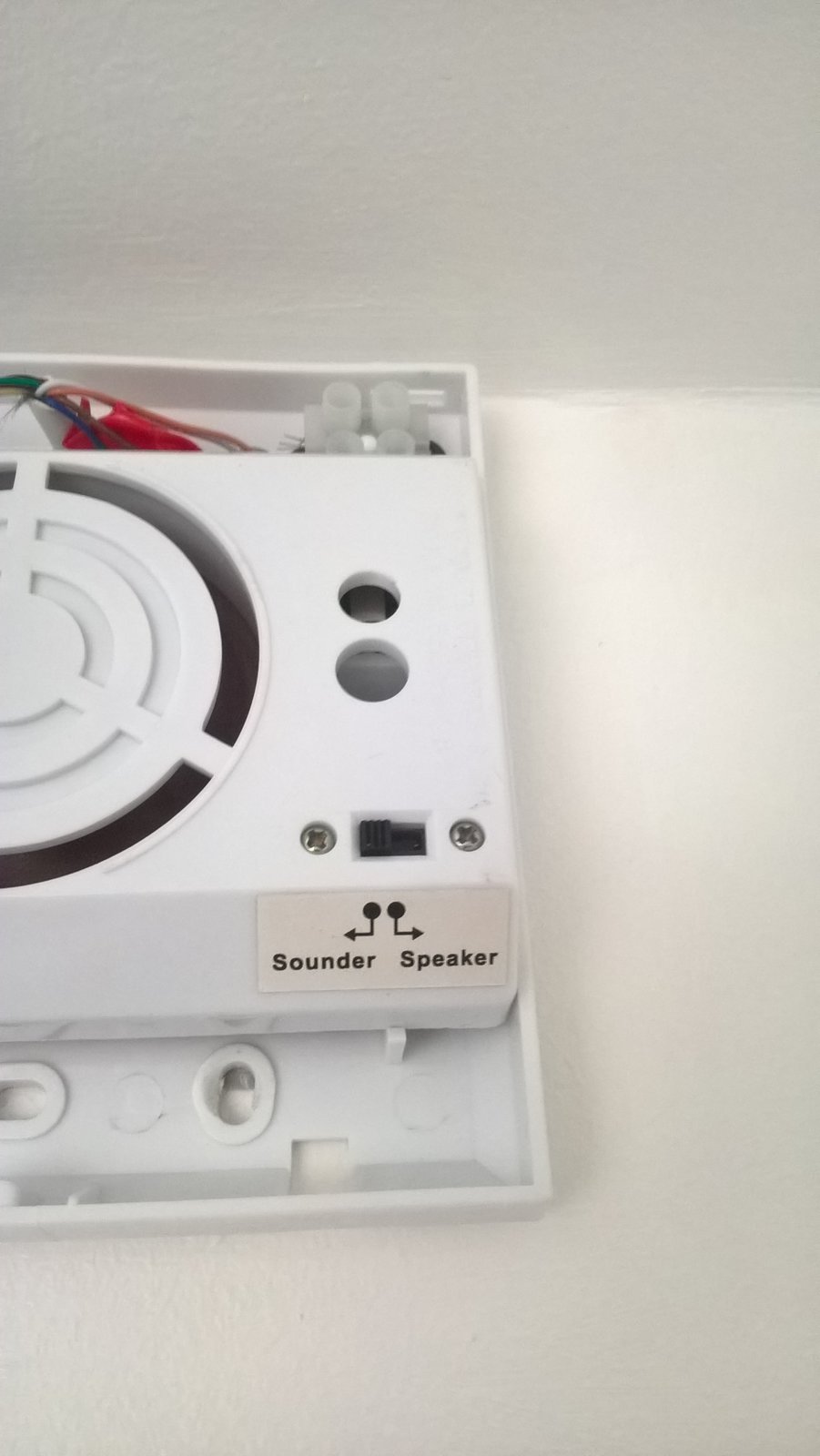

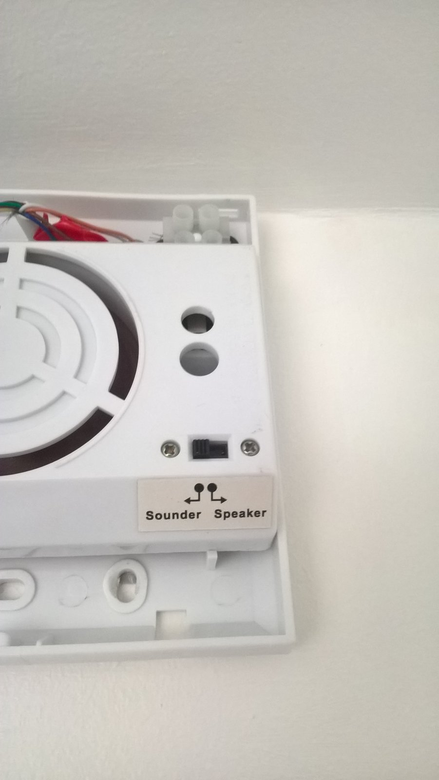

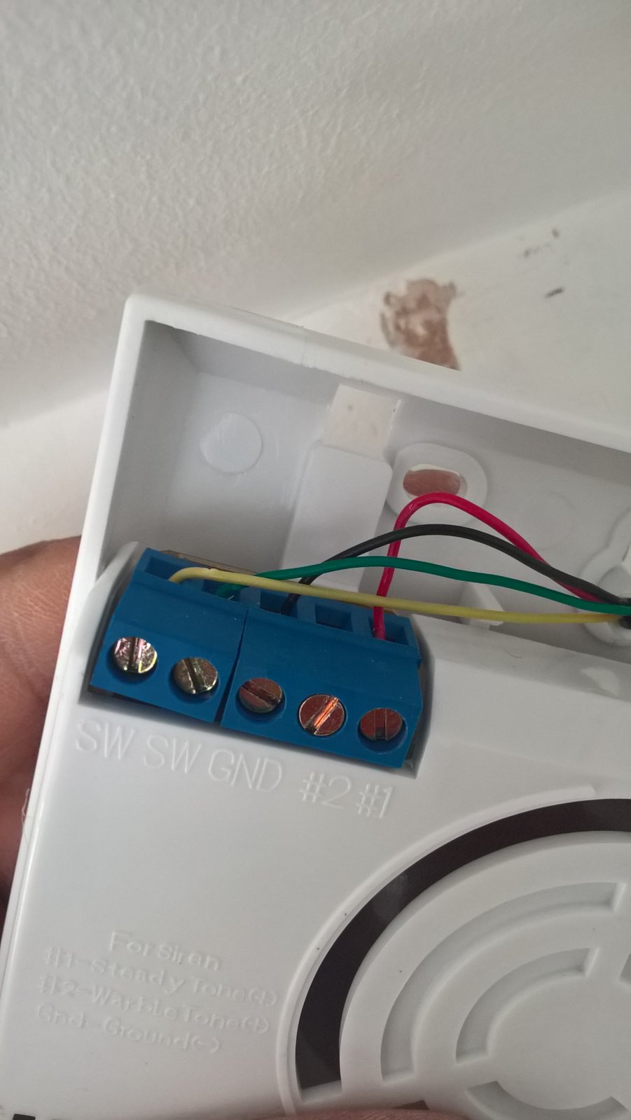

I thought I would open the sounder up again to check the wires as I only had an old picture of the wiring previously. Upon opening I discovered this:
Once this was set to "sounder", all started working.
The wire was put back into bell and not speaker.
thanks for all your help.

Nothing like a vital bit of information missing. Complete photos are always better!

ive actually come to post here to say my problem is rectified.( with a description for future forum readers) . i can only put it down to one of the 2 jumpers not seated correctly, because now both jumpers are back as stock.. all working fine..
