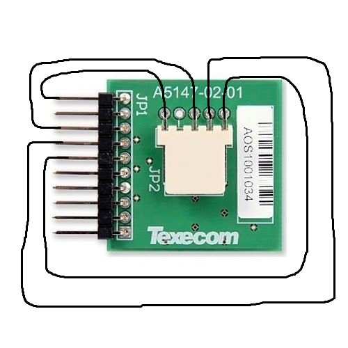

I'm currently working on a project to directly interface to the Digi Modem port connector on my panel and I would be grateful if anyone with a JAL-0001 board and a multi-meter could confirm the direct through pinout of the board?
This picture is a blind educated guess only and it could be (probably is) totally wrong but before I go probing my panel I thought I would ask in here.
Getting hold of a JAL-0001 board seems difficult and very expensive, and in my case I do not need it and will connect straight to the pins on the alarm panel to open up Com Port 3.

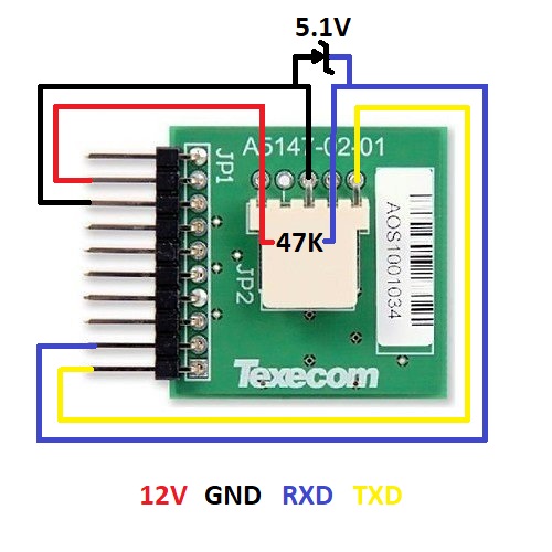

Reverse engineered a JAL-0001 board and attach my crude drawing here in case the information is useful for others.
The Zener diode (shunt regulator?) circuit looks like it is designed to reduce noise and stop the RXD input floating with nothing connected to the port and ensure TTL levels are either Low (~0V) or High (~5V) if something is connected to the port. In practice, if a device is permanently connected to this port you can probably make a direct connection without consequence.
DO NOT USE THE PINOUT DRAWING A FEW POSTS AGO IN THIS TOPIC BECAUSE IT IS WRONG!
Yes, thank you Sir!
You are an asset to the Forum :)

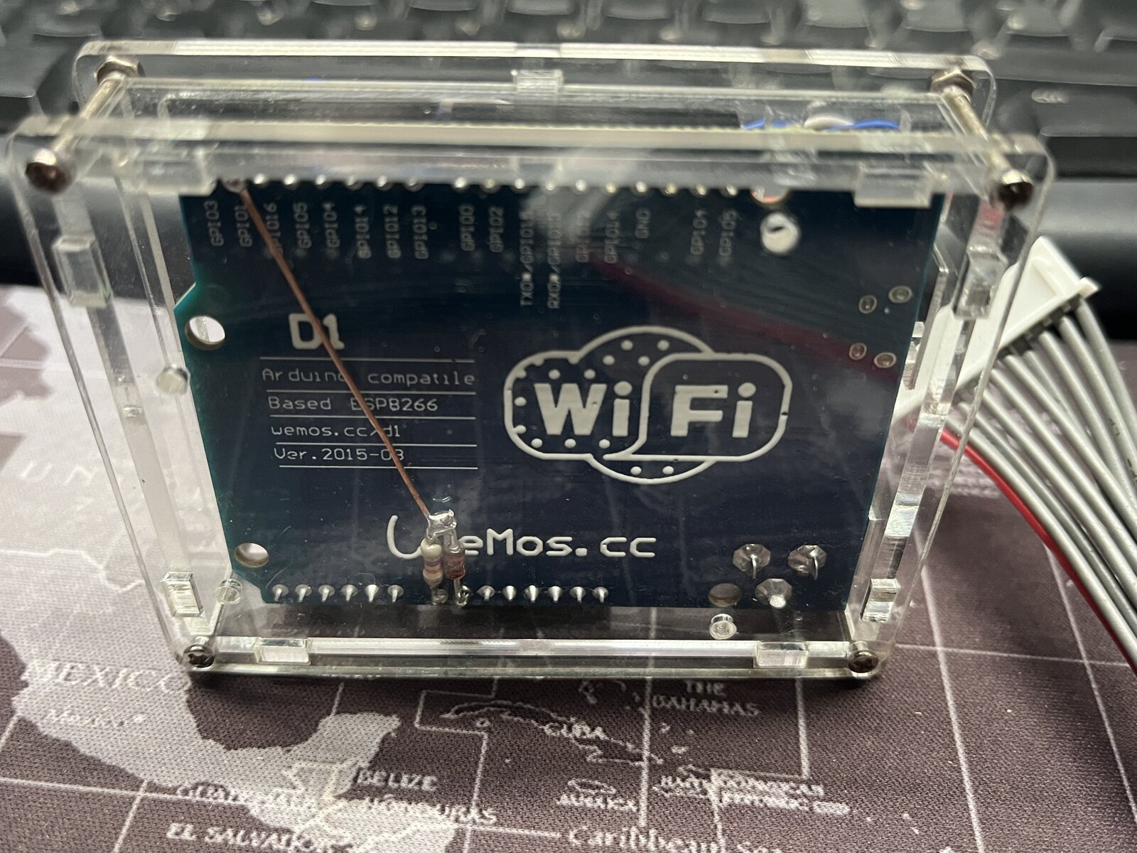

I configured and programmed a Wemos D1 ESP8266 module with esp-link and tested on the bench using PuTTy and sending data across the network at (19200 8N2) and I even included a level convertor module to interface the 3v (WeMos) & 5v (Texecom) TTL levels. This setup works flawlessly between 2 modules across the network and also works fine programming a number of other items using a serial port over the WiFi network. Basically, what this module does is offer a straight forward serial port to WiFi/IP bridge so the panel sees the connection as a straight forward UART connection (USB-COM). The issue I have is that the Com Port 3 on the Premier Elite 64-W just does not want to communicate properly and I am starting to think this could be related to Monitor Mode being enabled. Com Port diagnostics on the panel just outputs occasional gibberish on RX but never seems to respond.

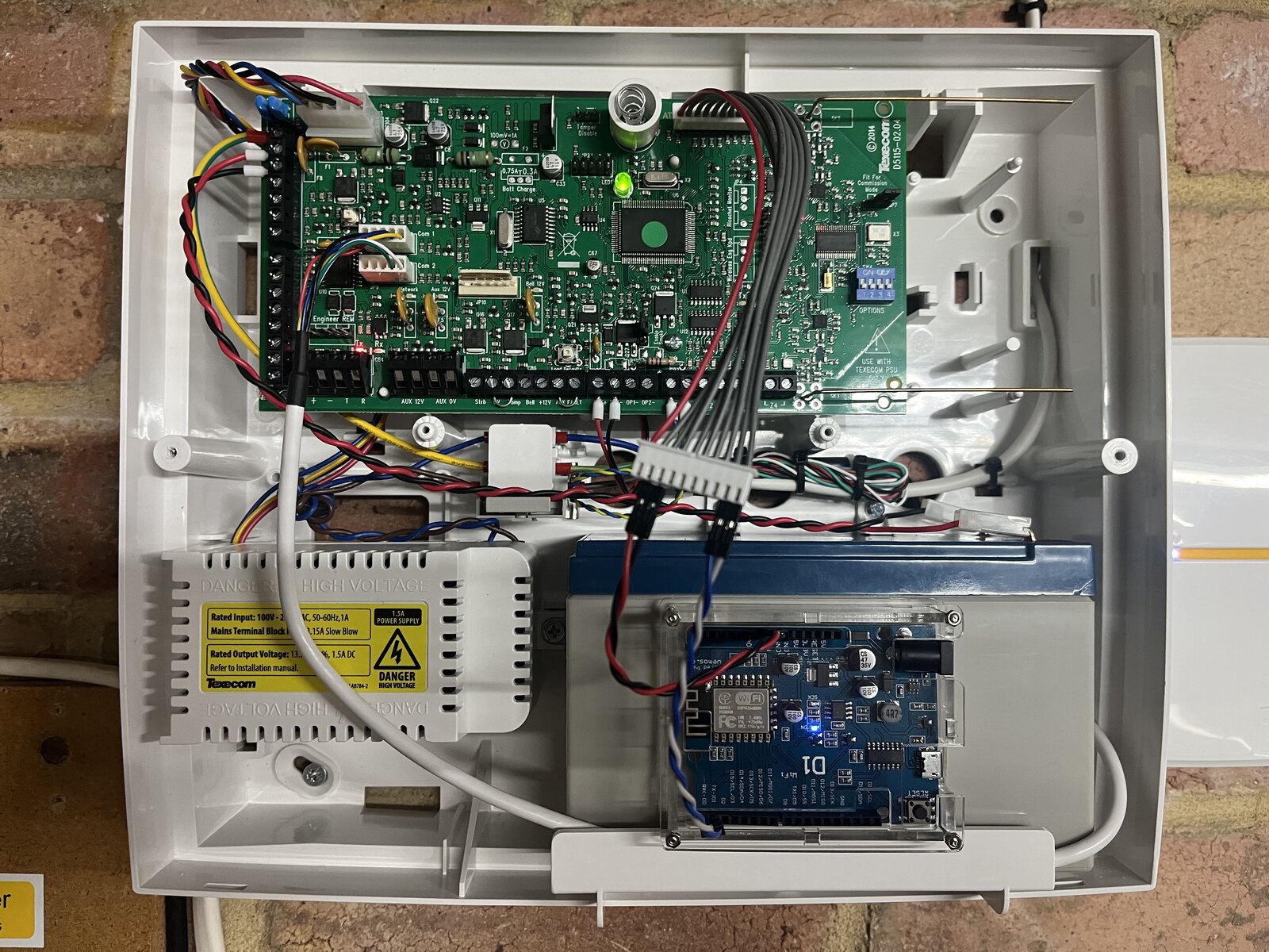

Image below showing where I am at currently. The ComPort+ module has been omitted and the components put directly on the back of the development board to save space (second picture). Also, not in the picture is the TTL level translator that is now part of the project as well to make sure that the ESP8266 (3.3V) and Texecom Panel (5V) TTL levels are correctly aligned.

Are you sure the COM ports on the panel are 5V TTL? - if the panel is capable of communicating to a computer via a USB to serial adapter/serial cable, then the panel should be able to accept signals at RS232 specs, via charge pumps etc.
For me playing with these, I would definitely borrow that laptop, and try and connect directly, as a first troubleshooing step.
Alternatively, have you got anything else with serial capabilities you can start the ESP8266 talking to - test equipment often has com ports for example?
The ESP8266 is a bit dated now but still a great piece of kit for IOT - I think mine are 12E but essentially the same module.
The COM port on the alarm panel is confirmed 5V TTL logic and does not communicate directly with a PC using RS232 levels, but via a bog standard FTDI/CH340 etc USB TTL adaptor and although I have also used a TTL level convertor (3.3V<>5V) in my project, both the ESP & panel are reported to tolerate 3.3v & 5v levels.
The ESP8266 is confirmed programmed and setup working with esp-link and talking to other equipment using VSPE with a virtual COM to IP connector. I also tested back to back with another ESP8266 module over IP and WiFi using PuTTY without any issues.
I think (hope) this is simply a case that with the panel firmware addition of Monitor Mode which seems to hard code a number of the communication settings, the additional Com Port is impacted in some way and prevents me doing what I want to do. It may be that although the panel has 3 com ports, the microprocessor can only directly communicate with one com port at a time.
