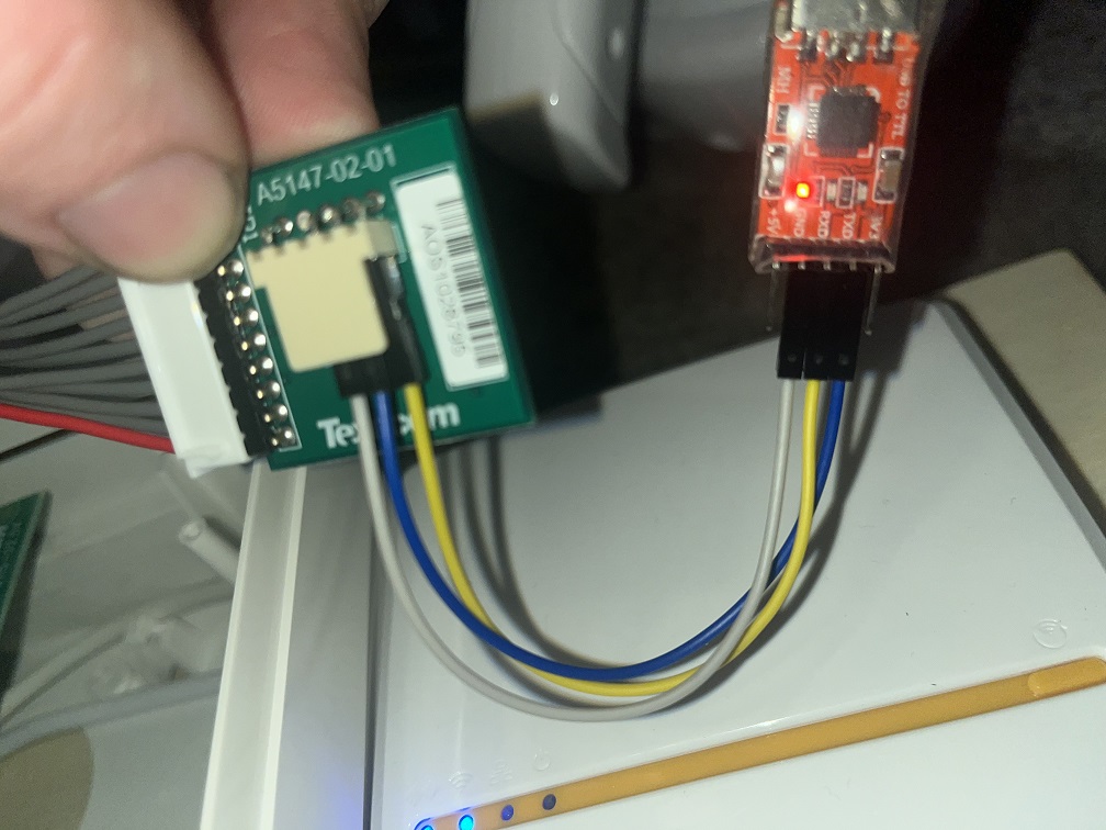

I was thinking along the same lines and I suspect that Texecom panels may simply not play nicely with the (possibly fake/cloned) CH340 chipset of Arduino based modules.
After going back to basics and testing with a CP2102 module, Wintex connected straight away without any issues on Com Port 3 and without any configuration changes (this is basically a USB-COM after all).

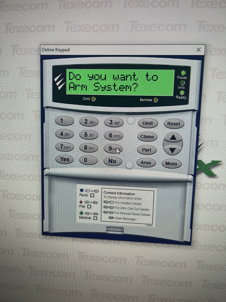

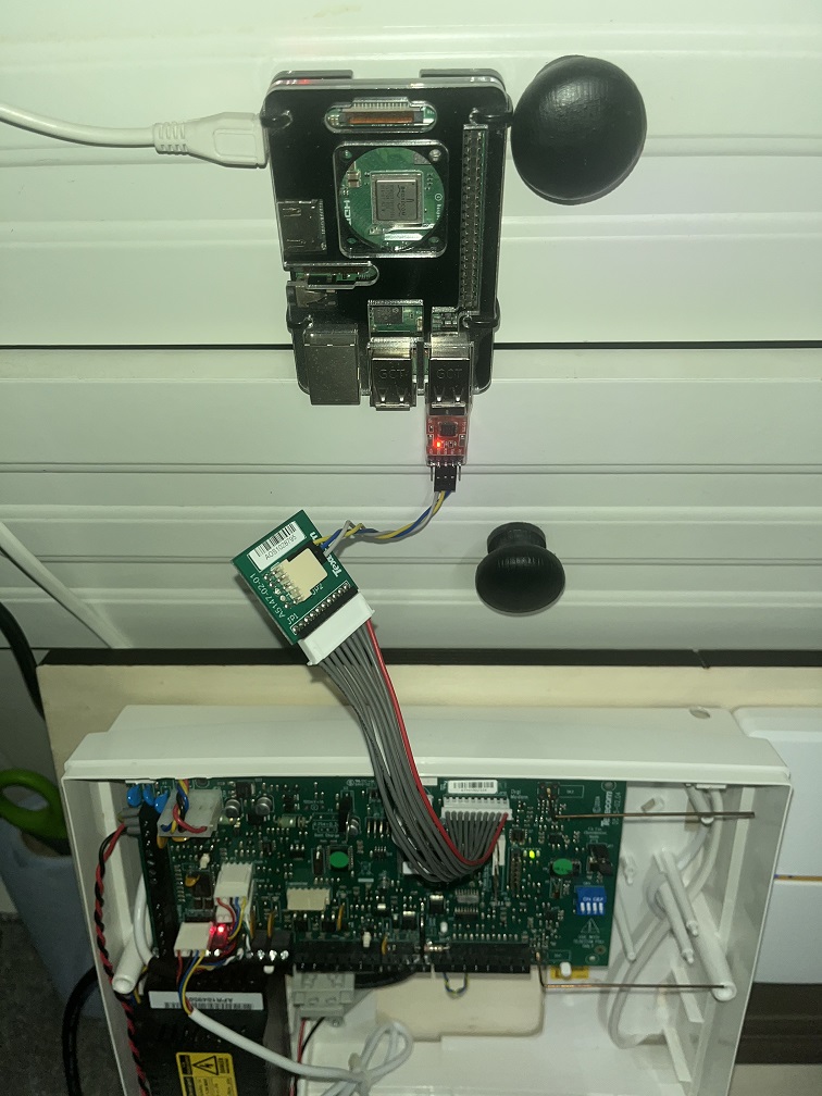

...and finally success!
Raspberry Pi 3B+ running 64bit Bullseye, fully headless (SSH & VNC setup), ser2net installed and CP2102 USB module and we have a rock solid Wi-Fi backdoor connection to the panel on com port 3 along with a Smartcom installed on com port 1 & 2.
This also works with the panel setup in Monitor Mode and can be accessed concurrently with Wintex whilst connected to the Texecom Cloud at the same time. I tested this by running the online keypad in the cloud and also the online keypad in Wintex at the same time.
This is not rocket science but it is a challenge to get it all running with the current releases of software which have mostly been updated far beyond the requirements of this project.
I think the issue with the CH340/Arduino modules are not the serial levels but the default baud and parity connection algorithm which will need further investigation.

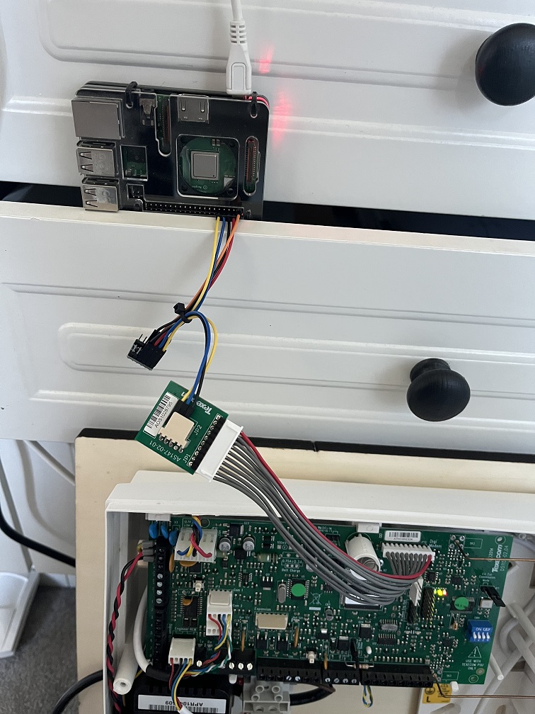

I played around some more and I have now removed the USB adapter totally and I'm running direct to the RPi UART GPIO pins via a small level shifter (panel is 5V TTL and the RPi is 3.3v). Setting this up was a challenge with recent changes to the Raspberry OS!
This appears to be rock solid so far and coupled with a Pi Zero 2, this would all fit inside the panel or mounted neatly outside.
I have a new Pi Zero 2W somewhere doing nothing so I may switch over to that next week to make it more compact.
As a side note, something @secureiam mentioned a few weeks back got me thinking - the original Premier panels are quite dated now but still plenty around and with Redcare being switched off soon. This is an easy and cheap way to add some smart features to a dated system where an upgrade is not viable or wanted.

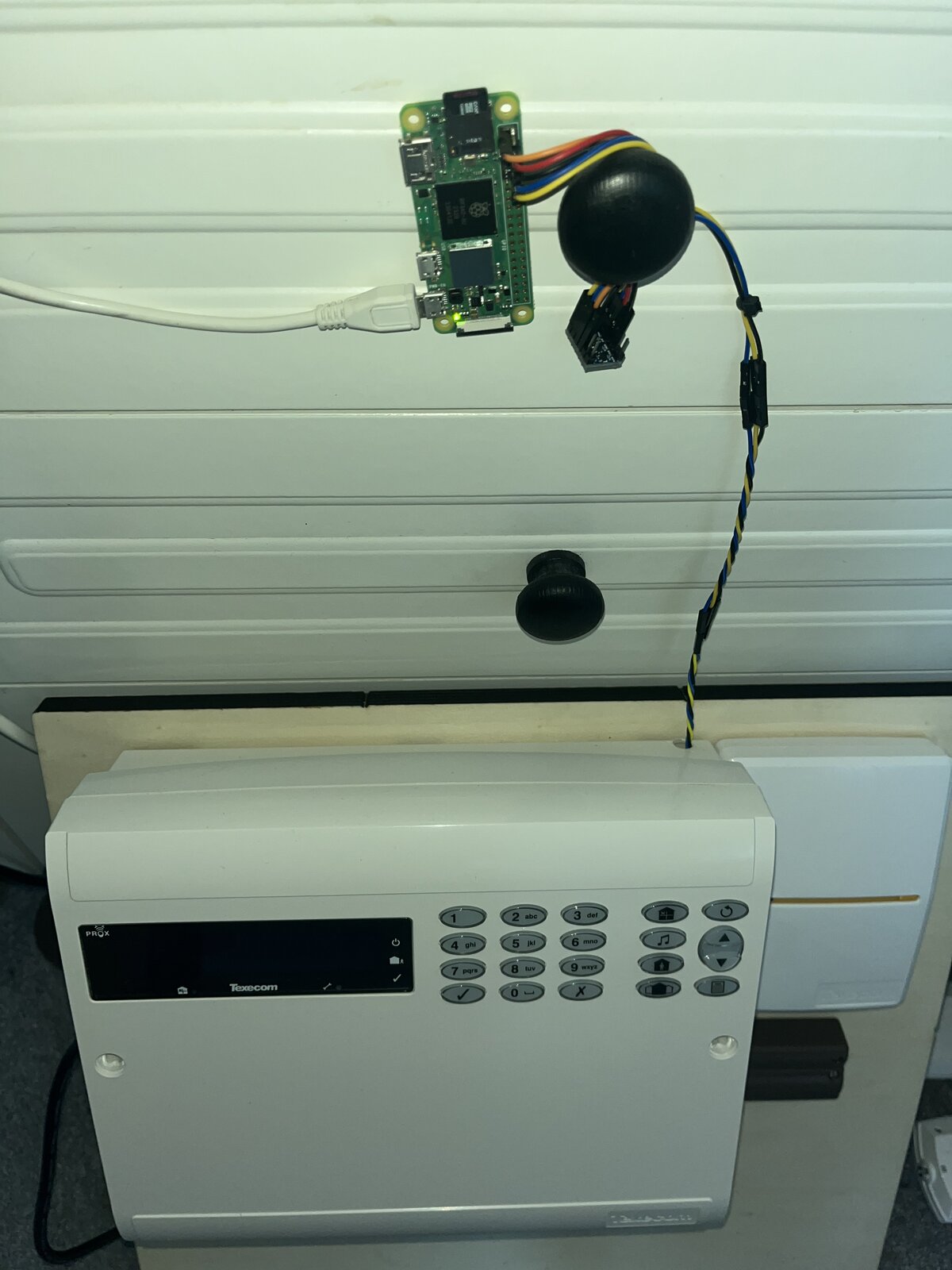

Latest project update running on RPi02W and working well.
I don't think I can power the RPi from the panel directly but I'm thinking of running this in a small external enclosure on top of the panel anyway to reduce the possibility of RFI to the WiFi so a separate PSU is not a deal breaker.
After spending a few hours again with the ESP I have aborted using them because either the 2 units I have are both faulty or the modules simply will not communicate with the Texecom ports for reasons unknown. Every other device I try to communicate with using the ESP just works.
The Pi02W does eveything that the ESP can do and also has 5G WiFi as well which is a bonus. I appreciate the SD cards can and do fail but I'll clone a working image once setup and keep it safe so imaging a new SD should only take a few minutes.
