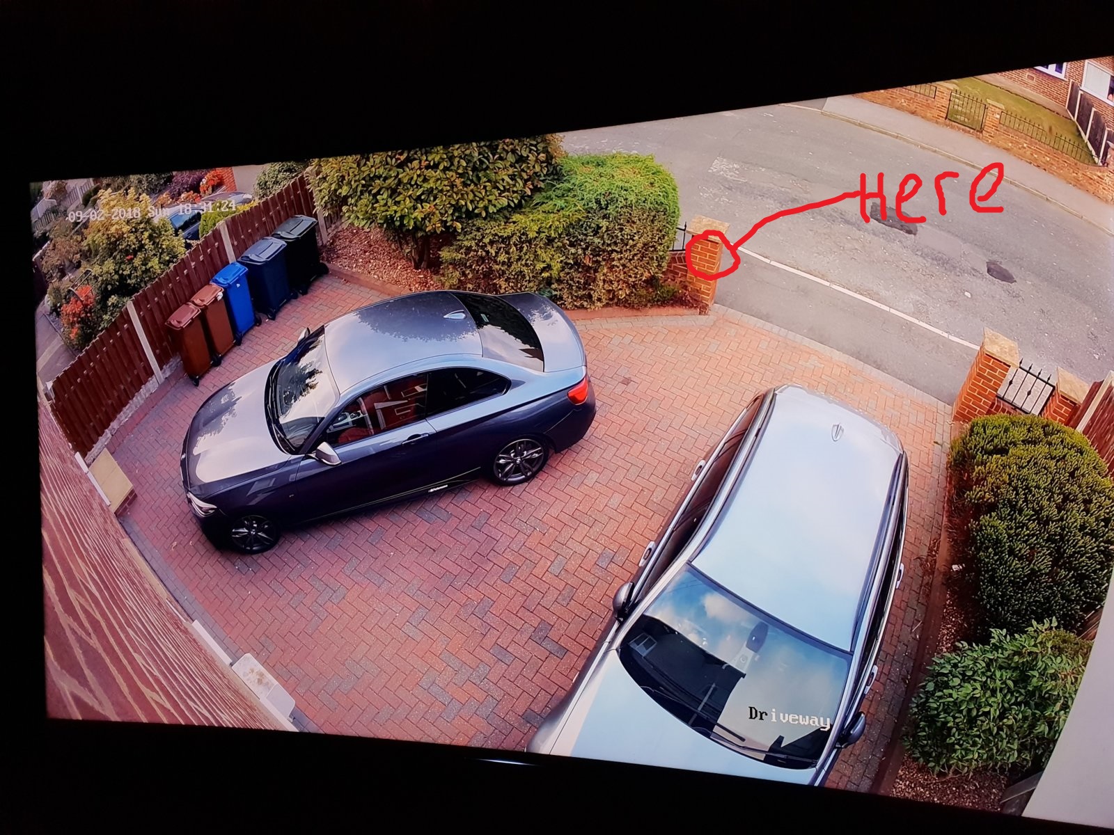

As regards to the external PIR to trigger my flood lights via the alarm panel, I am now wondering if there is a better solution than the ugly Texecom TD AFQ 0001 ? Firstly, with a 90 degree beam angle I think I might struggle to set it up properly on a driveway 10 metres wide. I have seen a beam detector made by GJD which I could place on the pillar of my driveway entrance..............this...............
https://www.alertelectrical.com/gjd...MI6_bj2uSR3gIVlOF3Ch2dMgktEAYYAiABEgKd4PD_BwE
Think I can easily bury a cable behind the bushes running behind the bins and through the wall to my alarm panel. Anyone used this type of sensor? Reckon it would be suitable??

Trying to control the lights through the alarm system is probably over-complicating it a bit. Have you looked into the GJD lighting control systems? Obviously it's an additional cost, but will do what you need out of the box.
To do it through the alarm, you could set it up like this:
Connect the GJD sensor to a spare zone, program it as "Moment Key" with the "Monitor Only" attribute. You can assign it to a chime tone if you want, but otherwise, this zone will not actually trigger anything on the alarm.
Program the 3 zones that you want to trigger the lights into "Zone Group 1"
Program an output as "Zone Group 1 Mimic" and assign the Pulse 1 attribute to it. In Global, set pulse time 1 to however long you want the lights to trigger.
Connect a relay with a 12 volt coil and contacts rated to 230 VAC at 10 amps (coil current should be less than 100mA and suppressed with a diode) to that output and use the contacts to switch the live connection to the floodlights. Bear in mind that the lights will also switch in the daytime, unless you use a photocell to feed the contacts of the above relay instead of the permanent 230v supply. You could go further and assign the external PIR to a seperate area so that you can arm/disarm it if needed.

Sorry, I misread your post regarding the GJD sensor, I've twigged you meant the PIR I am putting on my drive post. Where on the PCB is the output where I would connect the relay to ?
There's 2 wired zones in the keypad, if you have spare cores you can use one of those.
I would put the relay in a plastic adaptable box in the loft, run a 6 core alarm cable to the panel and treble up the cores if you're worried about volt drop (red/white/yellow as +, the rest to the output)

Thanks Scott, really appreciate your time. I don't need any more zones, the external GJD PIR detector will go in the spare 8th zone on my main panel. I get everything you say, I'm just not 100% sure where the output is on the panel. When I am looking at the PCB there are 8 outputs in the top right hand corner, 8 are digicom o/p and there are 2 others to the side marked L/M and R/R and there is one at the bottom which is Output 1, I assume this is the one to use and where I put the negative wire(s)
Thanks again
You can use Output 1, you just need to program it as described in my first reply. The negative from the relay is connected to the output, the positive of the relay goes to the 12v aux supply
