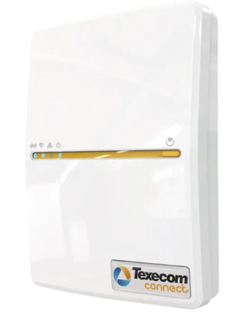

Hi, recently installed Premiere Elite 48 with Smartcom 4G, alarm works as expected, cloud is fine along with connect. The Smartcom 4G is connected with ethernet/LAN cable which works OK, but, for some reason the unit does not seem to think 4G is operational (no light), or even present. When trying to connect to a site through Texecom cloud and selecting Dual path the message returns an error as follows:
"The communicator type you have selected has 4G capability but the one associated with the site does not. To complete this process you will need to physically replace the communicator."
Am I missing something here, does ethernet cancel out the 4G, did the config not complete as it should, hoping the Smartcom unit is not faulty! no doubt something I missed. Push notifications are also all working as expected. Wondering if I need to connect it to Wi-Fi instead of LAN, no doubt a simple press of the button on Smartcom will resolve this :LOL:
Any thoughts on this welcome, I do have Wintex running and configured most of the system using this method, as for the Smartcom and 4G, can't see the wood for the trees at this point :giggle:

Post picture of the unit you have fitted does it have an aerial ?
Smartcom 4G with default Texecom antenna connected, 100% a 4G unit, purchased new just a week ago. I have 20+ years in IT Networking/Support so reasonably competent, set up the system no issues through Wintex. This style unit as below with the four lights, currently LAN and Cloud are solid, wifi and 4G not on at all - Texecom logo is all white not coloured as shown in this image.

OK, mystery solved! I had totally failed to realise the 4G module lights are behind the main cover, they were dead, bad micro USB connection on the lower socket, wiggle it and the lights come on :oops: - will test another cable just to be sure what it is but looks like a bad socket. Will have to return either way, I did think it felt a bit insecure when reconnecting, makes sense now. Thought I was going mad. Thanks for you response and assistance.
