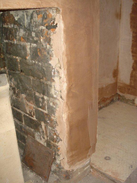

Things like how the openings of the two chimney breasts have been completed or rather not completed. Just a rough raw edge. How there are little bits of plaster that have popped off the edges of ceilings where the wall paper was removed from the walls, after the ceilings were skimmed (which admittedly is my doing) but how they have just been left out from the process of skimming and ignored. How the bottom of the plaster which is supposed to be a uniform bottom 2" from the floor represents the himalayas and it obviously not flat. How the joint interfaces between the walls to walls and walls to ceiling are not joined seamlessly. "The decorator should be able to... " grrr

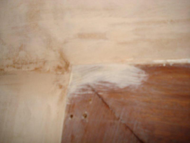

OP, could you post some pics of what is really bothering you, just out of interest to me??
I have taken some pictures of all the offending items. To be fair, visually speaking the rest of the job looks ok, to my untrained eye.

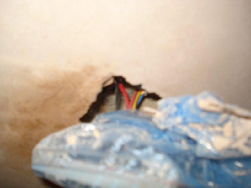

Hole in finished wall.

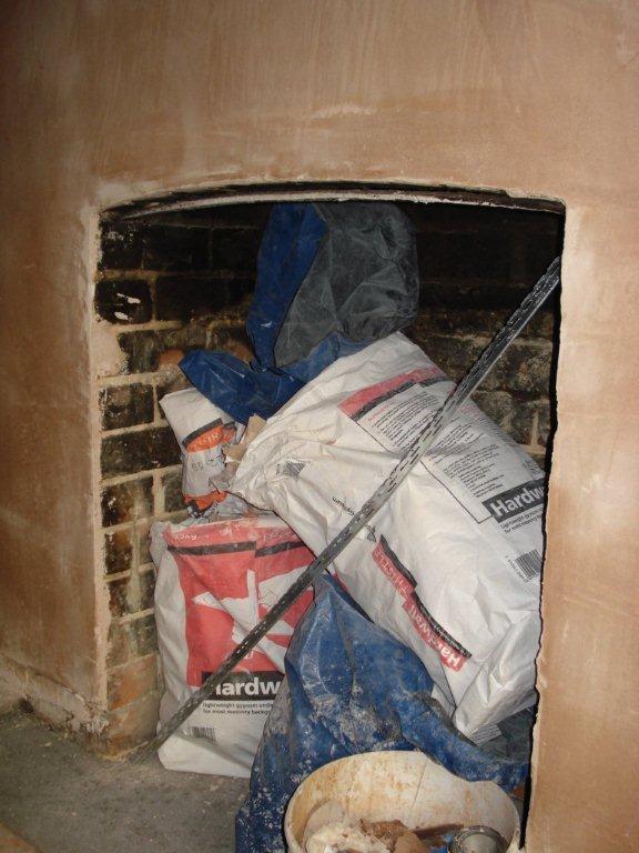

Dining Room fire place
So - I just paint that edge do I ?

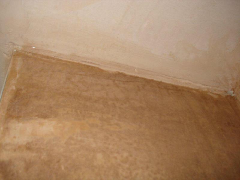

Wavy wall

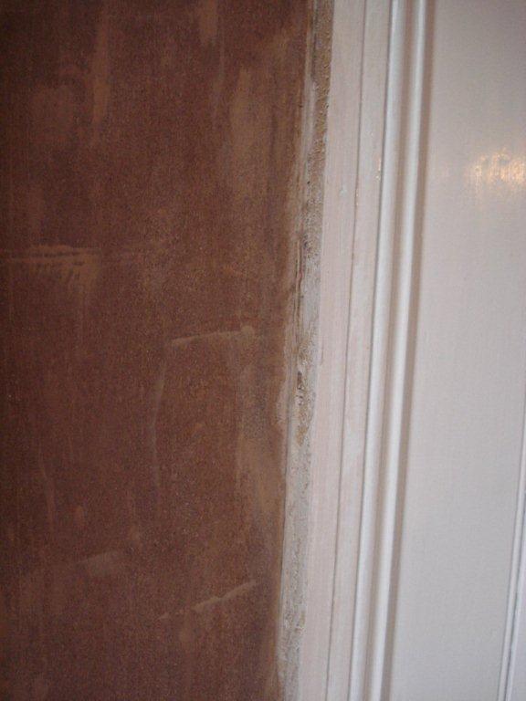

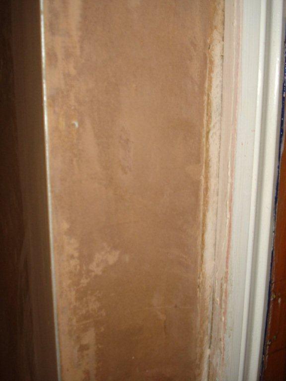

The plaster is not flush to the architrave here. It's a few mm low. The architrave is not painted on the rear so it's hard to see. The wall was modified you see.

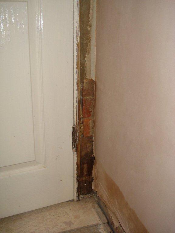

What hapened here?
A bit which was just forgotten

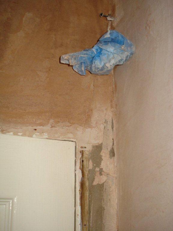

Top of the same door frame
Just another 2cm with the trowel is all that would take.
I'll chop out all the sockets
Sockets not chopped out.

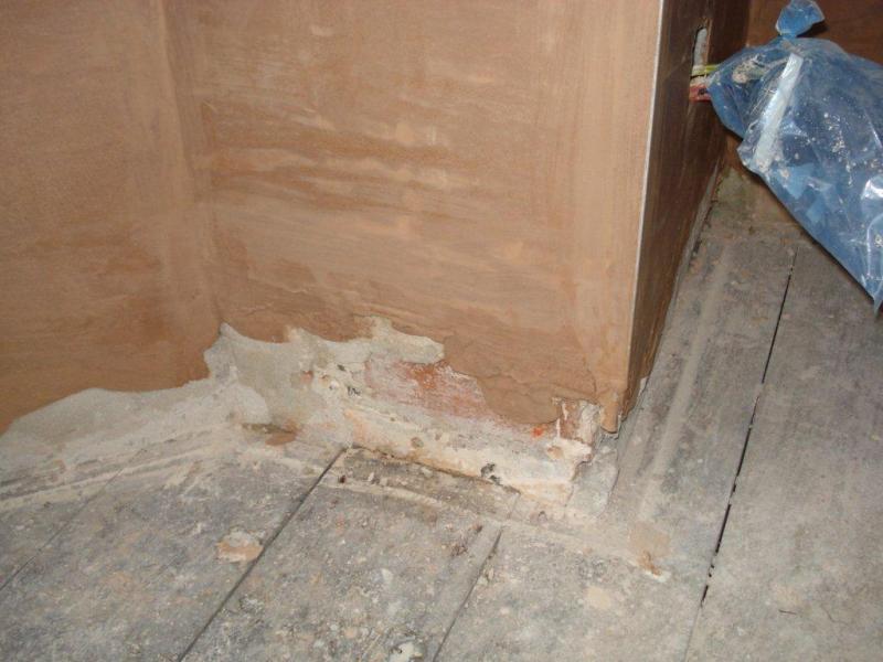

Missing skim

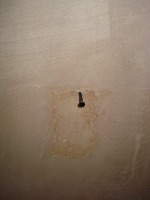

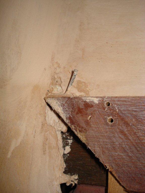

No plaster round the nail..
Nail removed and plaster applied on the other side...

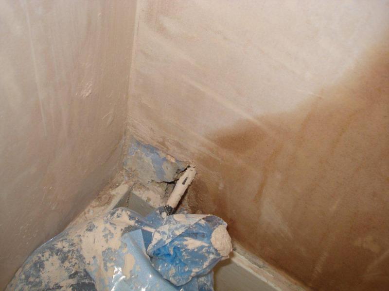

Ok it's behind the Rad - but I specifically asked for these to be filled in again.

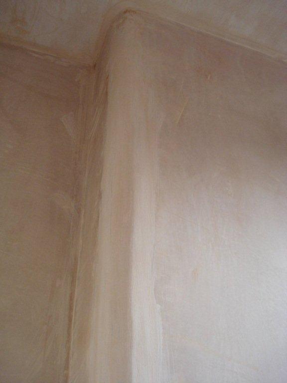

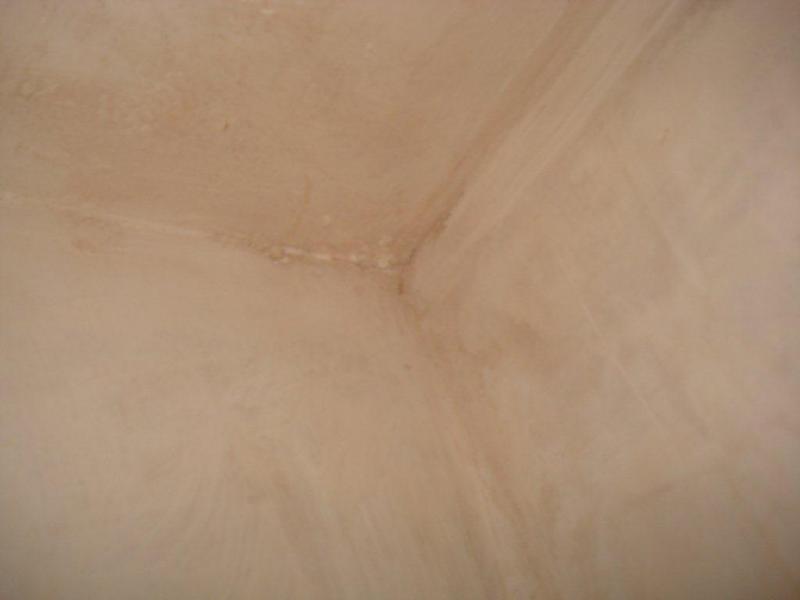

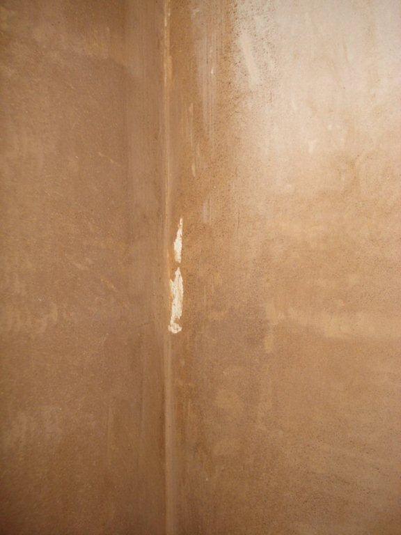

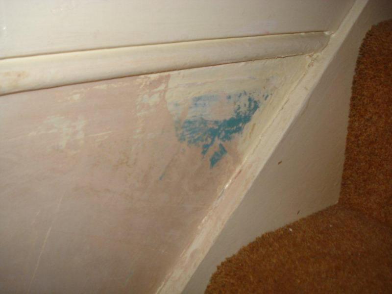

Can you see the roughness in that corner joint?
Plaster too thin. Doesn't cover the door frame and not flush with architrave. Same problem as the other one above.

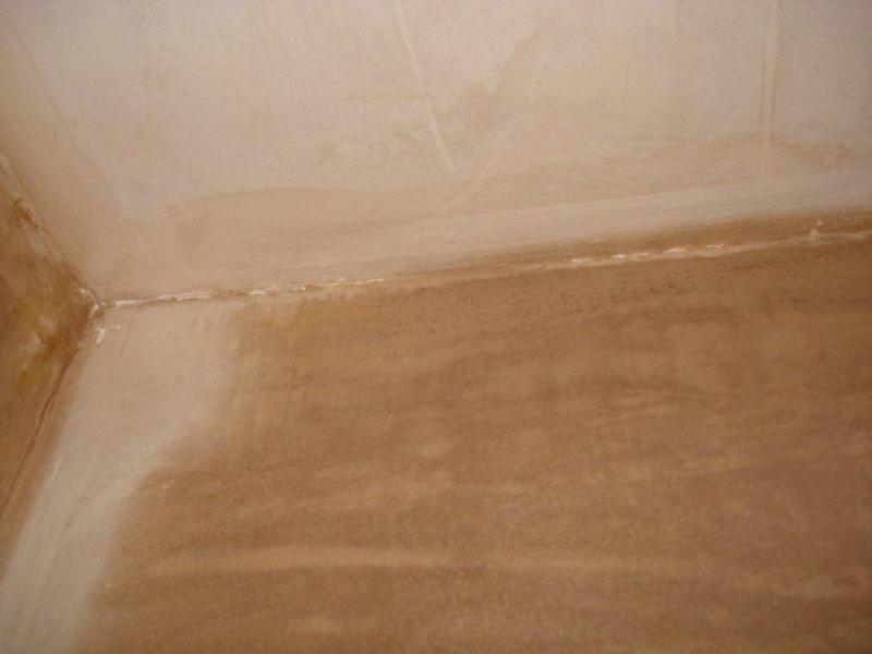

Lots of holes in the multifinish on the joint.

This rounded chimey breast is completely bumpy - I would have thought the plaster should be skimmed round.

I'll leave it up to the pro's on the board to answer how to remedy but suspect pva and a reskim in many instances.

As an aside, I notice you have a large fire opening there; what sort of fire are you fitting? I should warn you that Gypsum plaster (both base & finish) shouldn’t be used on the wall in the area around the stove. Unfortunately it won’t stand temperatures much higher than 50 degrees C & if you having a solid fuel stove in there, it will probably exceed that. I’ve measured temperatures well into the 90’s in the wall immediately surrounding a multi-fuel stove & exposing Gypsum plaster to temperatures that high will almost certainly see it crack & blow off the wall after a very short time.

Anyway - the stove to be fitted is a smokeless coal burning charnwood country 4 - 6kw stove. DOes this mean I need to bolster off the top and base coat round the wobbly edged fireplace? (The other horrible edged fireplace won't be used).
I would advise you don’t use Gypsum plaster on the wall within 500mm either side or 800mm above the stove & if that’s what’s on there, I would strip it back while it
it’s still a relatively easy job. Rather than repeat it all again, here’s a link that should tell you all you need regarding what to use.
//www.diynot.com/forums/viewtopic.php?p=1491201#1491201
Regarding the stripping back - what's the best way to do that?
Without any advice I would start off with a 1" cold chisel to isolate the affected area and move on in with a 4" bolster once isolated.
What's the correct way to finish off the joint between the plastered wall and the brick opening which I intend to leave exposed? In other words what I would consider is placing a wooden block flush with the bickwork and rendering and then plastering right onto that, before sanding it back to a smooth edge?
The problem with taking a chisel & lump hammer straight to it is that you can de-laminate the plaster in the surrounding area; if you’ve got an angle grinder, make a cut through the plaster first & then chisel away. I would be tempted to use a steel render stop bead but am concerned that the different expansion rates of the render & steel bead could cause it to crack away. You can render up to a timber batten & then finish off after but as timber is a combustible material, BR’s won’t allow it any closer than 200mm from the fire.
Sorry to keep throwing things up but I assume you are aware that installing a stove is subject to several Building Regulations & is notifyable building work unless carried out by a registered HETAS installer.
