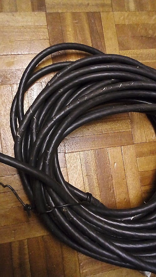

That piece of cable is about 2.5mm² and red, black. green cores so 50 years old.
I would have told him it was a hazard!
Think the flooring and the lead are a similar vintage...
I did and he eventually accepted it when I simply pulled a chunk off, to the point he accepted my offer to repair.
it is... in fact the floor is the $@*% Mrs Sunray wouldn't let me rip out when we made major changes to our kitchen

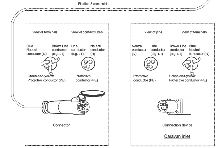

BS7671 does, indeed, say a minimum of 2,5mm² and a maximum of 25 metres, but it also says a maximum of 230V (or 400V 3-phase), and says absolutely nothing about 'yellow'. As for 'core colours' it merely refers one to Table 51, which gives the standard colurs we are used to,and the diagram of connections to a caravan refer only to a "Neutral", identified with blue. ...

As I said and illustrated, BS7671 talks about the Neutral in the supply to the caravan (identified by blue colour), shows a CPC in the cable and requires the supply to be RCD protected, so doesnt't seem to be talking about a non-earth-referenced isolated aupply.
