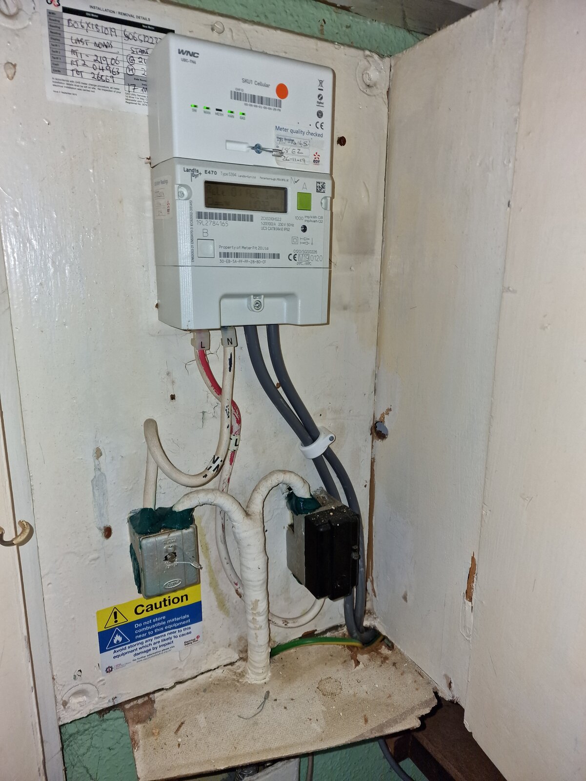

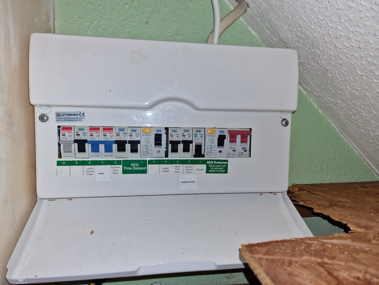

Bumping this thread with an updated pic of my electricity board and relevant wiring.
Off the bat, I see that the labeling is wrong: there's no water heater (GCH) and no electric shower either, not to mention the stickers are offset.

However the law says you need the bit of paper and you have the bit of paper, and anyone working on an electrical installation should isolate and prove dead before starting work, your CU has three ways to isolate, two RCD's and the isolator and I can't really see how anyone following the rules could be in danger even with wrong labels, they are so blatantly wrong, no one with even a small amount of common sense would take any notice of them, so can't see how they are a potential danger?

Well the new board has mixed manufacturers MCBs (that alone makes it non compliant afaik) and looks awful with the cover on, there's no time delay RCD. I don't understand why whoever fitted the board didn't use BG over Contactum, very odd.
The second electrician seems correct.

From what I'm reading the board was completely taken out (or all circuits) and then refitted - the right hand RCD has been reconfigured with 3 mcbs and the left now has 6. The labels are all over the place with gaps in between the MCBS whoever installed it was wrong to say it was satisfactory.
What's wrong with a mix of BG and Contactum though? Surely both of them do the same thing.
You could argue that having different manufactured MCBs there could be an undue strain on one make as they don't fit exactly the same when they are installed on the busbar - this could be one reason why the left hand MCBS aren't as neatly aligned as they could be. You asked for advice and any electrician could always be critical of another's work but in this instance I think it's justified for a number of reasons.
Below is the current Reg on the matter
536.4.203 Integration of devices and components. The relevant part of the BS EN 61439 series shall be applied to the integration of mechanical and electrical devices and components, e.g. circuit-breakers, control devices, busbars into an empty enclosure or existing low voltage assembly. In low voltage assemblies to the BS EN 61439 series, e.g. consumer units, distribution boards, incorporated devices and components shall only be those declared suitable according to the assembly manufacturer’s instructions or literature. NOTE 1: The use of individual components complying with their respective product standard(s) does not indicate their compatibility when installed with other components in a low voltage switchgear and controlgear assembly. NOTE 2: Incorporated components inside the assembly can be from different manufacturers. It is essential that all incorporated components should have had their compatibility for the final enclosed arrangements verified by the original manufacturer of the assembly and be assembled in accordance with their instructions e.g. the consumer unit, distribution board manufacturer. The original manufacturer is the organization that carried out the original design and the associated verification of the low voltage switchgear and control gear assembly to the relevant part of the BS EN 61439 series. If an assembly deviates from its original manufacturer’s instructions, or includes components not included in the original verification, the person introducing the deviation becomes the original manufacturer with the corresponding obligations
As Flameport has said BG MCBs aren't hard to come by so they've done it the wrong way untidily when it would have been easy to do it the "right" way should ring alarm bells about the stuff you can't see.
Both BG and Contactum are very readily available - so why a mixture was fired is a sign of laziness
