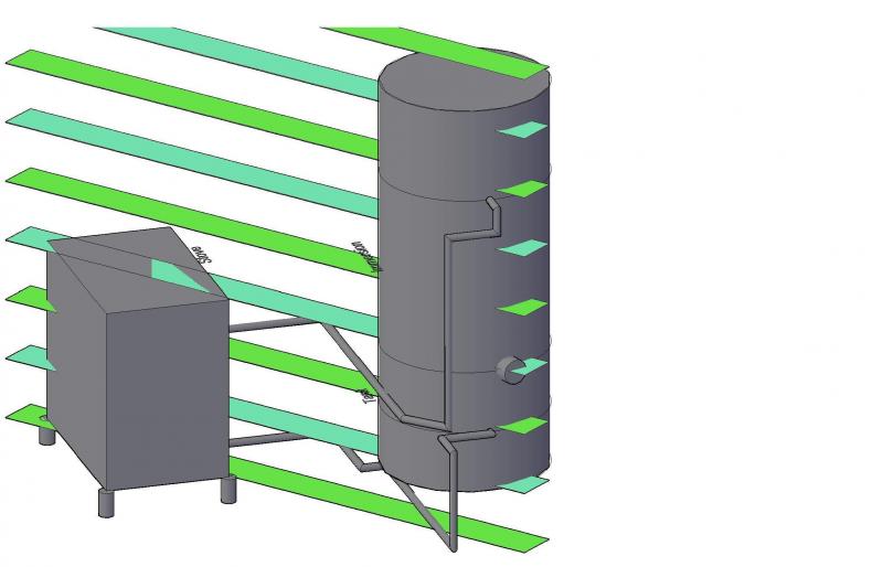

Thermosyphoning... how to stop it!

Here are the relative pipe runs to and from the stove. All drawn to scale..
H = horzontal
V = vertical
Pipework on flow from stove H450 - 90deg - H1100 - 135deg – H200 – 90deg – Vup800 – 90deg – H200 – 90deg – Vuo100 – 90deg H100 and into Tank
That is a vertical 900 mm rise from the outlet on the stove to the inlet on the tank and a total horizontal run of 1850mm. TOTAL FLOW = 2750mm of 28mm pipe
The return out of the Tank is 1050mm below the inlet and is 90deg – H200 – 90deg – H150 – 90deg – Vdown400 – 90deg – H900 – 90deg – H100 – 90deg – H400 – 90deg H450 and into the inlet (return) on the stove.
That is a vertical fall of 400mm and a horizontal run of 2200mm. TOTAL RETURN = 2600mm of 28mm pipe
Tank is 1550 tall, inlet 250 from top, immersion 800 below inlet, outlet is 250 below immersion and bottom of tank is 250 below outlet.
Diagram is at
Image is to scale in terms of pipe lengths and sizes, and vertical separations....
True scale 3D image showng piping layout. Green "plates" are 250mm apart to show relative levels of everything.
Note immersion on same side of tank as inlet/outlet.
Added later... actual tank is about 100mm shorter than shown, that height shown allows for "tails" for hot water on top.

Were the pipe connection issues ever sorted out as per ACV's recommendations?
The simplest way would be to fit a flapper check valve (non sprung loaded) in the vertical flow pipe as high as possible.
You don't show any expansion or heat sinks for the wood burner, what does the manufacturers instruction say about that.

Wouldn't a flap valve hinder the gravity circulation that is supposed to go the correct way round the system, we struggle to get the heat the stove is capable of creating into the store as it is...
F&E tanks, hot water feeds and rad pipes omitted for clarity.. ;)
Besides it took me long enough to model that up in 3D! LOL

Strangely enough it isn't dangerous, if he fits the right type.
It would be better if we had all the information, instead of leaving bits off, that are important.
If you follow that link it will stop the gravity circulation as it suggest.
BOTH WAYS

The first priority is the wood burner, not the cylinder.
A lot of the information is all there already.
His system was installed incorretly by a HETAS registered installer and is incapable of correcting his errors.
