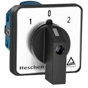

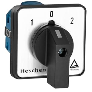

If you allow that 'off' is a 'way' ..........I simply sought clarification as to what exactly he meant by a "3-way" switch, given that no such thing exists.
It isn't. That would be 2-way and Off.
