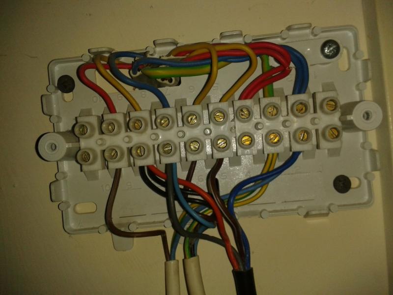

Sorry to come back so late on this post but I have only just got the actual wireless thermostat to fit. I was going to buy one ages ago but I was promised a free one that a Friend didn't need any more and it has taken this long to receive it.
The model of the Wireless stat I have now is Honeywell Y6630D1007 not the
Honeywell DT902E as for your instructions.
I have a couple of more questions if you don't mind before I start.
It was found that I don't have a permanent Live in my Junction/Wiring Box in my airing cupboard so I have to take my Live from my Boiler timer/programmer.
I can see the Live and Neutral connections on the Programmer and I take your instructions as I run a new wire from them to the Relay Live and Neutral?
I do have the wiring instructions for the new wireless stat but there are so many different wiring options I'm not 100% what I need.
Would I just carry on following your same instructions for wiring this new stat?
You said on the Programmer terminal 4, disconnect the wire and connect the wire to Relay B. Do you mean run a new wire from Programmer terminal 4 to Relay B or extend the current wire I have just disconnected from Programmer terminal 4 to Relay B?
Next step you say Programmer 4 to Relay A. Do you mean run a new wire between these points?
Then your instructions for the Junction/wiring box was to disconnect the wires to the existing thermostat (T2, T4 and T5) I know which ones these are because there is only one wire going to the T5 top terminal so it must be this one and the other two wires coming out of the same cable,correct?
You then say link T4 to T5, not sure what you mean by that, could you please explain again?
Again, I do apologize for asking again but it has been so long I wanted to make sure
I have included photo of Programmer back and Junction/wiring Box
You need to join L & N in the prog to L & N in the relay box.
Link L and A in the relay box. Remove wire from 4 in prog and connect to B in relay (use a proper cable connector). You will also need to disconnect the old room 'stat wires in the junction box and link the switch terminals.
Thanks for the reply.
When you say Link L and A in the relay box, I take it you are talking about L as being the Live that I have already connected to from the programmer? I just wanted to make such because the model relay I have has two L's. it has a block of 3 terminals together N,L and L.
When I disconnect the old thermostat in the Junction box do you mean put the two disconnected switch wires together in a block? would these be T4 and T5?
My other question is that the only sensible place for me to fit the relay is about 300mm below the Boiler. Do you think that will be OK? they say to fit to one side of boiler in instructions.
Sorry, i gave you instructions for programable stat, i think the one you've got is just a temperature 'stat.
So here goes, L & N to L & N as before.
DO NOT LINK L & A.
Remove wire from 4 in prog and join to B in relay, also as before.
You also need to connect 4 in prog to A in relay.
The link in junction box is a short wire that joins together the 2 terminals that the old room 'stat switch was removed from.
OK thanks, I think I have it now, I put a small wire in the Junction box to replace where I take the old stat from, linking terminals T4 and T5.
Yes it is only a Temperature wireless Stat.
What about placing the relay below the Boiler is that OK?
Hi,
I have fitted as your instructions but I think I have a problem.
The wireless room stat seems to be working, it connects with the relay and switches it on and off when I turn the stat up and down but I can not get the heating to start up even when I turn Stat up to 30 degrees it still doesn't kick in.
Any ideas?
My boiler is not starting up for the HW either.
Starting to panic now, might have to uninstall.
All the lights are working on the programmer but the boiler is not starting up.
Does it matter weather I link T4 and T5 at the top of the terminals or the bottom? I linked the top
Hmmmm.
Do you have a meter to test electrics?
It doesn't matter if link is top or bottom.
