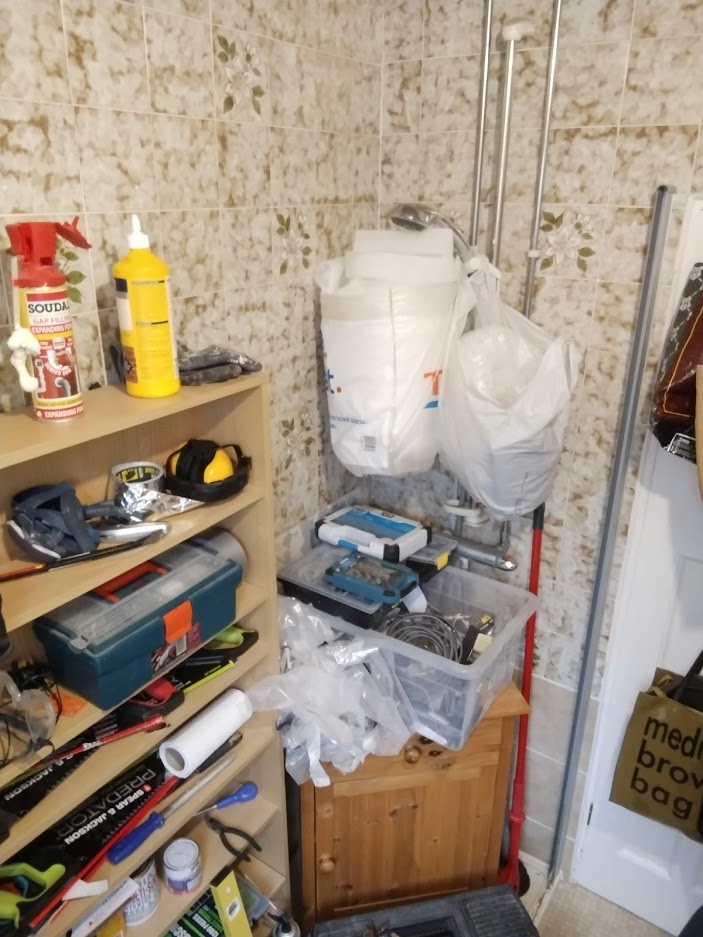

I am planning to rip out existing shower room and put back a bath. Currently there is hot and cold (from water tank) feeding a shower. We have 0.1 bar pressure on the hot. The new shower is fine like this, but hot water tank is not that big, and if we all (4) have shower at the same time we run out of hot water.
As this will be a bath mainly, and emergency shower, I was thinking better to have an electric shower, that way we don't need to worry so much about running out of hot water.

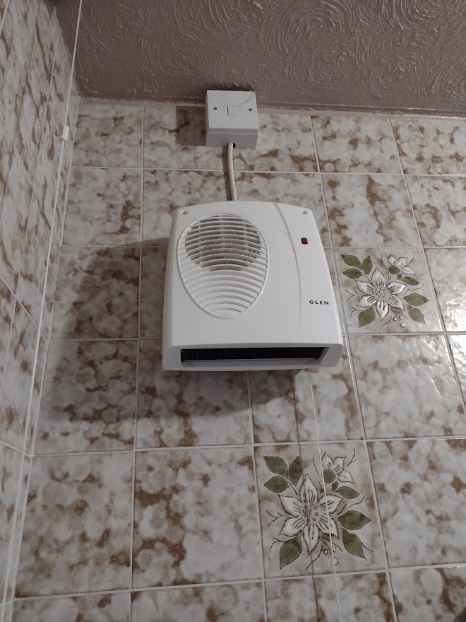

The room currently has an electric heater on its own circuit, which I am planning to remove once the room is insulated and new rad installed.

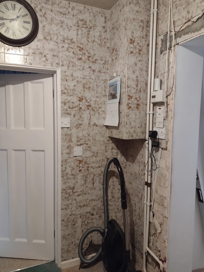

Thoughts? And could a sensible plumber install the electric shower, or do we need to get an electrician to wire it up? And ... crazy idea, maybe, are there electric showers that sit on the other side of the wall, with just controls on the bathroom? Because I plan to box in the area on the other side - the cold pipe can run down here too, and maybe if the shower was in a cupboard there, that would keep things looking tidy, and maybe make the electrics easier too.

You need a feed from the Consumer Unit, proper cable as the shower will be 8kw or more.
Ours was done by an electrician and signed off.
Thanks, that should be easier enough to do. My electrician will probably suggest running a new cable anyway.

the cable feeding the switch for your heater is looking like its already too small, wired incorrectly and is working off a 6amp light switch which is wrong and already overloaded by the heater.
Is the Cold water from a TANK , Electric showers usually need to have a mains pressure to operate - Do you have mains cold water supply in the bathroom OR is it feed from a TANK - and also 0.1Bar pressure ?
The spec for the screwfix shower is MIN 1.5bar pressure
The wickes one only says -
  • Suitable for cold mains only
and does not give the min pressure
