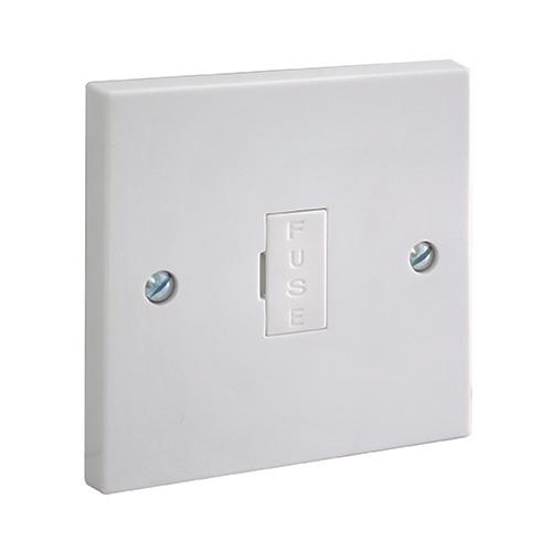

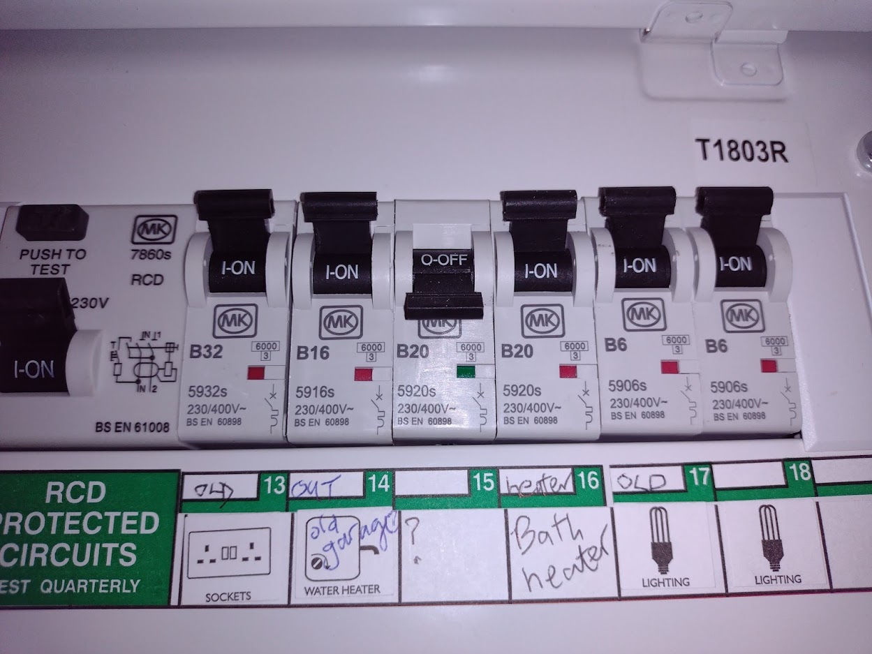

the cable feeding the switch for your heater is looking like its already too small, wired incorrectly and is working off a 6amp light switch which is wrong and already overloaded by the heater.
It's on it's own circuit on the consumer unit, but it getting removed either way now
Those wall fan heaters are usually only 1-2Kw and the white cable that's feeding the heater from the FCU will be the cable that's supplied with the heater, so can't see anything wrong with that as long as the fuse in the FCU is correct. The pull string will be how the wall heater is normally switched on an off, see them all the time.
disagree, it’s clearly switched via a 6amp light switch above it. which may or may not be fed via the pullcord as you suggest . unless it’s a shower pullcord then we can assume it’s on the lighting circuit fed by a 1.5 or even 1mm cable on a 6 amp circuit breaker.
not suitable for 1kw let alone 2
I've already said it's not on the light circuit, it's on its own circuit, so no need to assume otherwise. That other pull cord is the extractor fan, and the light switch is outside the room on the wall.
It might not be ideal (I really don't know) but it is definitely not on a light circuit, and nothing else is on its circuit. But if no use for a shower then it will be replaced anyway.
#16 B20 - heater
1.5mm² or even 1mm² (which should only be used for lights) are more than adequate for a 2kw load.You could actually wire up a 3kw immersion heater in 1.5mm².

Which switch are you referring to?
Can you please give us a close up picture of the white box that is above the wall heater in pic 2.
One person is saying it's a light switch, I am saying it's an FCU. Can you also please tell us where that white pull cord that's hanging underneath the heater is coming from, is it from inside the fan heater?
