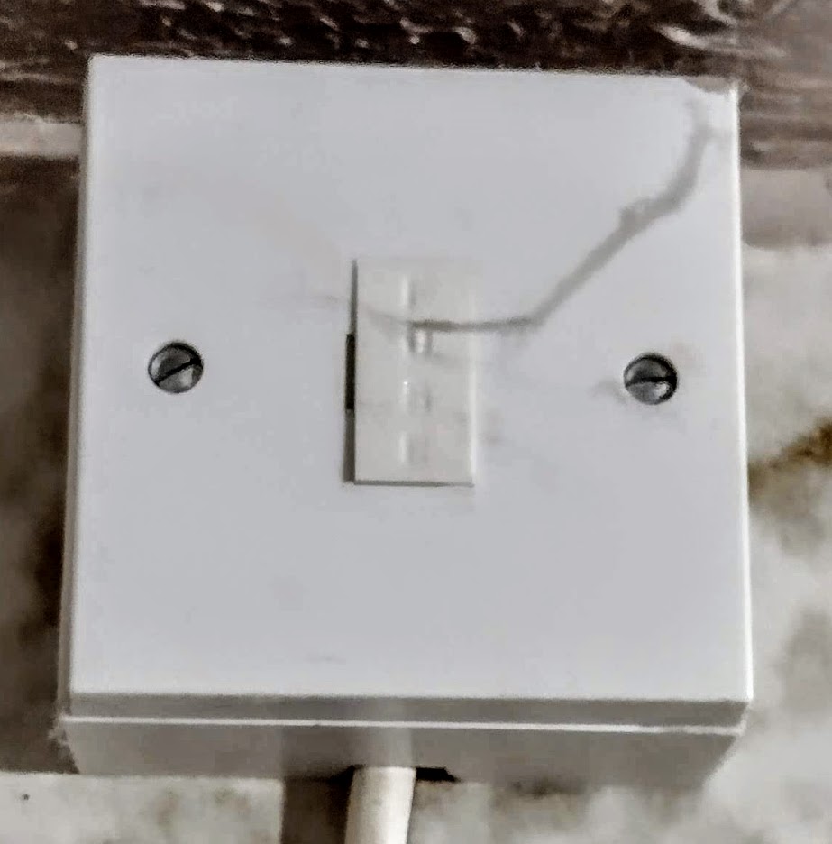

Can you please give us a close up picture of the white box that is above the wall heater in pic 2.
One person is saying it's a light switch, I am saying it's an FCU. Can you also please tell us where that white pull cord that's hanging underneath the heater is coming from, is it from inside the fan heater?
The pull cord is part of the heater - it looks like one of these

disagree, it’s clearly switched via a 6amp light switch above it. which may or may not be fed via the pullcord as you suggest . unless it’s a shower pullcord then we can assume it’s on the lighting circuit fed by a 1.5 or even 1mm cable on a 6 amp circuit breaker.
not suitable for 1kw let alone 2
It's not a 6A light switch - it's an FCU sitting on a 20A radial. It's not a light pull switch, the heater is fed by it's own factory fitted cable switched on and off via it's own internal corded pull switch, which is normal for a fan heater that is IP designed for use in a wet space, it's so someone won't come into wet contact with a switch and is more than acceptable.
As far as cable capacities are concerned I think you want to go and do a bit more investigation about standard T&E current carrying limits, you may be surprised. 1mm2 is quite capable of carrying the 8 odd amps that a 2Kw heater could draw.

my aoplogies for mistaking the fcu for a normal plate switch.
