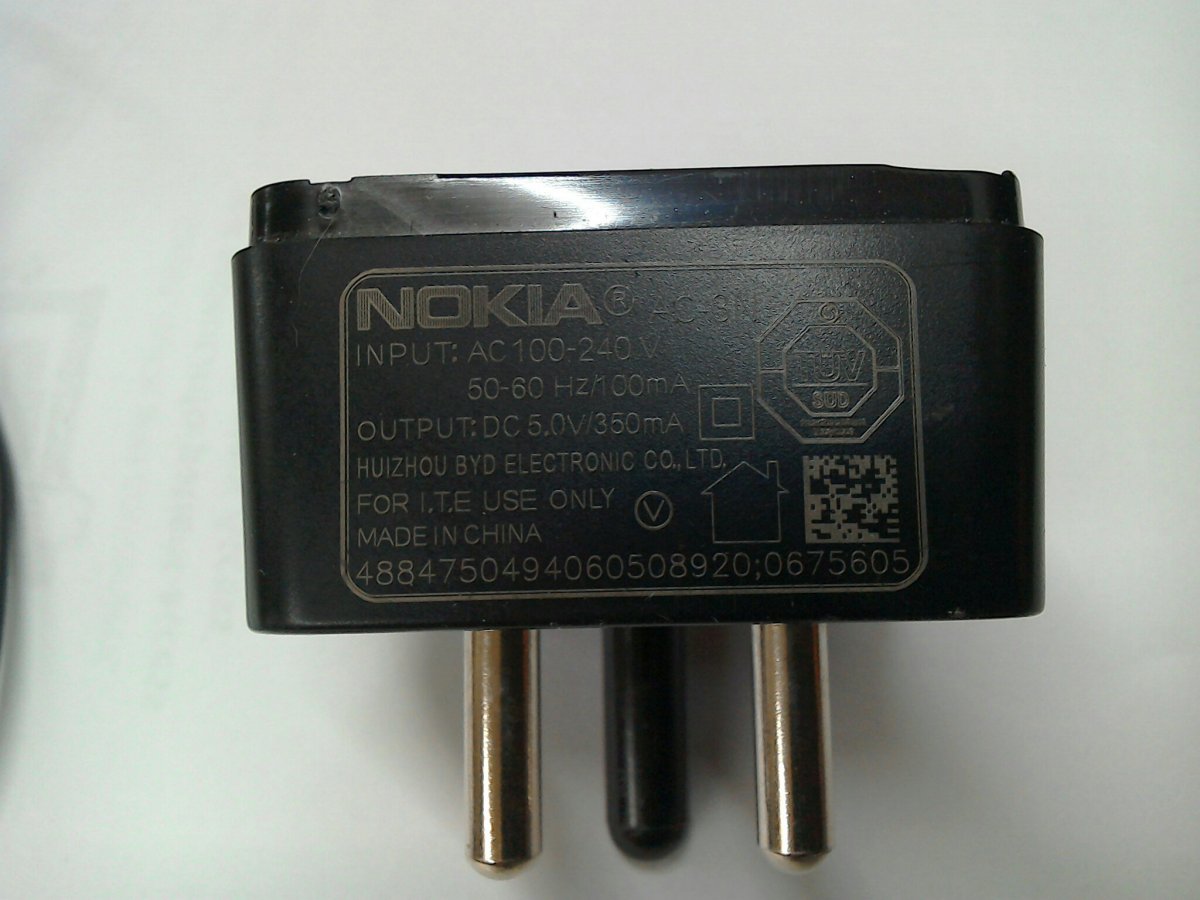

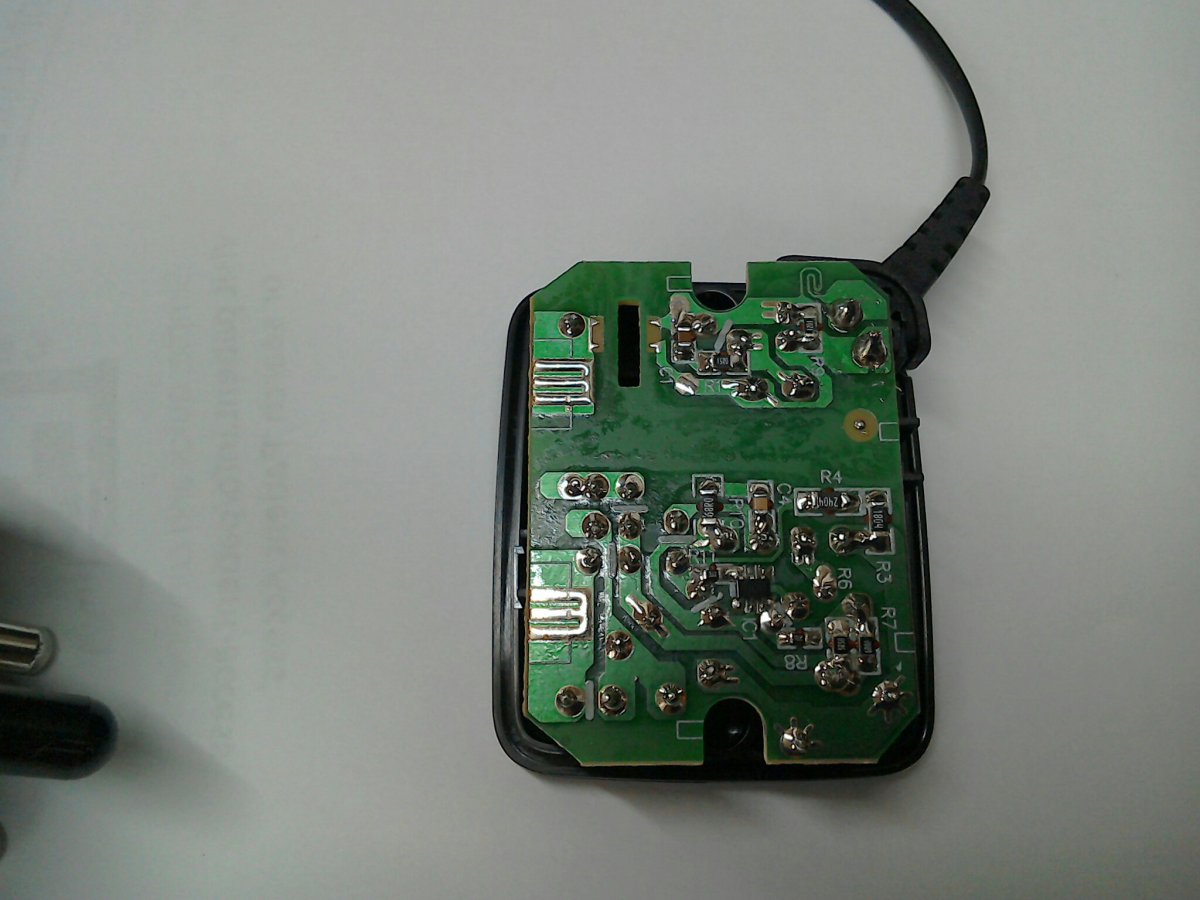

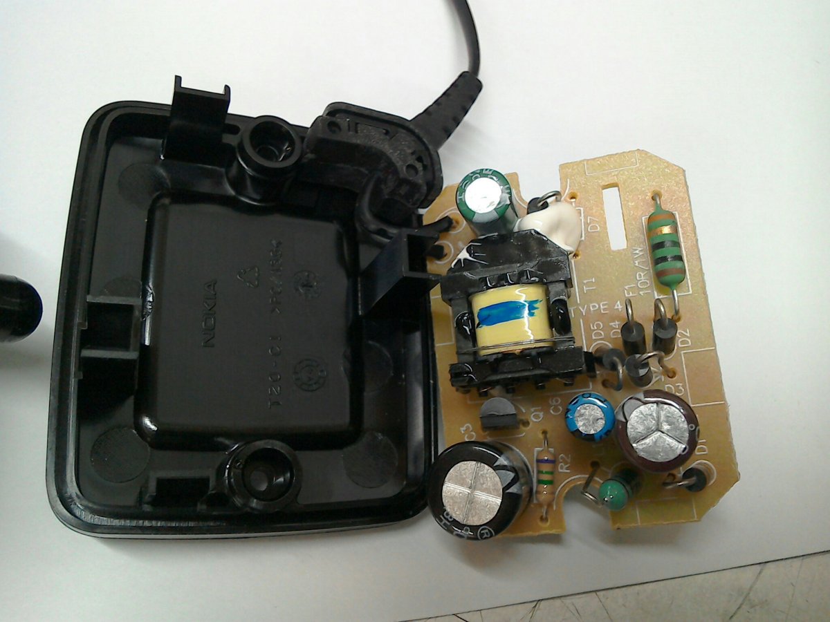

Switch Mode Power supply in Nokia charger, as for public its just a phone charger, they need not know it has SMPS circuit inside. (I took one apart today just to see if it really had some sort of SMPS or was it a simple capacitor charge transfer device that may not provide true isolation, well i was wrong and this shows that a small SMPS can be packed in a housing as small as a plug top.
Note it is just under 2 watt SMPS providing 5v at 350mA (actual 1.75watts)
the small HF Transformer provides mains input to output isolation. It does not have a fuse but a fusable 10 ohm resistor, there is No provision for any RF filtering in it that i can see. It was from one of my tenant who came over from India and left it behind so you will notice it has no CE marking. And the plug has Indian round pins. As it has no filtering, it would most probably be illegal to use in UK.
Can anyone explain the mechanism which would have resulted in it having such filtering if it had been identified as a SMPS on the enclosure?
It doesn't have to have.
Maybe it would.
Can anyone explain the mechanism which would have resulted in the owner not using it in the UK if it had been identified as a SMPS on the enclosure?
