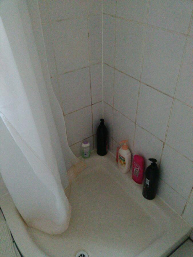

I rented out our house August 2016. Three months prior to renting I refurbed the ensuite shower room (not big) by stripping out the original dob and dab non moisture resistant plasterboard and replacing it with 12mm thick marine ply (which was sealed with PVA), new tiles, new grout with tile sealer. The whole ensuite was tiled along with another bathroom with the same tiles, grout and sealer.
The new tenants were in only 2 months and complained to the Letting Agent that the grout was all of a sudden stained in lowish areas of the shower area and how should they clean it. Advice was given by myself via the Agency but with a warning not to use anything abrasive. I also asked for pictures of the affected area of before and after any works they carried out.
The before shots showed there was low level slight brown stains in some of the grout but the grout seemed to be intact and unbroken. To me it looked like someone had tried to use fake tan and then tried to wipe it off but some of the stain got onto the white grout.
The shower is an overhead non removable type.
A month after the tenants 'cleaned' the grout, the agency took more pictures (via a 3 month inspection) the top layer of grout was missing and/or cracked and the stains although reduced, apparently kept appearing.
I immediately pointed out to the Agency that this was damage caused by over cleaning and that it would need to be resealed by the tenants straight away. Basically nothing happened regarding my complaints.

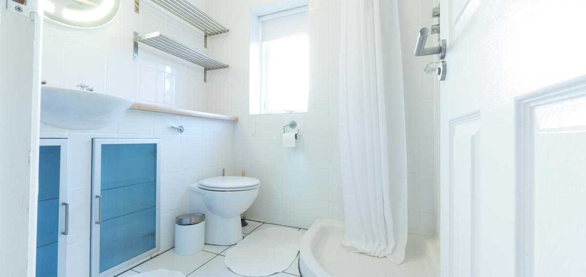

Just to augment my original description. I had created a panel on the other side of the wall to get to the shower thermostat, controls and pipework so I did not have to destroy the bathroom to get at any pipework. This had been checked 1 week prior to the tenants moving in and was dry and sound.
This what it looked like in August 2016 and then in November 2016

You should not have used plywood, its unsuitable. Only remedy, remove tiles,replace ply with aquapanel or similar and re-tile with suitable adhesive and grout. Sorry, what you have is a horrible botch job.
Oddly enough, Looking at the bottom of the shower, and the condition of the shower curtain, it looks more like the tenants aren't bothering to clean the shower much. But there's no hard and fast rule on this one. Water stains will always be greater towards the bottom of the shower, and if it it staining from the plywood, then it might well be lower down where more water strikes, or it could be expected to be more even over the whole shower area.
The contractor has said that he needs to replace the tiles to stop the staining, but doesn't mention what he intends to do to the plywood prior to retiling. Nor does he mention where he thinks the water is coming from to make the plywood damp. He's either trying to get work, or doesn't know what he's doing. Retiling will do nothing if there is an actual leak somewhere. And whilst it might have been better to use something hardier than plywood, I'm not convinced that it's that that's causing the problem.
Grout isn't actually waterproof, it's more water resistant if done properly, but it does stain easily if left damp. I assume that you meant grout sealer in your post, and not tile sealer, but I haven't use it, so can't comment. If you're sure that there's no water leaks anywhere, then you could use epoxy grout to try and combat the tenants laziness, but I'd get someone else to do it, or just accept that tenants don't bother ceaning the shower, and it'll just beed regrouting when they move out.
And looking at the picture, I can't see where there's any difference in the grout to indicate it's been redone.
See 5hit like that in hard water areas.
Agreed. It's on the bottom of the shower curtain. I get it in my shower because our water is like rocks up here in North yorkshire. I squirt masses of bleach around every so often. Stinks like hell for a bit but gets rid of the brown stuff. The calcium that collects on the hot pipes and taps is another matter.

The second shot was from the inspection done about the end of November, according to the Agency who took the terrible picture, the grout looked like it had already been scraped with something. Then after my advice to fix the grout to the Agency who seemed to not pass on my comments to the tenant or their contractor, the January inspection and really bad photo looked like there was barely any grout left in places but yet the tenant was still using the shower.
The pipework area seemed dry to me from the bottom al the way to the top and into the loft where the shower head goes.
I would have assumed if the pipe work was leaking it would have shown a stain in the ceiling below which is the hallway. This would have been way before the staining on the wall.
I have no pictures from the latest contractor (April 2017) to take a look at it so am not sure if it has been redone or even if he went over there. His appraisal of the job and costing was made (according to the Agency) via that 2nd picture and never went to look at it in person. I found this out yesterday.
I suspect he went over there to quickly cover up the grout what was left of the old grout with new grout. I assume this as the person dealing with our house is on holiday and she sent her email at 7pm the day before she went on holiday.
