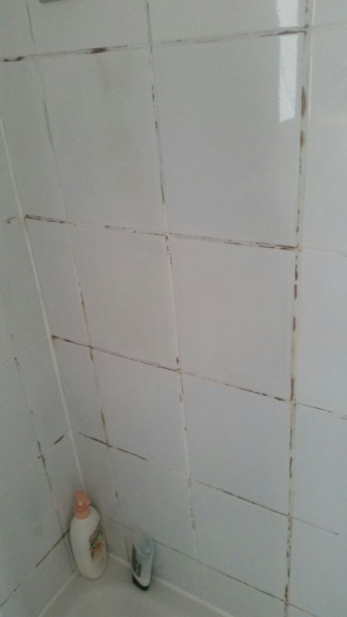

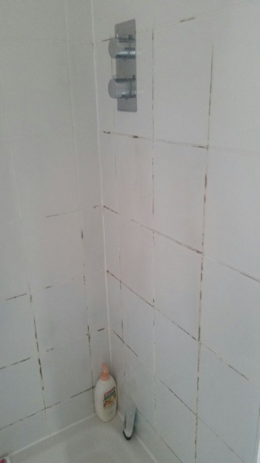

The first contractor went over there and allegedly after he re grouted the shower area.
These pictures are from the tenant as the contractor did not bother to take any pictures himself as requested.
To me, it appears the first contractor went over there and just bailed as, to me, there has been nothing done from the first contractor.
To me, it looks like the top layer of grout is quite heavily missing and is now exposing the adhesive underneath but without a really detailed shot and a few close ups this is all conjecture.

definitely a mould problem and with it being so bad so high up the shower and so uniformly spread I would say it is being caused by the plywood backing, but I am surprised it has got so bad so quickly.
The problem is ply can harbour mould spores and in a confined damp unventilated situation such as behind tiles the mould can grow and spread.
Many years ago before I knew any better I tiled a shower onto ply, last year after nearly 20 years I ripped it out and the ply behind the tiles had a fair bit of black mould on it, but in fairness it hadn't penetrated the tile adhesive very much and hadn't come through the grout.
To be fair your best bet will be to rip it all out replace with tile backer board, use decent powder adhesive and a decent mould resistant grout and grout sealer or even as suggested a two part epoxy grout.
To be honest its not a massive job and a decent tiler would do that in a day, probably £2-300 worth of work.

I found 8 cracked tiles, grout routed lines in the grout and on the tiles. Dremel tool swirls over a further 7 tiles and the edges of nearly all of the lower tiles wore back and/or chipped which is why the brown areas in the photos looked much much worse.
The tenant did finally admit that he attempted to dremel out the grout to fix the staining which was a hair dye his girlfiend used which had also stained the floor tiles too. But he never replaced the grout he removed, he painted it with grout paint from Homebase!
The agency workman who went over there to repair the problem also used a dremel and then a groute router in which he broke tiles and compounded the wear to the edge of the tiles.
There were 4 tiles in which something super abrasive had been used which completely took off the top layer if the tile surface.
He then covered up the hash up with new grout non water resistant grout, including a lot of the hairline cracks he created when trying to route out the grout with apparently a hammer and screwdriver, evidence of this could be seen by the end of the small screwdriver tip stuck in the grout as it had broken off and the was grouted over.
I could also see that the dremel router tool got away from him a few times as there were swirly marks and scratched tiles from a routed line in the grout.
WTF this guy was on I have no idea.
So with this in mind I decided to strip the broken tiles off the wall.
All in all 32 tiles were damaged, scratched or broken.

Its not best practice to use ply or PVA on a wet wall, but that was not the cause of your simple troubles - Ply & PVA are not guaranteed to fail.
And if they had failed in your enclosure, then they would have failed differently from what you say & show.
In your case, I'd suspect that moisture penetrated the grout, and perhaps the sealant.
The pics showed fresh silicone sealed inside corners, and a small amount of fresh grout renewal.
The smudgy stuff looked like, and the pattern was consistent with, mould.

The sealant was old. The mould looking stuff was tile edge and tile dirt caught in the new grout mixed with wet PVA stain in there too.
There was miminal mould in only one place.
