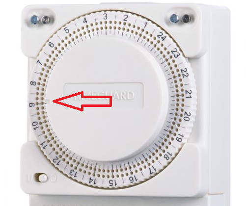

I have the below timer switch which doesn’t seem to turn off correctly.
Can this be swapped to one where you push the pins in/out around the circumference or is the one below better? It’s an old flat so not sure if the below is better or worse than others.
Doesn't matter which type it is - if it works properly.
That one works with pins around the circumference.
I've used that type and they usually work well. It looks as if there are only 4 pins, so you can have two on times set and two off times set each day.
I have used both types extensively and find both give very good service, if anything I prefer the pin type as it's easy to miss one of the little levers being not quite in or out etc.

The one I have turns on but not off. Also it says to set the time from the left hand side (9oclock) but seems to switch when the pin gets to the top (12 oclock) for some reason
Show us a pic of yours, clearly showing the pins position, please.
Yes please
There is a marker and showing the time and switching position, are you sure you are using the correct ring, inner for on and outer for off?
There is also a minimum time period of 3/4Hr IIRC
Some versions (presume different make) don't move the little lever across which I found very confusing the first time.
½ hour works fine. One cannot do ¼ hour with that type (without modifying the pins!), since the pin heads are too big to allow it.

I'm sure mine was clicking over when the pin reached the top
I'll post a photo when i'm next at the flat..
I got it to turn on ok but it failed to turn off when it reached the next pin. I may have set it wrong though so will upload a photo
I've had a little play with an old time switch too. I've found that an on period of ¼hr doesn't happen, it won't go on, however in some positions of the pins (2 drill bits) I can have a ¼hr off period but not in all positions.
So no it can't be used under ½hr, and no I haven't tried ½hr

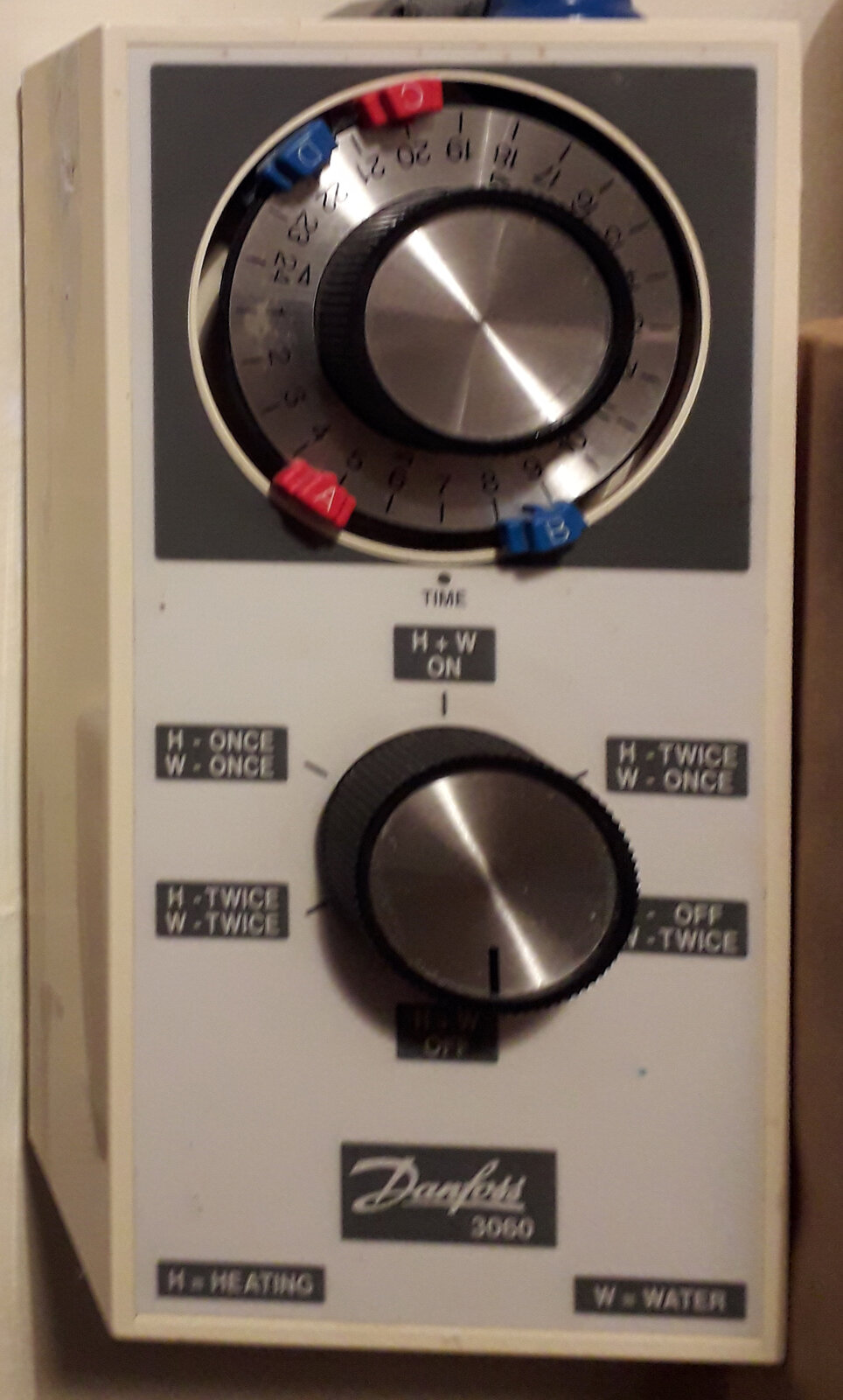

My domestic water heating needs around ¼ hour a day with a 19 kW boiler, but the thermo syphon needs around ½ hour to get going, I have no tank thermostat, so only option was ½ hour every other day, so to be able to set it needs a timer with a week not day timer, so my old mechanical timer Danfoss3060programmer.jpg was replaced with an electronic one, in my case Nest Gen 3, however for an immersion heater with a built in thermostat at only 3 kW not 19 kW then 6 x ¼ is an hour and a half, as I found out, once hot the cylinder stays hot for over two days, so only reason for a timer is to use off peak power, OK there is an exception, the Willis system, but that is rare to find on mainland UK, only the Irish seem to have worked out how to use it. We are too tick.
