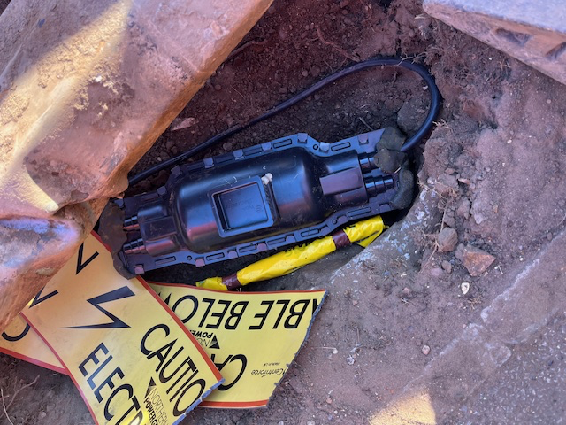

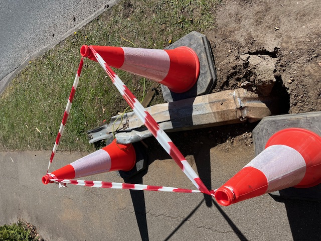

could you make a steel lamp post live ? since its pretty well earthedNo the national grid is 500A which is what the mains is for the lights. The actual lights are fused down to 6A, If a car knocks them down as they do quite frequently, the actual mains cable will still be live, it would be rare for the main substation fuse (500A) to blow. It is the same with your house, you have a 500A main incommer fused down to 100A or 60A in your cutout. You might blow the 100A fuse but you wont blow the substation fuse.
yes you can have a live lamp post, it is quite a common occurancecould you make a steel lamp post live ? since its pretty well earthed
yes very easily, we have special ppe to protect us from receiving a shock when we deal with such situations.Sounds dangerous. But I know nothing about electrics. Would it kill somebody?
Yes and no.Sounds dangerous. But I know nothing about electrics. Would it kill somebody?
but are they not well earthed by virtue of being concreted into the earth ?yes very easily, we have special ppe to protect us from receiving a shock when we deal with such situations.
We dont have RCD in street lighting, the earths regularly disconnect either by rotting or breaking off, in the event of a car colliding into them the first to be ripped out is the earth.Yes and no.
The lights will be earthed to ensure any fault currents doesn't stray on any part of the metal body. PEN fault detection will be there too.
Failing that, RCD or some other typr of device is your friend.
No earths are in the street lights as far as an earth goes, they are fed purely as Live and Neutral direct off the grid. The earth that we put in is purely to turn it into a PME supply but a lot of the time this is fine under normal conditions, however when a car hits the post they are ripped out of the ground leaving just a live and neutral wire. They just sit there fizzing.but are they not well earthed by virtue of being concreted into the earth ?
or would the flow to earth never be high enough to trip the 500a fuse
500A is a lot, 240v ? if so 120,000 watts (40 kettles)
As you would know, a 10mm bonding conductor is usually connected to the MET just inside the door opening. Surelyt the 'bond' is there to negate any difference in potential between the DNO earth and the column in the ground under fault conditions.No earths are in the street lights as far as an earth goes, they are fed purely as Live and Neutral direct off the grid.
