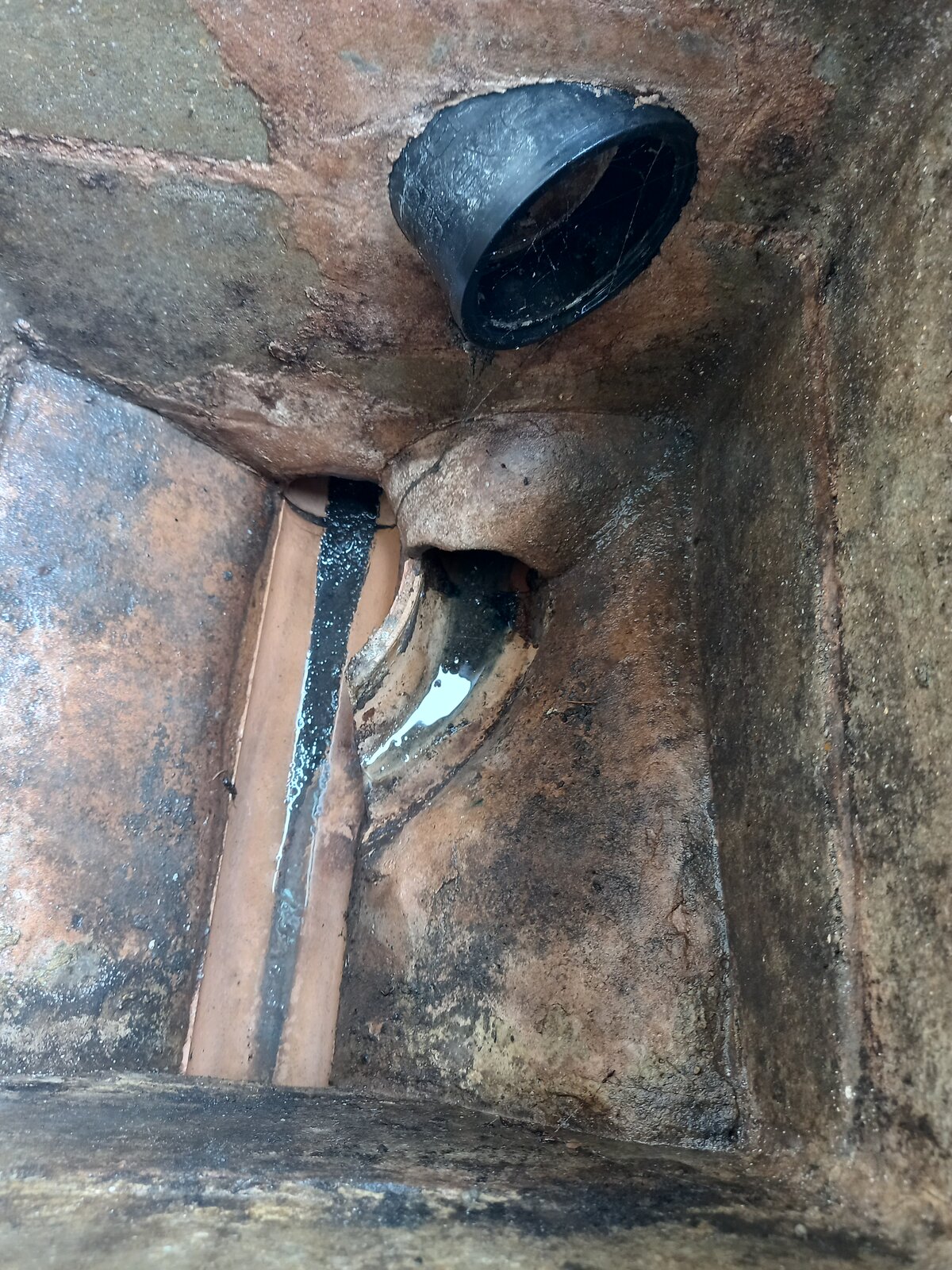

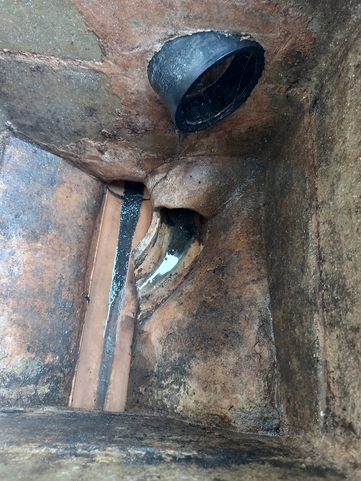

Toilet backs up to almost rim level when flushed, sits there for a short while and then flows away with a 'clonk' type noise. Particularly problematic in the morning after a night's-worth of loo paper and the occasional no.2 having sat in the pan all night. Not really an issue with just no.1s.
Any ideas?
I'd have thought if it was a blockage, a reduction in diameter of the outlet, then it wouldn't push through at all on it's own accord? On many occasion this is in fact the case, needing to 'plunger' a few times with the loo brush.
Could it in fact more likely be an air-blockage?
Thanks for any ideas.

Check inspection chamber nearest house. If it's clear get someone to flush some toilet paper down the offending toilet and see how long it takes to come through. If only water comes through, (probably at a slow rate/trickle), then you have a blockage upstream. If the chamber has water in it then you have a blockage downstream. If the next chamber is off your property, (i.e. outside the boundary), I believe it is the responsibility of your water supplier or possibly local authority sewage dept.
Lifted the chamber cover and yes, soil waste is coming through ok. Had my wife flush it. She did say though that, even with just water and probably no more than two sheets, the water did rise slightly before flowing away.
We do have about 300mm of flexi-pipe from back of pan to the soil stack. Could this be the issue? The corrugations trapping the waste and building up over time? I assume if so, the solution would be to replace the pipe rather than try to rod it, via the pan, risking poking a hole through it?

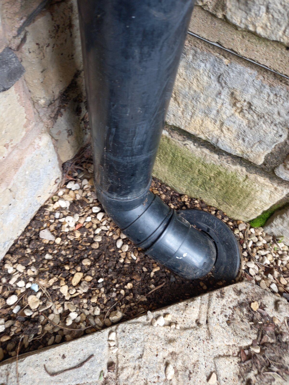

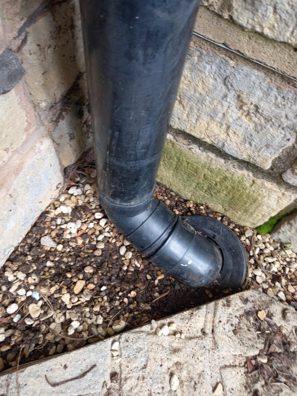

As a side note, what is the large black plastic pipe, probably 6" dia, coming into the same chamber just below ground level (the waste outlet and channel is deeper at about half a metre down)? I thought is may be rainwater but, sticking a hosepipe into the guttering above, nothing came through it.
Is it a shared sewer? Second loo?
Don't think so. I did wonder if it was the drain-off for the rainwater but as I say, nothings coming through it when it rains. Or at least, when I stick the hosepipe in the roof gutter.
