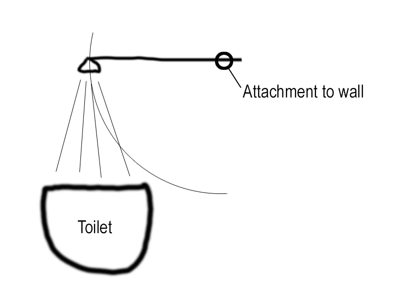

So if I place the hose so that it's spray can reach into the toilet but the 'head' itself cannot actually go into the toilet, then it's ok?
Correct(ish) - if the hose is short enough to prevent the head touching the pan, no backflow prevention is required. You'll have a hard time washing down the side of the pan nearest the hose in that situation though...

Oh I think we manage. This diagram demonstrates how our spray can be directed to any poo deposits in the toilet bowl, yet the spray head cannot enter the toilet bowl. That, of course, is assuming that we actually have such a spray! :D

Regardless of the backflow protection, they are not WRAS approved, so they're not allowed to be installed directly on the main, them's the rules, it's not complicated.
