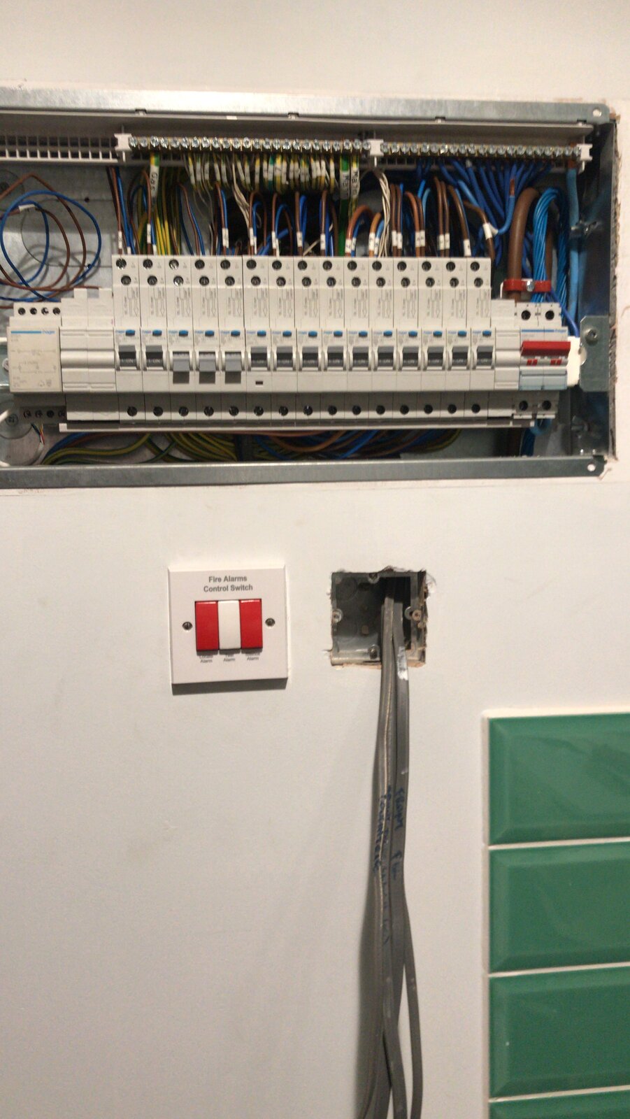

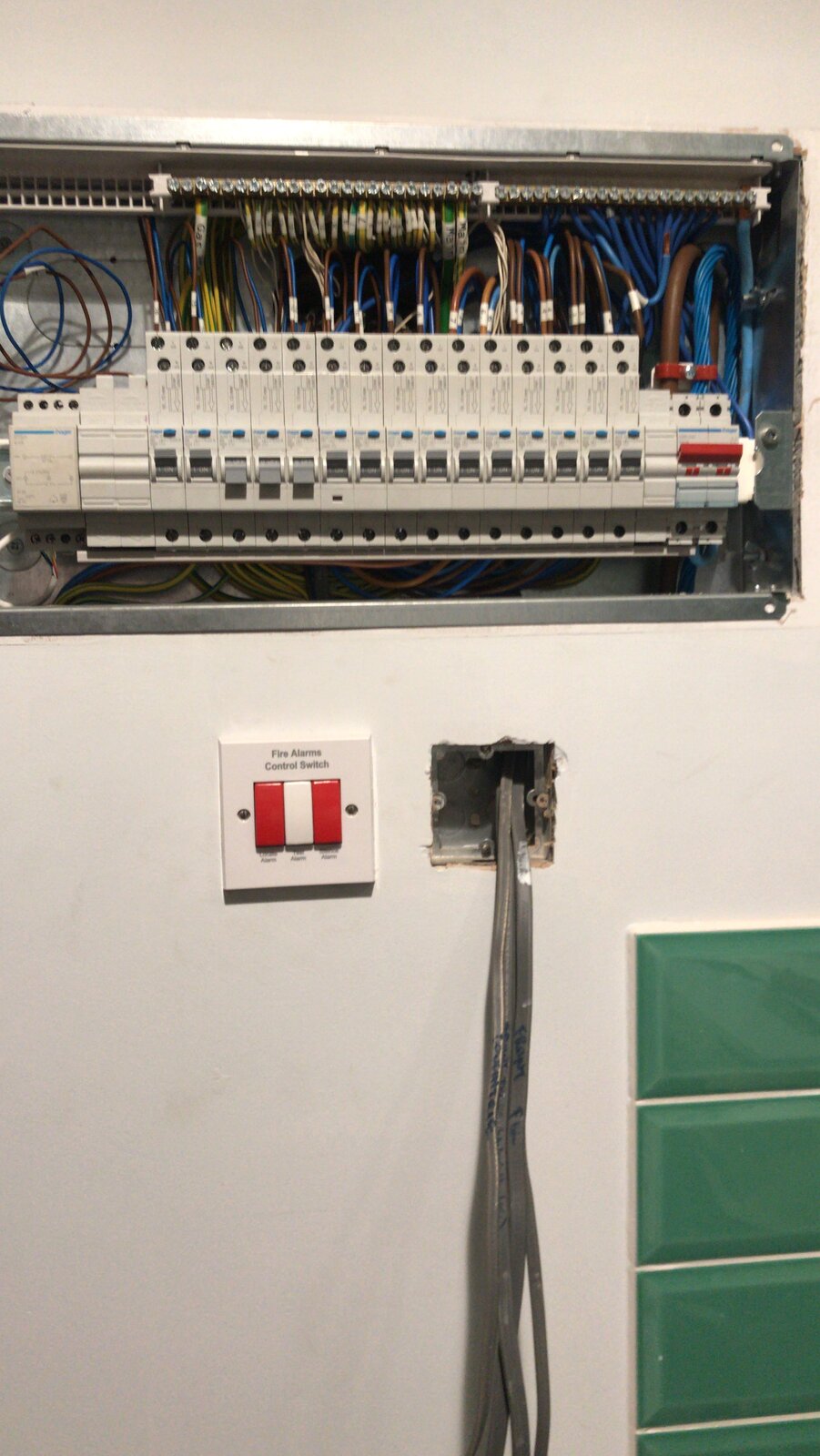

Too many circuits?

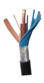

Is that a neutral tail made up of loads of individually twisted cores?
The board is fed with a 25mm² split concentric cable.
If you’re not familiar with it, it’s a 25mm² live conductor surrounded by 11 insulated wires which equal 25mm² to form the neutral conductor, and 4 uninsulated wires which equal 16mm² to form the CPC.

OOI If you're rewiring are you only considering final finals? Would radials be a consideration?
I will do a radial for the loft
I will also consider doing a radial elsewhere (after a bit more thought/research) as there appears to be a few posts questioning wherher a ring is required in all the places I'm proposing

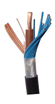

Definitely not familiar with it :)
Is that a similar kind of cable to the DNO feed that comes into the home? In what scenarios would it be used to feed a consumer unit rather than a set of "standard" tails?
