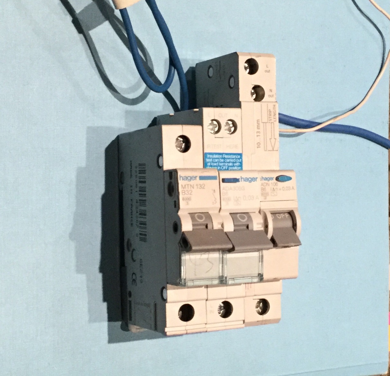

What 10 way consumer with RCBO would you guys recommend?
One comment: it’s easier to make a tidy job if there is plenty of space. RCBOs take up more space than MCBs. If I were you, I’d get a significantly larger enclosure than you need for the circuits.

Quite a lot of manufacturers are now offering compact RCBOs which are not much bigger than a circuit breaker.
These are Hager flavoured ones.
Circuit Breaker, Compact RCBO, standard RCBO
Nice. I see they also have the two outputs next to each other, which avoids the need to fish around round the back to find the hole for the neutral.
Unfortunately, mine is MK.
The neutral fly lead 'supplied' connects to the neutral terminal in the board.
It's not 'two outputs', more of a sensing wire.
