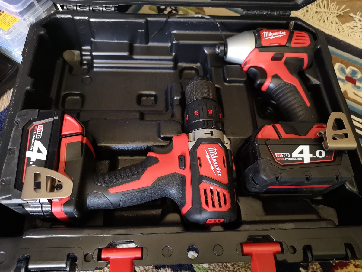

I used to be a kitchen fitter when I was 18, many moons ago, it was all corded them. The Milwaukee is great but I wanted a corded one just for using with metal work. I found the batteries run flat so wanted an normal drill to use with a wire brush etc. The Milwaukee isn't past it, no. It is nearly new but for the job I was doing with 2 batteries it wasn't enough so made me think about a corded percussion drill. I love their stuff but as you say the cost is inhibitive for tools I may seldom use.
WOW - those look brand new
Going again my son-in-law has a lot of the Milwaukee bits and drills
BUT we also rate the BOSCH MULTIPURPOSE DRILL BIT, i have used to put up shelfs, and various jobs outside lights etc , But we also used to put 10x 2 gang sockets on garage wall and so far neither have needed hammer action, BUT the dewalt drills do
i have used my Dewalt Impact Driver & Drill making and putting up a gate - using 2x 3Ah batteries, lasted all day , also we put up my son-in-laws 8'x10'; shed using hes dewalt 4Ah batts and lasted all the job.
So i think you are good to go with that drill - and maybe a cheaper corded one as a backup just in case all the batteries run out , but you could buy a couple of spare batteries
