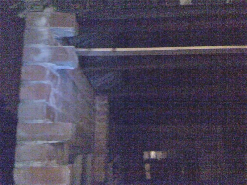

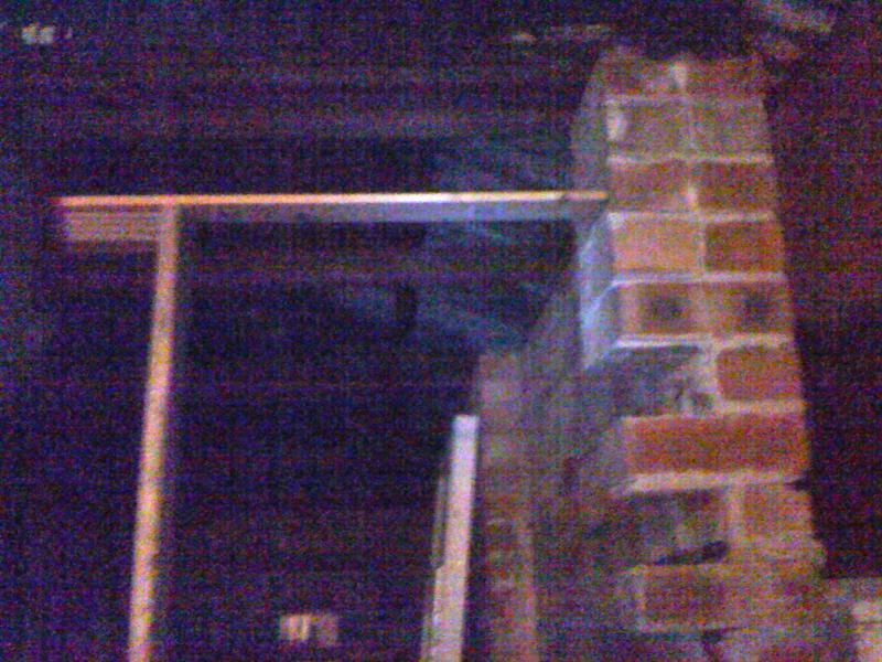

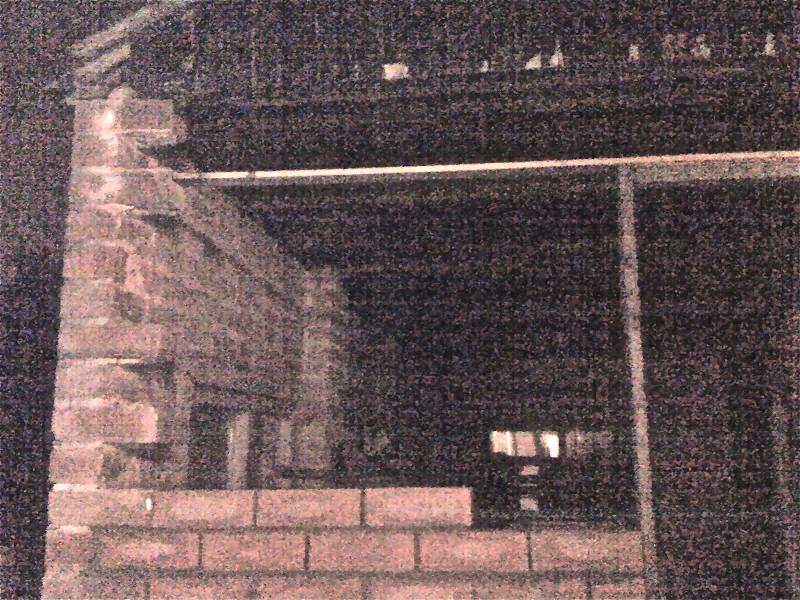

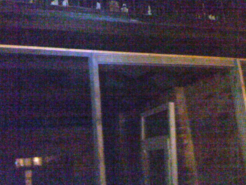

I have put a board across the top of the door frame so you can see, apols for the photos my phone doesnt have a flash and the torch was crap.
So you can see how the courses lie.
I seems like it might be about an inch and a half out.
hi Stuart,
on the left hand side its about .5 inches low of the second course and on the right hand side it appears to be about 1.5 inches. So the right hand side looks to be a little lower than the left hand side.
When i put the level on top of the board the bubble is right in the middle so its defo level.
How do i fix it to put a lintel on?

To get it looking a bit better, one method would be to use a soldier course cropped to bring the brickwork level with the top of frame. When the brickwork is high enough set up the line at top of frame and work along cutting the soldiers so they are laid to the line and level with the top of frame. It won't look perfect but is probably a better option to splitting a brick course. You will need to lay another cut soldier course over the top.
It really depends on what will look the best, and soldiers cut don't look so out of place as a split course.
Oldun may have another trick up his sleeve, although it might require a hawk and wooden float.
Hogey, Sorry only just seen your post. Have read the whole post through again half dozen times, and afraid that the brickwork is at a height now that there is no way of making it look right.
Stuart has given you the only possible way of making it look somewhere near right, but even a good bricklayer would have a job doing this to make it look even half presentable, as you need to bump up on the left hand side to get a soldier course in to bond height, and this will mean that you will loose course height on the courses below. It is easy to say in hind sight, but this should have been sorted out before first brick laid.
Hogey, if it was mine, I would tooth in as best as possible each side and get each side up level to top of frame, even if it means a course of headers to bring it up to frame level, fit lintel, finish to height required and then render the whole front.
Render can be left floated finish and painted or ashular effect. You can even render false quoin blocks to each corner. Render can be made to look very attractive.

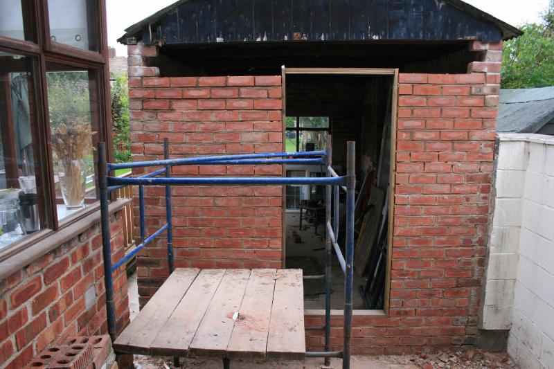

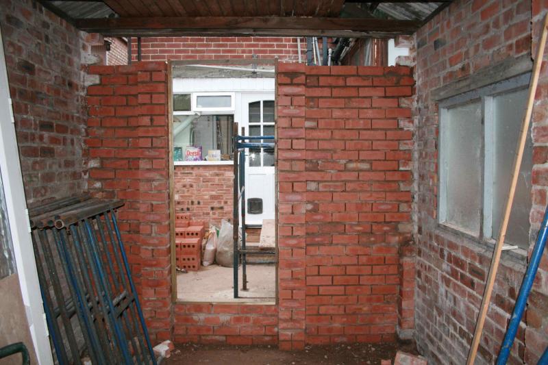

hi all,
I have finished the wall to where i think it should be before the last course and the lintel, the results are thus attached.
Please can someone advise how to move this forward i need to put a pike (the triangle bit on the end of this wall and then I will roof the building.
if it where you what would you check next
