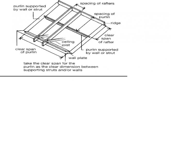

Hi Stuart,
Just wanted to say thanks alot, that brilliant. Its really helped to see it on a drawing.
Cheers :D :D :D

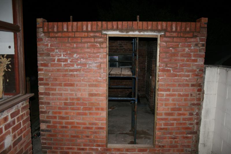

Hi there,
I finally did it today, doesn't look too bad I dont think.. just thought I'd show you seen as you helped
I used a lintel though as the whole thing is going to be painted with masonry paint anyway.
thanks
C
Looks alright to me unless you are actually looking for it. Which no one will be.
Plus you could completely disguise it by sticking a mini porchey-canopy type thing over the door.
You have done a good job hogey from a difficult situation. Good idea from Deluks as well about the canopy.
Are you building a brick gable end above?
