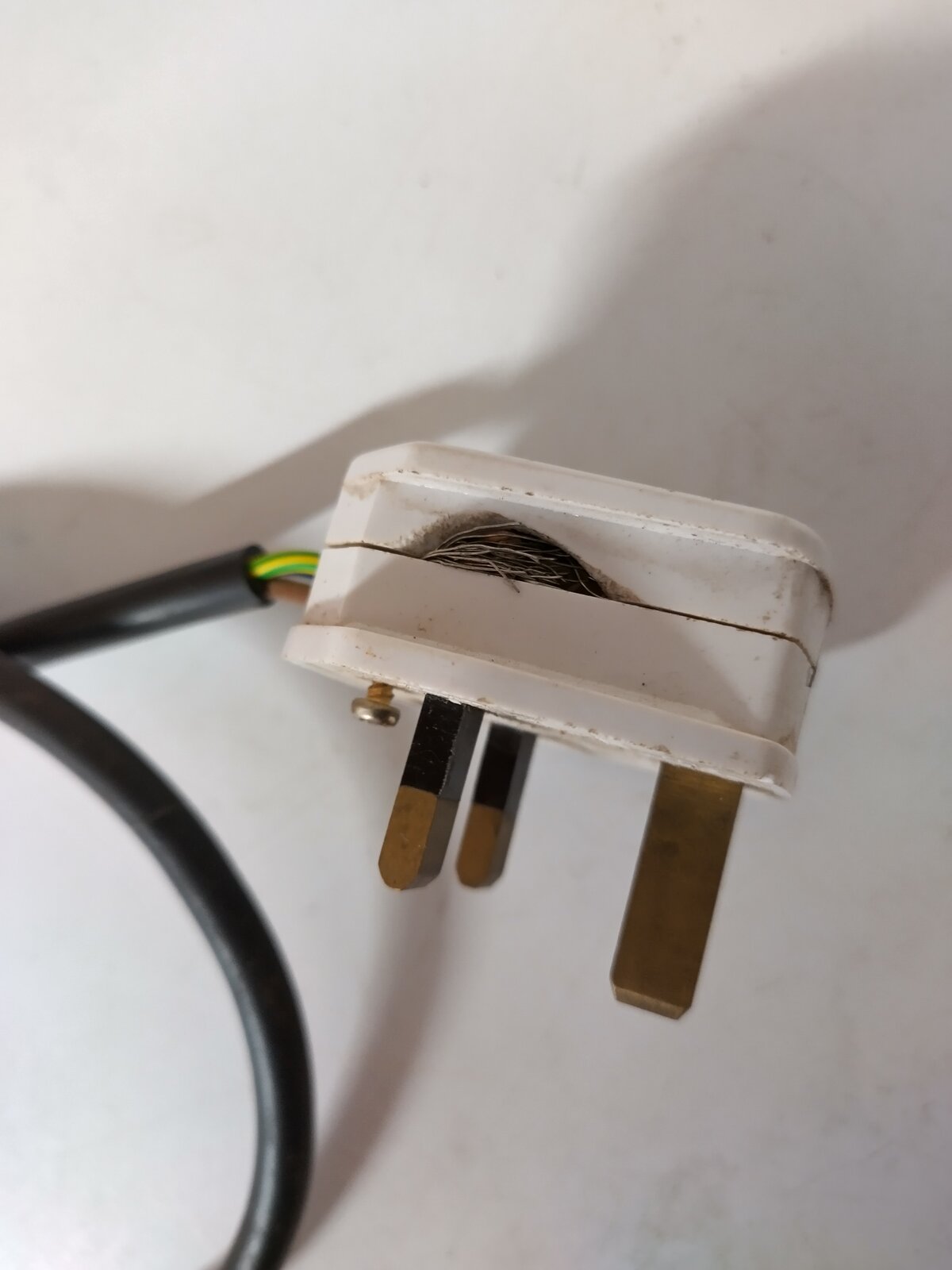

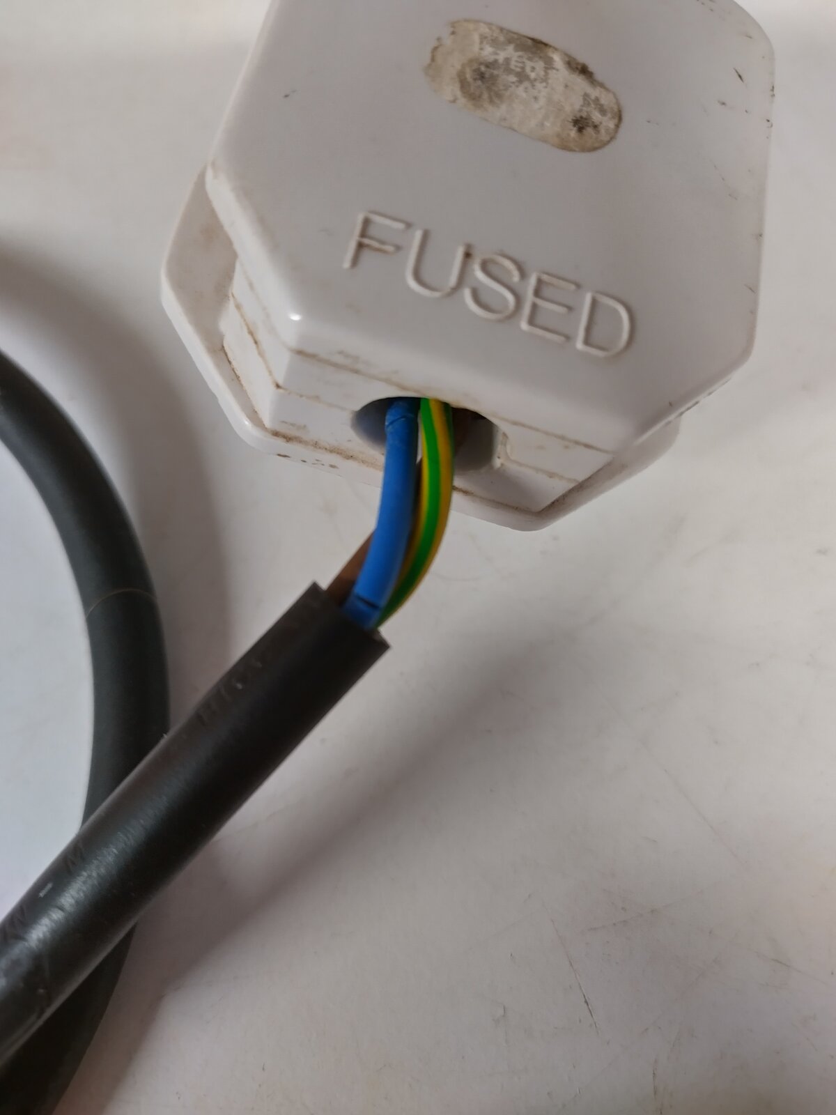

This is the kettle lead belonging to the elderly lady.
What first caught my eye were the conductors hanging out of the bottom.
Then I saw the cut in the neutral conductor.

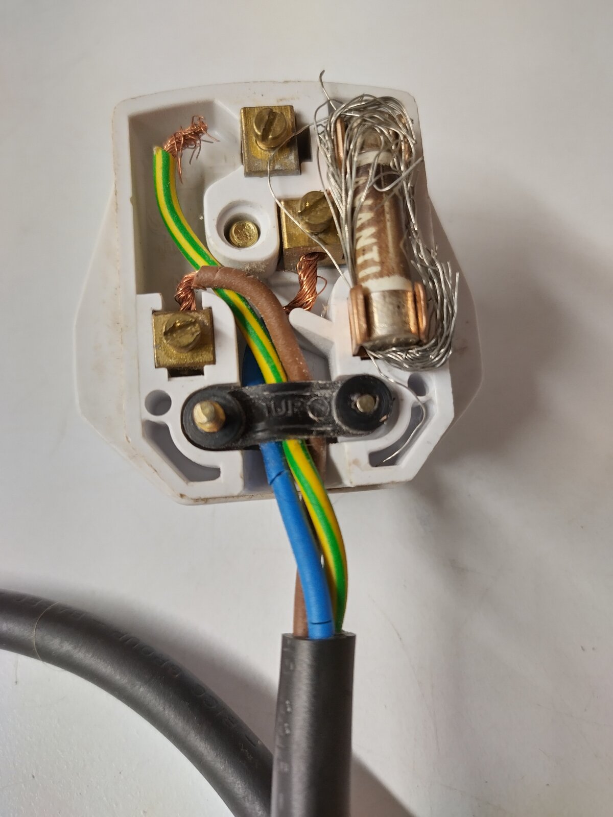

I switched off the power as I had a socket to replace in the kitchen. After checking the other side of the kettle socket for dead, I removed the kettle plug.
Not thinking this could get any worse, I opened up the plug.
I couldn't quite believe my eyes!
What first caught my eye were the conductors hanging out of the bottom.View attachment 313706
And I take it that was still working too?
Oh yeah. In service daily. I put it in the van immediately and went and got the lady a whole brand new kettle.

Was the strand from around the fuse actually touching the earth pin at the time, or was it being held off by the partitions in the plug top?
The benefit I have from PAT'ing the same areas time and time again, is luckily, the number of surprises like this, tends to decrease over time (although it never entirely disappears).
As I said, I had been using the lead as a teaching aid. The top has been on and off and the lead handled many times. It wasn't originally shorted on the earth pin, no, but it was shorting to the live terminal, thereby bypassing the fuse.
