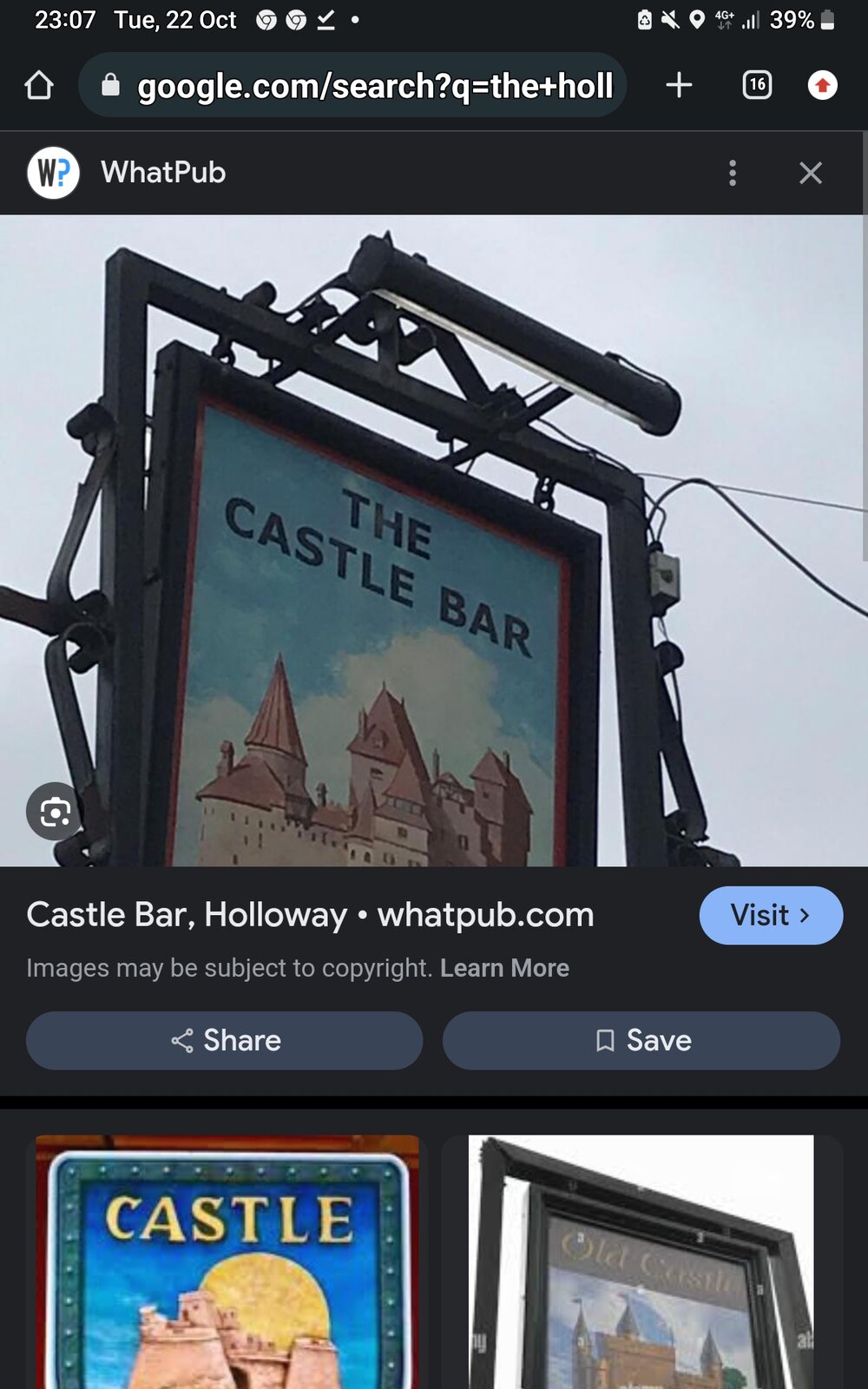

I done a pub swingsign about 30 years ago with 1.5 yellow artic flex on a 10 metre catenery.
I still drive past it, the cables now black from London traffic and most hangers have broke or bunched up and the flex is sagging, but still hanging in there, though not sure if the lights still work.
Just see it on the Internet pic
