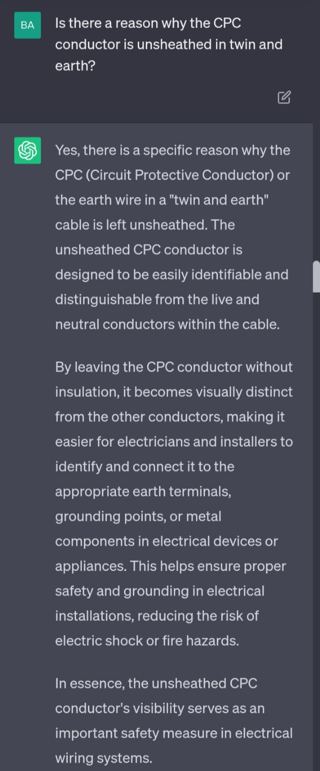

I do like to ask ChatGPT for an opinion, when these sort of questions appear! :)
Good for you ;)
I presume that explanation must 'come fromsomewhere' -so I wonder 'where?'. If I were an electrician (and even given that I am not), I'm not sure I would be too impressed by the suggestion that I needed the CPC to be bare in order to identify it as such!

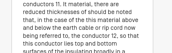

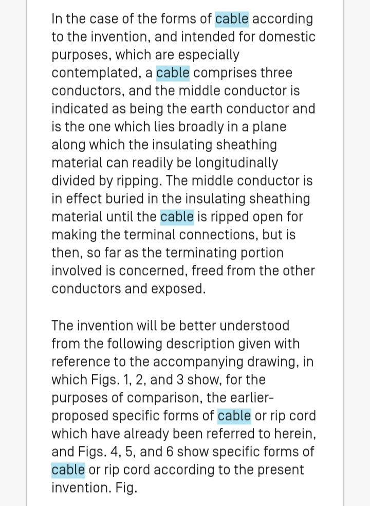

Perhaps that wasn't the best quote to pull out, but it is mentioned elsewhere in the link, that the middle conductor is used as the rip cord and this is assumed to be the earth conductor. I.e.
I suppose you are very probably right about the intention/implication, the actual wording is not particularly clear/explicit in eitehr of the passages you have quoted, namely ...
...the middle conductor is in effect buried in the sheathing material until the cable is ripped open for making the terminal connections ....
.... and ....
... the earlier-proposed specific forms of cable or rip cord which have already been referred to herein ...
n your first quote, and ..
... this material above and below the earth cable or rip cord now being referred to ...
...in your second quoted section. Although perhaps implied, neither actually say that the CPC is used for the 'ripping'.
Interestingly, whilst the first of your quotes used the words "cable" and "conductor" in a manner that would be regarded as 'correct' today, this second one refers to the bare CPC as "the earth cable" ["or rip cord"].
