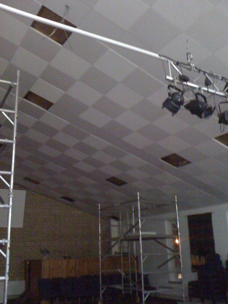

As an aside, a lot of lighting bars use metalclad 15A sockets with the wiring run internally to a JB on the end.
In this one they've stuck a dimmer unit directly on the end of the bar. At my 6th form, we had JBs about that size and a multicore cable linking the JB to the fixed wiring (8 circuits/bar and a lot of singles in trunking back to the control room).
Here's a closeup of what is common.
Can't see what the OPs hall has from the photo.
EDIT: Looks like they've used loose rubber sockets on the end of flexes, yuck. The photo isn't really clear enough, but I can't see any safety chains/wires on the lights.
