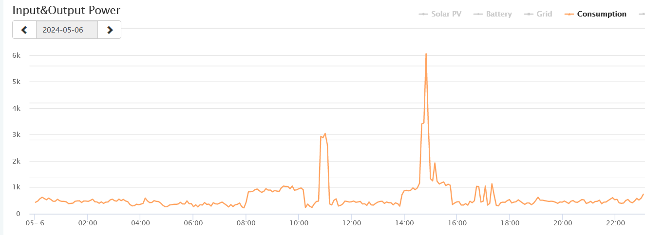

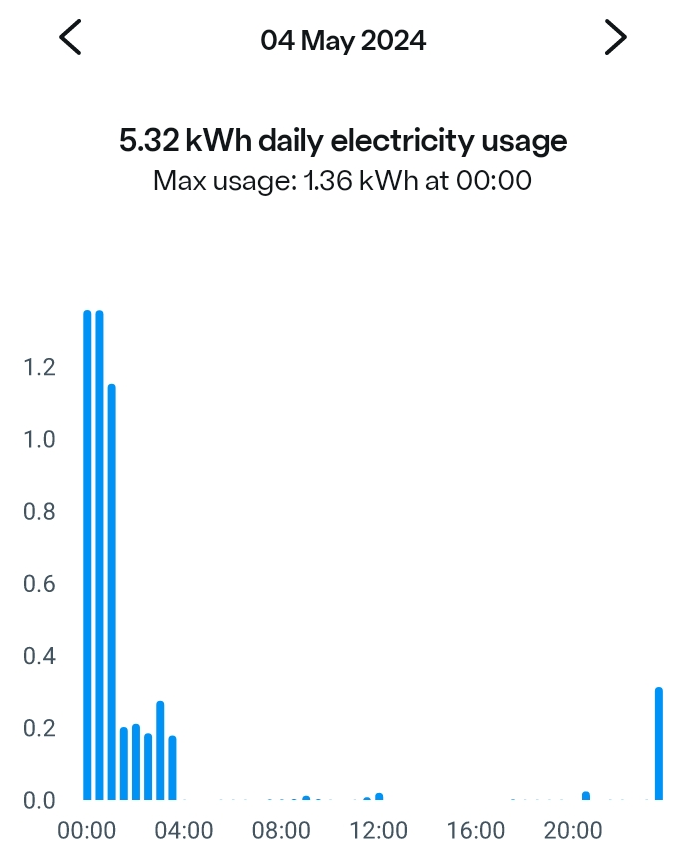

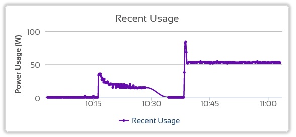

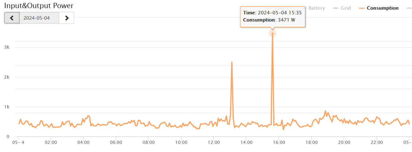

I've checked the smart meter and I don't think I've ever seen the washing machine or dish washer draw anything close to 2kW each - more likely about half that.
I have since solar has been fitted also looked at power use, 1715065606325.png peak of 3471 watts is not shown on the smart meter app 1715065771108.png and the peak shown on smart meter not shown on solar app under consumption as it does not regard recharging batteries as consumption. The two charts selected to show same day, one would not think related to each other.
I note with the solar there can be a delay of 5 to 10 minutes, and also seems to be some odd readings with the IHD (in home display) my power meter works better for a single items to see what it uses, Honda battery first switch on..jpgthis shows a battery charger, but problem is time, recent usage is only shown for around an hour, and once one goes to average hourly use it rounds things off, however the point is more does it matter? It takes time to heat up a cable, fuse, or trip, so short peaks hardly matter, what we are trying to avoid is prolonged high power overloads, so really only the immersion heater, room heaters, and tumble dryer of items using 3 kW or less are a problem, the rest either has dedicated supply as over 3 kW or runs for a short time.
