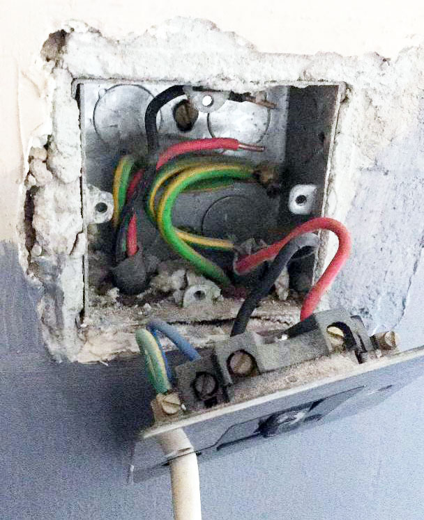

I have lightened up an image of the FCU back box which shows the 3 earth cables, its not clear in the original.
So with regards to the loose live conductor in the Socket, would the fuse constantly trip if that conductor is part of the ring mains? Beyond terminating that conductor, is there any other basic diagnostics I could carry out?
The terminal strip come in 3A, 6A 16A, whats best? And is it okay to put two into an adjoing block or should I split the block up into singles and cap them independently. Thanks!

16 amp connector blocks ,seperate into individuals .
I can only see two grey sheathed twin and earth cables coming into the back box ,but 3 green/ yellow sheathed conductors ,is the third just loose ?
yep there is definetly only two grey twin+ earth, no idea where 3rd is from... Will check later but should i leave on back box as precaution?
It appears that one of them disappears where the grey cable comes thru the grommet ,it may just be loose and at some point been a flying link to the FCU's earth terminal.
Others may disagree, but in the current circumstances I think it would not be terrible to wrap the loose ends in insulating tape.
