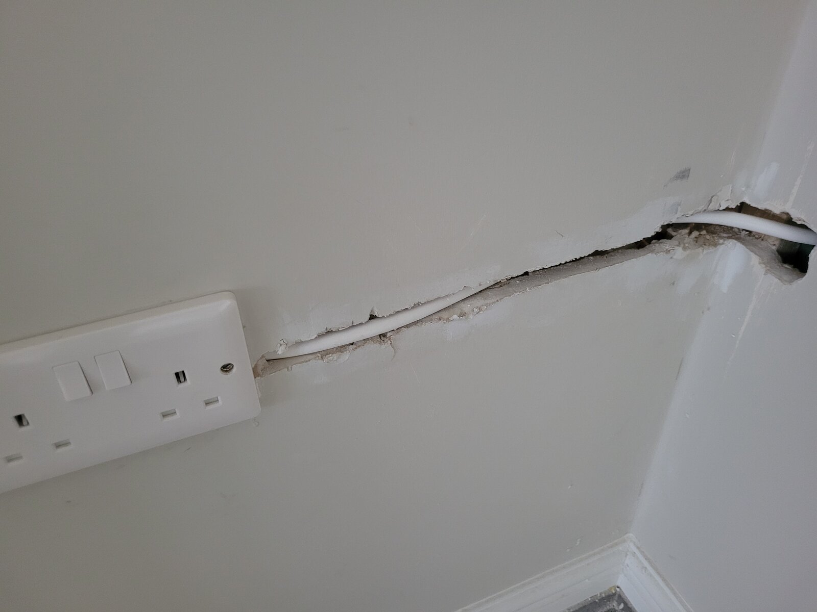

Can you please expand as I am not sure I fully understand? The feed goes to a socket that was in a conservatory that, after the removal of the conservatory, will become an outdoor socket.
Add a box to the right of the existing one, your cut-off cable will then be long enough to enter that one. Then add a double pole fused spur, to the new box, fed from your working socket. That new spur, has two advantages...
1. If your outside socket developed an issue, water ingress etc., and began tripping the circuit, you have an easy method of isolating.
2. You can turn it off when not using it, to prevent anyone stealing your power.
3. (did I say two?) it resolves your cut short cable problem.
Why a fused spur? Why not a double pole switch?
Ended up like this.
Use round twin and earth cable rather than flat though (the round cable I had lying around had all the 3 wires readily sleeved) so will now need like 4 cable ties, 2 for the angle and 2 for closer to the socket where the cable protrudes (there is wood behind)

Ended up like this. ...... Use round twin and earth cable rather than flat though (the round cable I had lying around had all the 3 wires readily sleeved) ....
I presume that you are referring to flexible cable ('flex'), rather than what is usually understood by "twin an earth"?
